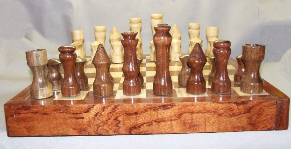

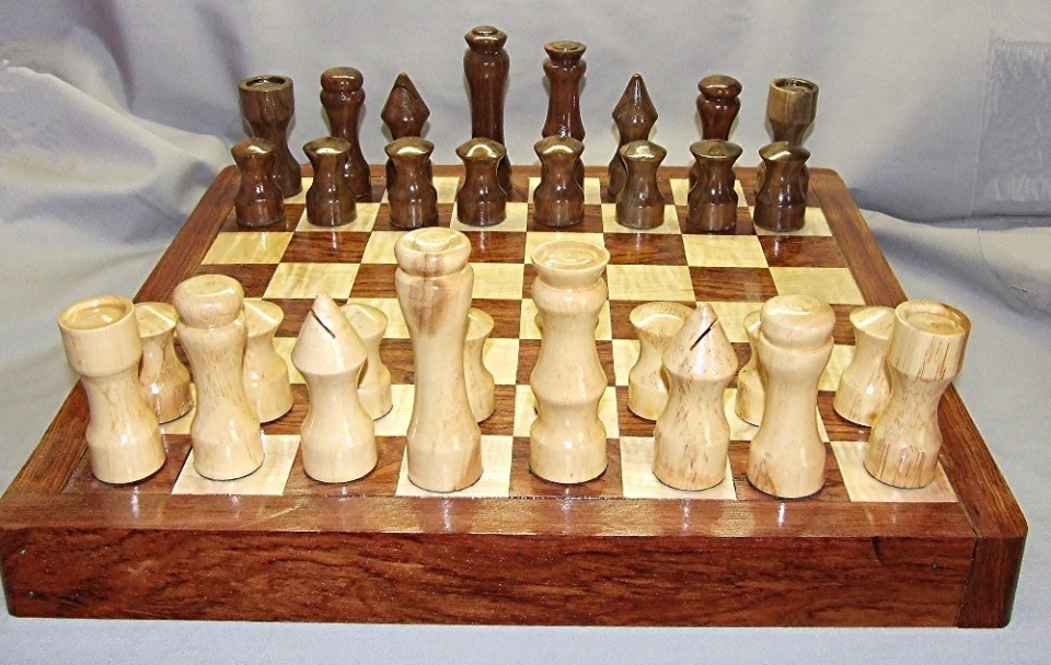

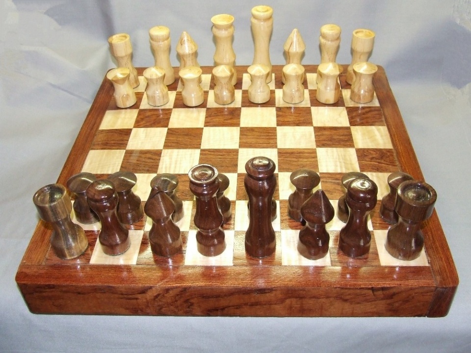

I've done this one... haven't actually finished it as I have a small box to fit under the board like a pedestal that I need to flock and attach to the board. The box will hold the pieces.
The paws are about 1 1/2 inch high with the noblemen being about 2 to 2.5 and the queen is about 3" with a 4" king. I used walnut and maple for the pieces, the board is bubinga and maple and is about 14" square.
I drilled the pieces with a forstner bit the depth of cutter head on the forstner, then a 3/8" above that so the piece would fit on my pen chuck... then filled the bottom with bird shot, sealed in with wood putty and then glued felt to the bottom...

Very nice designs! Well done.
Chuck, that's a nice set! My plan was to use walnut and maple for the pieces. I found a few designs I like. I think i'll get started on the pawns this weekend. I'm not using a duplicator, so hopefully I can get them looking uniform.
