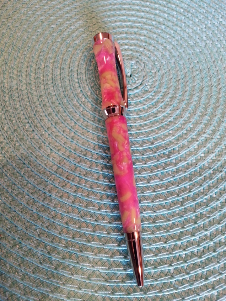

Well I used these twice today......I have to tell you, my experience is different than the others. I have never come close to this with the MM (maybe I don't know what I am doing....pen #13 remember). I turned the pen, dry sanded with 600 (experimenting with wet and dry), then hit then pen with the pads (wet). Between 4000 and 8000 the swirls disappeared. I continued through 12000, then polish and buffer. But I could tell through the 4000 and higher range that there were less visible scratches. Then I inspected the pen under my shop light, led light, and sun light. I thought I saw a scratch, but it was the pen design. I am going to try a very dark pen tomorrow and see if three is a charm. For $6.00 after the coupon, it's worth more tries (at least to me). And believe me, as a beginner, and hearing about the experience of others, I couldn't stop doubting my results. Here's the pen...but my photos stink ,and I made the barrel to narrow. The pen is top heavy (even after turning the top twice).
FWIW,
Tony
