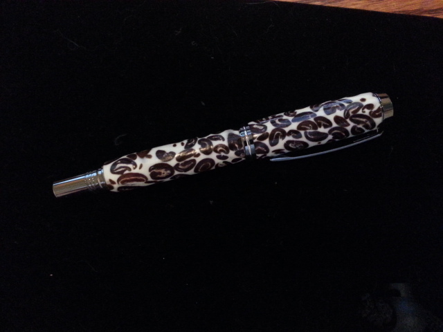

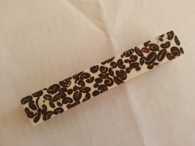

Here's a blank I have left and a pen from another one. The blank is 4-5 yrs old?? These are pressure cast in Alumilite. The beans have voids that can trap air. The air is squished as a result and Alumilite cures best under pressure, but beans are dense and filled with air. No matter what, they float. Your method sounds like it should make some sweet blanks!!
