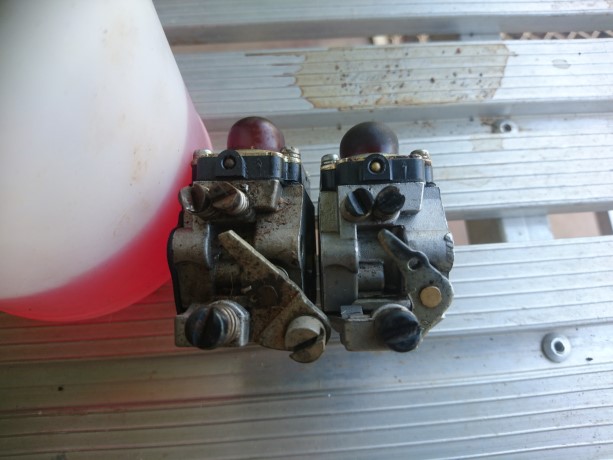

I am looking for a small engine repairer, or some one with the knowledge about Sthils.
I have a Stihl HS 74 hedge trimmer with a buggered carby.
A while ago I was given a Stihl BG 72 blower the motor worked but the plastic casing was stuffed.
They are both approx the same age.
My query is will the blower carby fit the hedge trimmer?

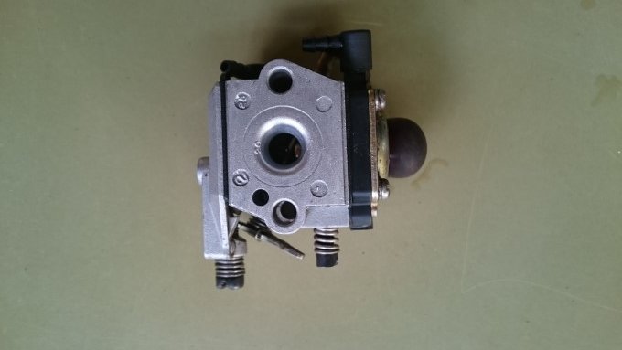

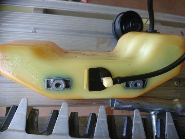

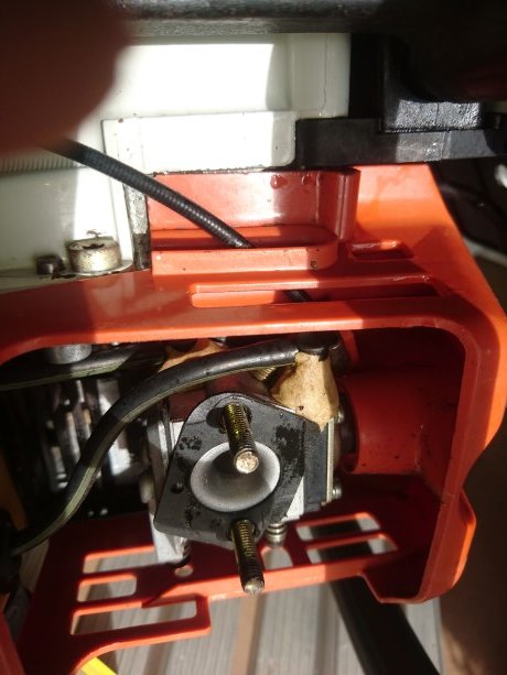

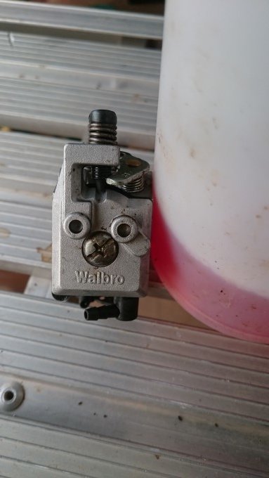

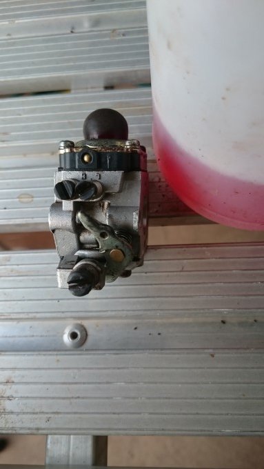

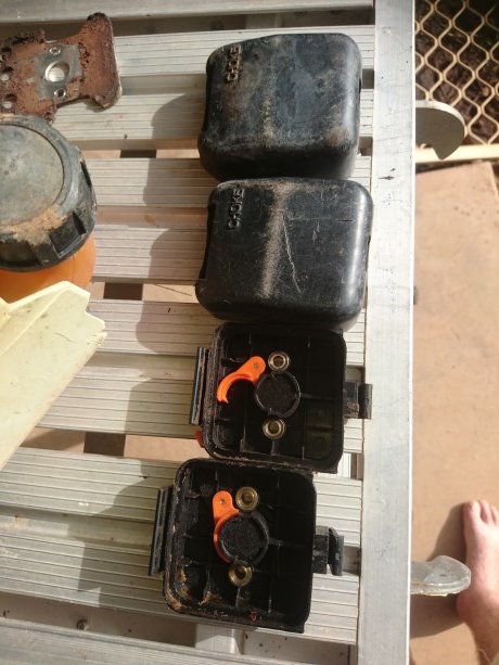

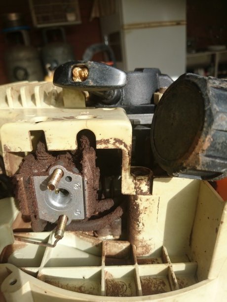

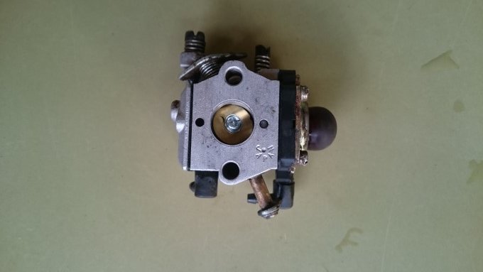

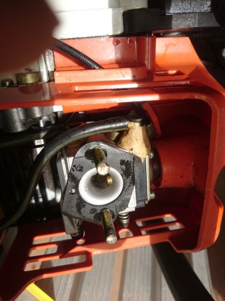

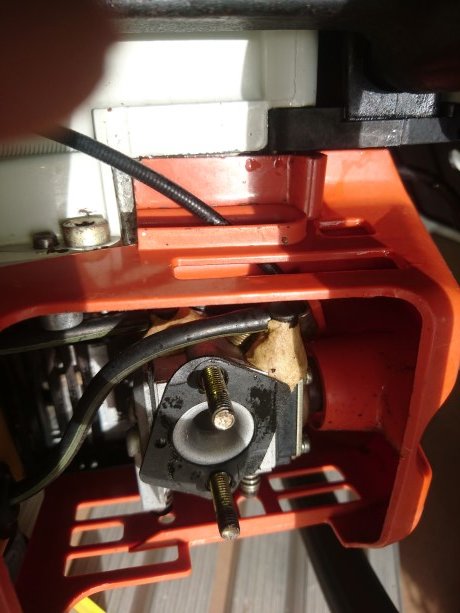

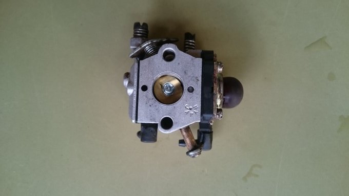

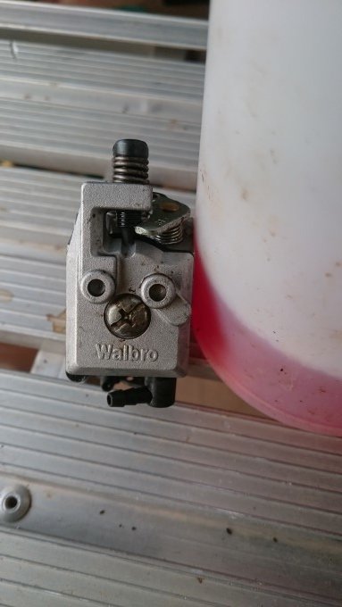

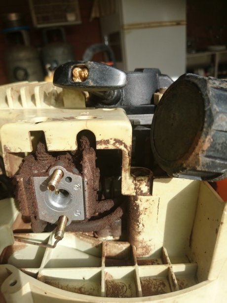

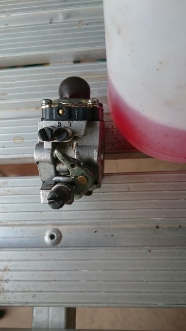

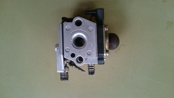

I got the hedge trimmer from work, the maintenance supervisor had taken it to the local shonk to repalce the carby.
See how he used bog where the fuel line connect to the carby (Photo 2 & 3), It leaked when went back to work, got worst as time went by, when the workshop was stunk out by fuel the supervisor condemned it. I claimed it, thinking one day I will take to a sthil dealer and get a new carby for it.

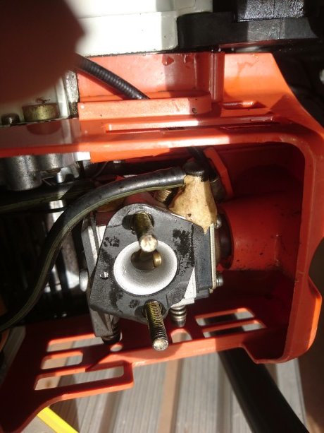

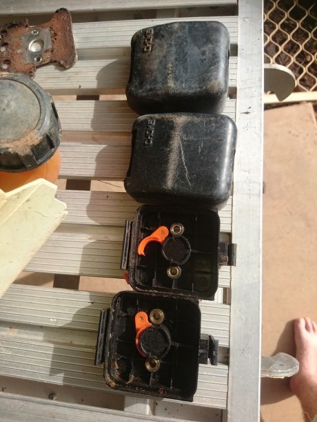

Today I went into my former chook house I saw the old blower I thought may be it will fit the hedge trimmer.

After a lot of stuffing around trying to get it to fit, I will buy a replacement carby.
Any one know what it under black plate where the fuel line goes into?
Mate, your attachments on this post are not right, check it out.
I don't think that I would invest in an OEM Sthil Carby, there many off-market carby's that will do the job for a fraction of the dollars.
Look at these guys and see if they have any replacement for what you've got
Remove the carby and look for any model or any indication as to what it is that will help you find a replacement, there are repair kits for most carby's but you need to know what you are doing with changing the needles and adjust it.

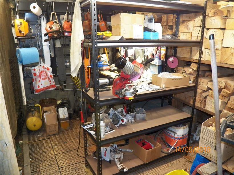

I can't tell if it fits or not but what you need is George's Chainsaw corner 031.JPG032.JPG033.JPG
to get it worked out, capish...?
Cheers
George

I agree with George about the aftermarket carbs, I just used one recently and it was a perfect fit and needed no adjustment and took less than ten minutes to change. My stihl blowers have another gas line that has a filter on it in the tank that is probably on the other side of that black thing. Hope you get it going soon if it bolts up and it looks like it will, I would give it a try and see what happens.
