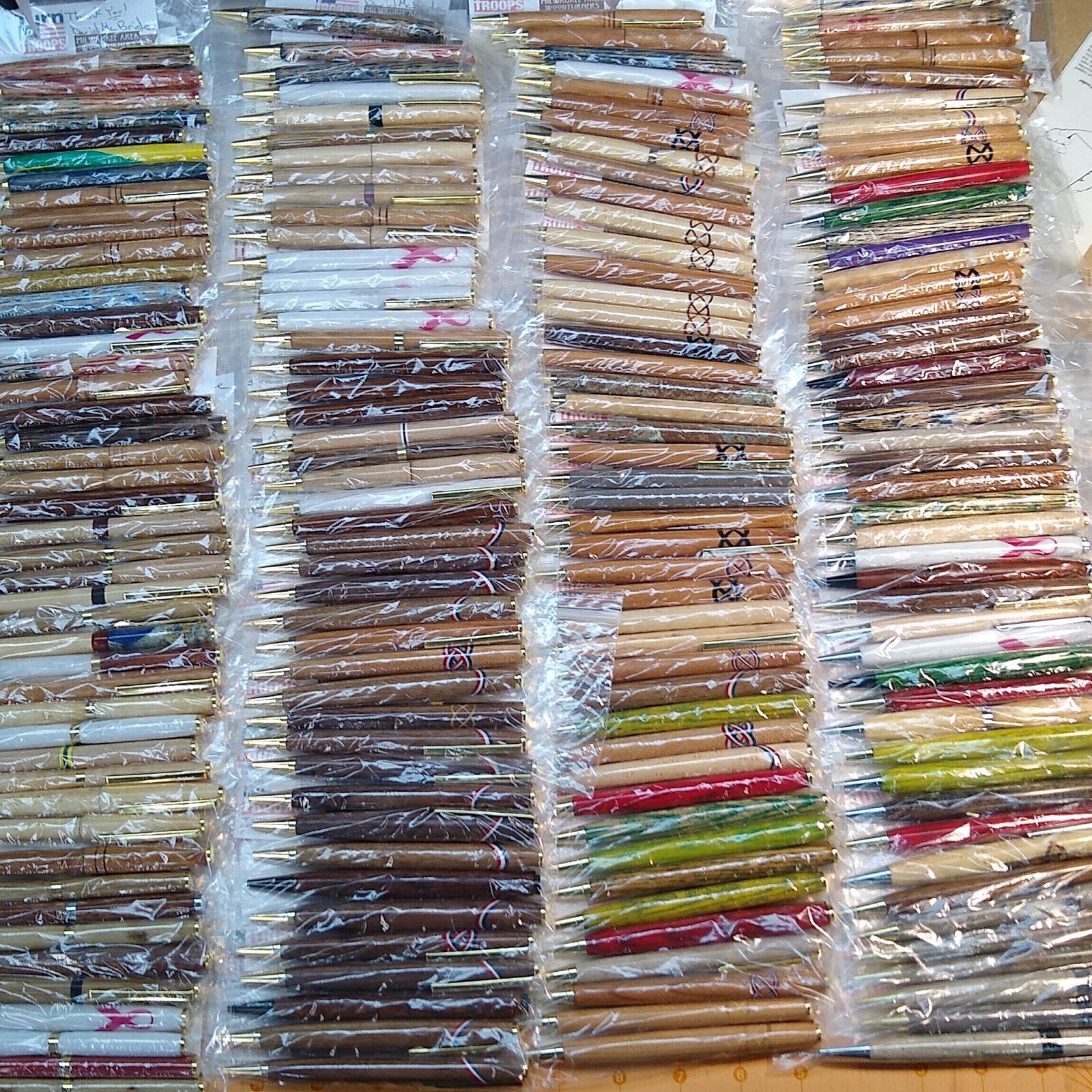

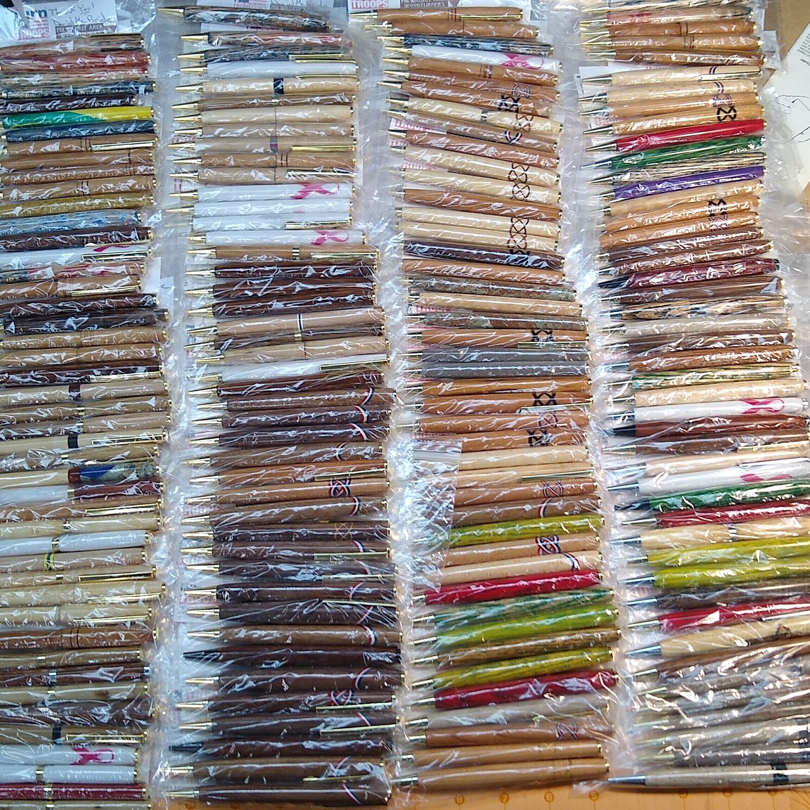

I help out with "Turn for the Troops" Pens. These photos were taken at the local Woodcraft in Harrisburg PA.
https://susquehannawoodturners.org/...e-troops-2020-at-woodcraft/dscn2038-2117.html
I made 5 pens and mentored at least a dozen people to make pens.

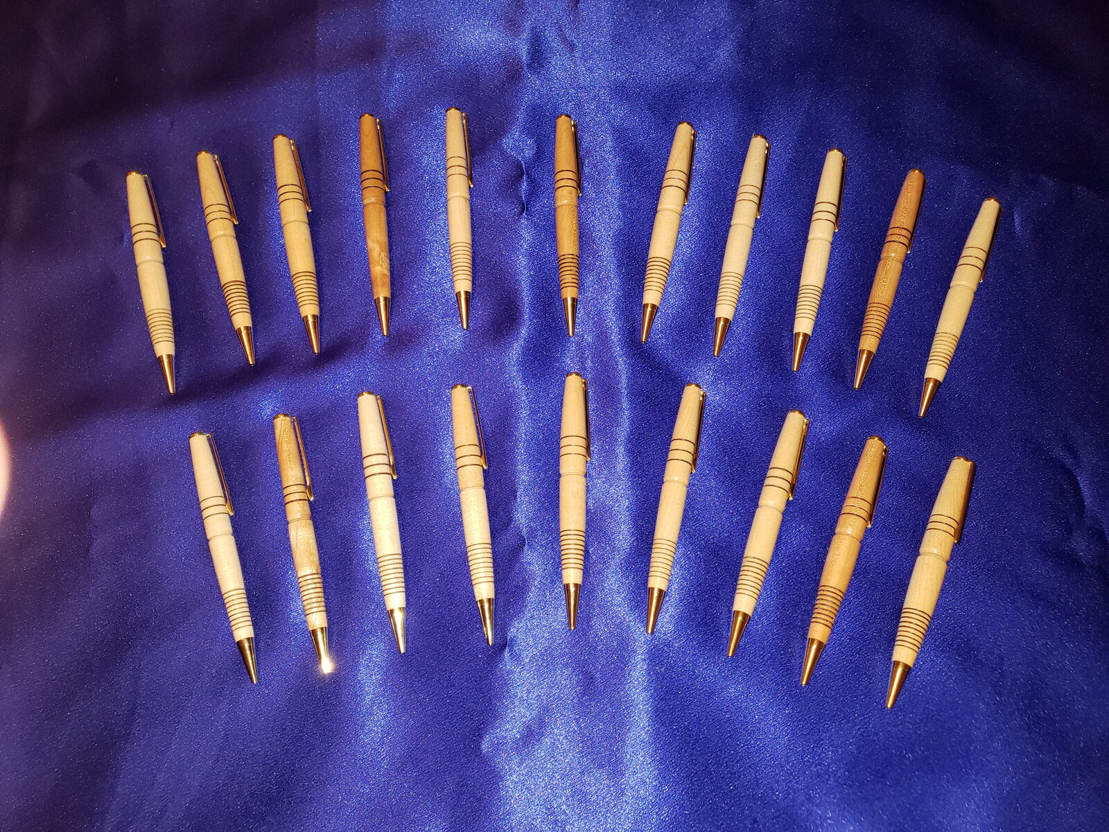

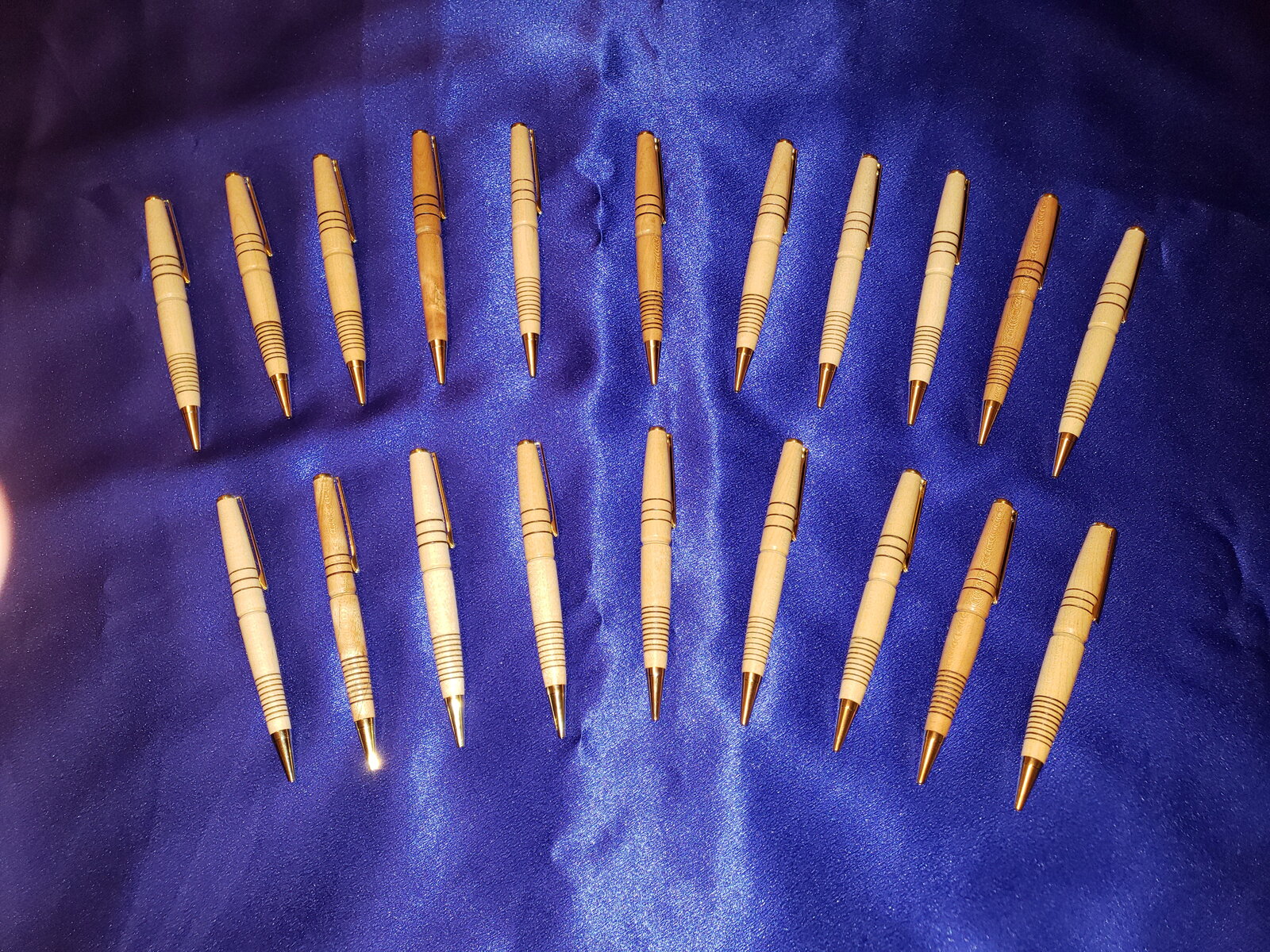

Later I thought this wasn't enough, so I made these pens in my workshop in the last two weeks.
Nice idea turning beads (?) toward the nib. I bet many of the troupes wear gloves. This may help them grip the pens.
HI Tony; It is a PSI Finger Grip Tool. It makes evenly spaced grooves. Try not to go too deep in case the wood breaks off between the grooves. I then wire burn the grooves.

Very nice work and nice gesture to give those pens to the troops !!! . Thanks for showing !!!
Randy ... what pen kit did you use for the above group of 20 pens ?
Mal; They are just slimlines. I turn them a little fat with a recess at the joint between nib and cap, and eliminate the centerband. Kind of a variation on the PSI Comfort. I thought of making click pens, but I know the ones that last are too much.
