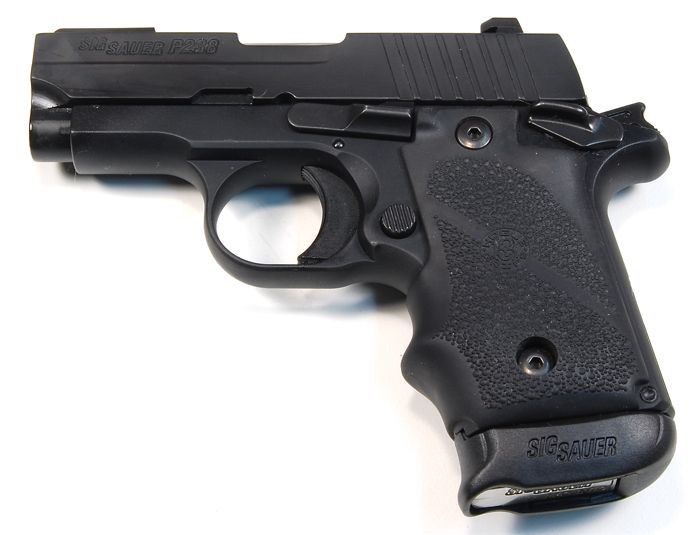

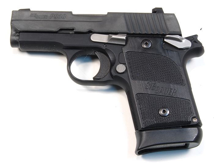

So here is the gun that started it all. The infamous Sig P938:biggrin:. Please excuse the way the slide looks, i just pulled the blues tape off that i use to mask it for the holster making, so it has white residue on it. The gun is nice and black and beautiful.

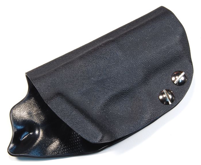

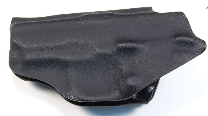

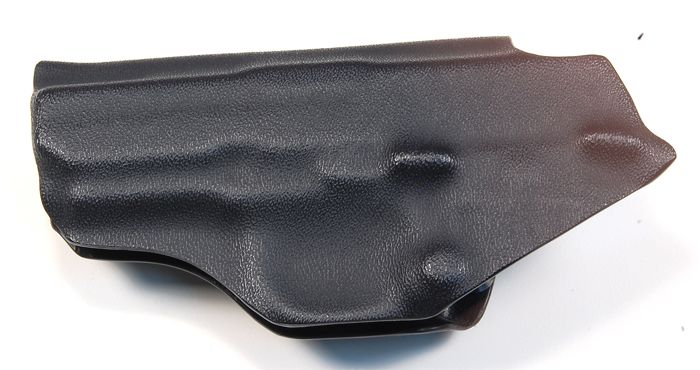

This is the first one, and i learned a lot from it. I fould i dont need the re-tension screws at the bottom and it need to be a little larger.
http://www.penturners.org/forum/attachment.php?attachmentid=78938&stc=1&d=1343415667
Other side
http://www.penturners.org/forum/attachment.php?attachmentid=78939&stc=1&d=1343415667

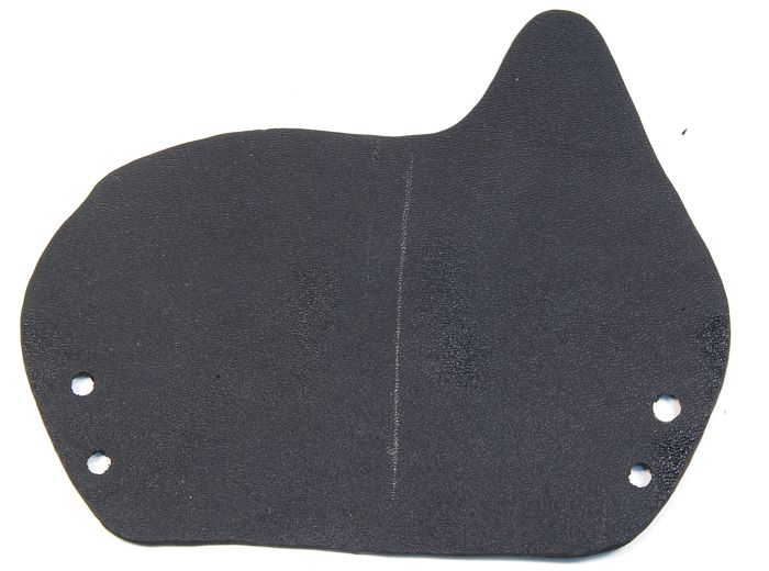

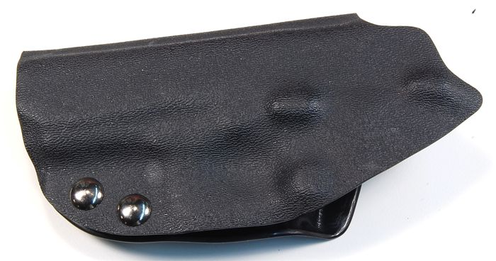

This is the second one i made. As you can see its flat. Thats the great thing about Kydex, is you can reheat it and it has memory and will return to its original flat state. It was still to small, so i flattened it out so that i could trace it and make it just a little larger:biggrin:
http://www.penturners.org/forum/attachment.php?attachmentid=78940&stc=1&d=1343415667

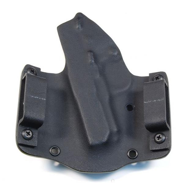

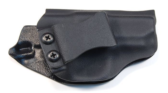

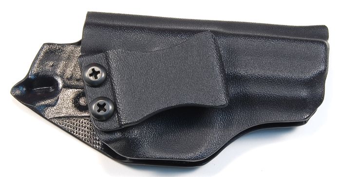

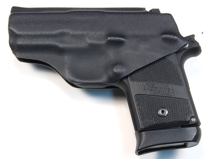

Here is the revised version, complete with clip. This is an inside the waistband holster for concealed carry. It has a 15 degree forward cant to it for ease of drawing. I am really happy with how this one turned out, i got great definition and re-tension out of it.
http://www.penturners.org/forum/attachment.php?attachmentid=78941&stc=1&d=1343415667
Other side
http://www.penturners.org/forum/attachment.php?attachmentid=78942&stc=1&d=1343415667

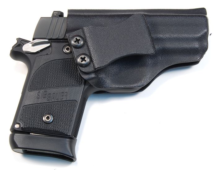

And holstered
http://www.penturners.org/forum/attachment.php?attachmentid=78943&stc=1&d=1343415667
Other side
http://www.penturners.org/forum/attachment.php?attachmentid=78944&stc=1&d=1343415667

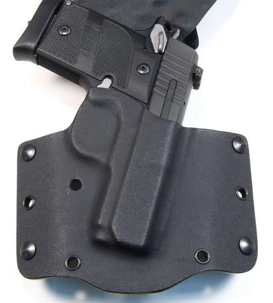

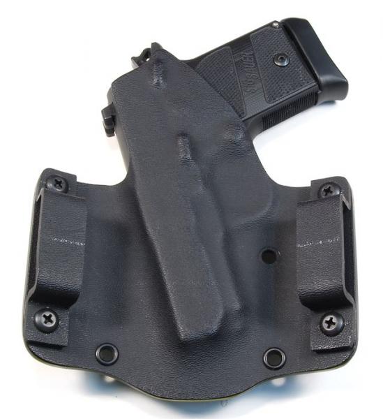

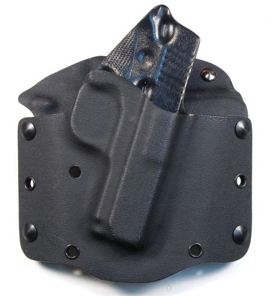

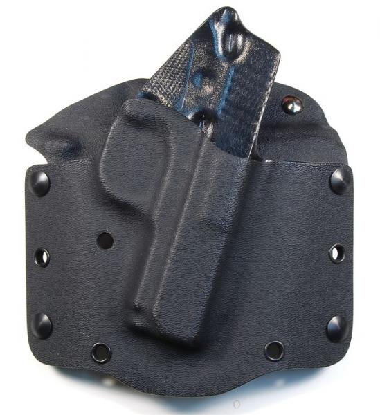

Nest is an outside the waistband holster for min 9mm. Im happy with this one and it is very comfortable. Its propped on another holster in the background.
http://www.penturners.org/forum/attachment.php?attachmentid=78948&stc=1&d=1343415667
Back side
http://www.penturners.org/forum/attachment.php?attachmentid=78949&stc=1&d=1343415667
Holstered
http://www.penturners.org/forum/attachment.php?attachmentid=78950&stc=1&d=1343415667
Back side
http://www.penturners.org/forum/attachment.php?attachmentid=78951&stc=1&d=1343415667

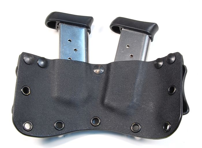

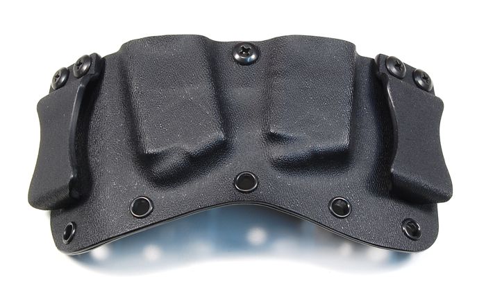

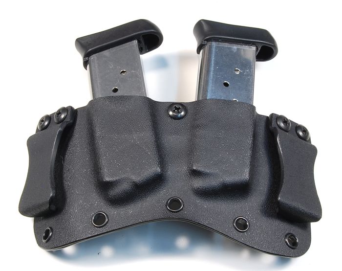

And the double mag carrier. This is for inside the waistband and huge the body really tight.
http://www.penturners.org/forum/attachment.php?attachmentid=78952&stc=1&d=1343415667
With the mags
http://www.penturners.org/forum/attachment.php?attachmentid=78953&stc=1&d=1343415667
Back side
