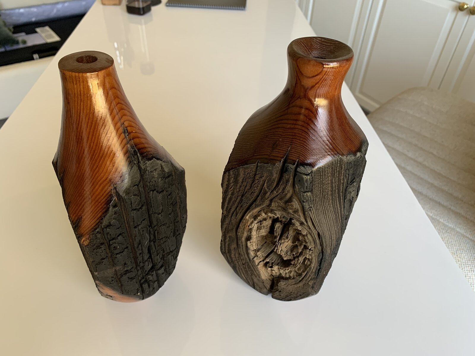

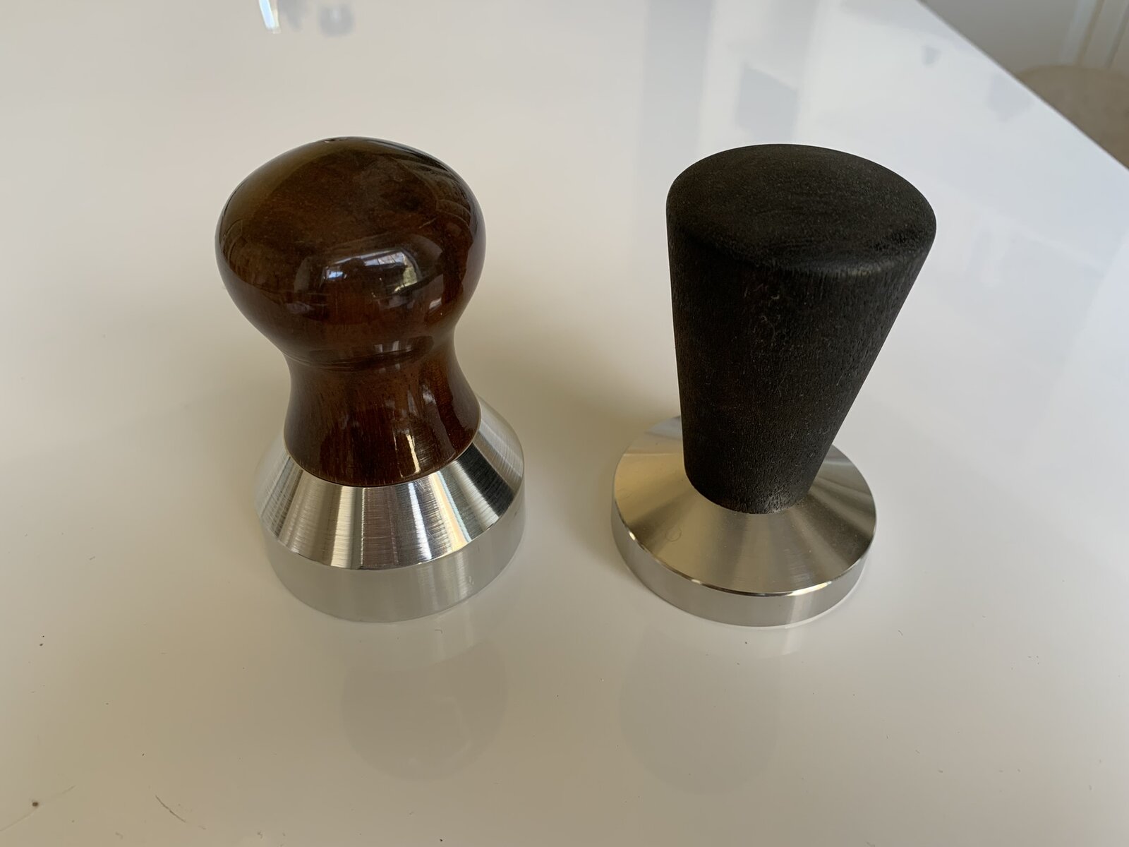

I've done both a shou sugi ban technique where you essentially burn wood and then apply boiled linseed oil finish to both finish and stabilize the wood. This technique is a common Japanese method of preserving wood. You can see that applied to the coffee tamper using mahogany wood that was burned with a torch. The other technique I've used is essentially a natural shui sugi ban finish on fence posts that were burned in the cedar Fire in San Diego. I turned the burnt posts into twig pots then used linseed oil on the burnt parts and polyurethane on the turned parts.
Not sure how this would work for pens, but might give you some ideas to try.
View attachment 355063View attachment 355062
Nice work! I like those!
