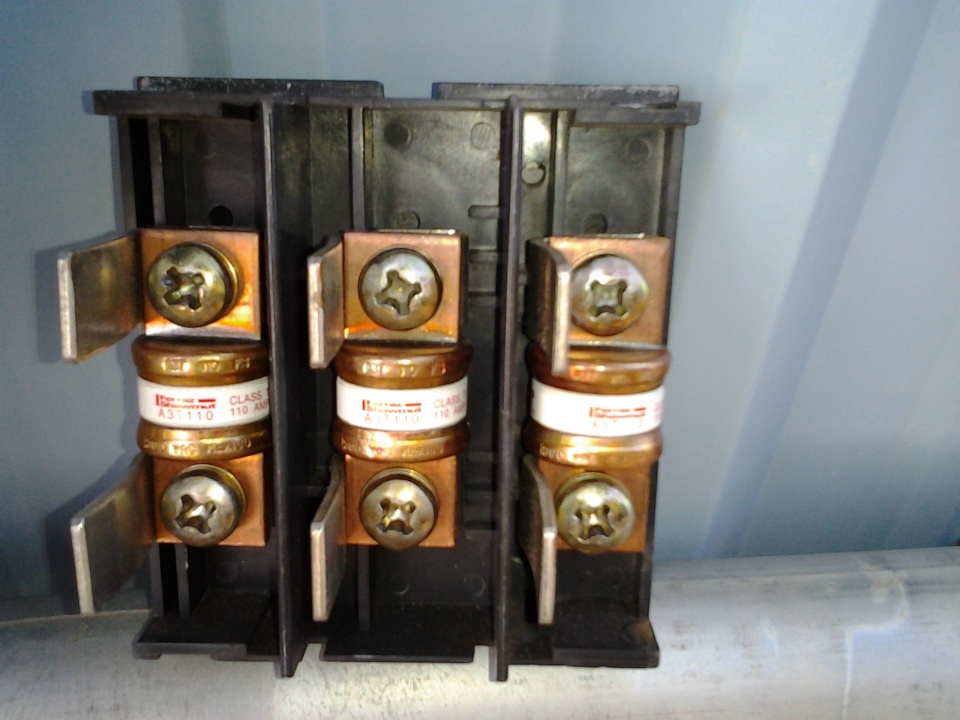

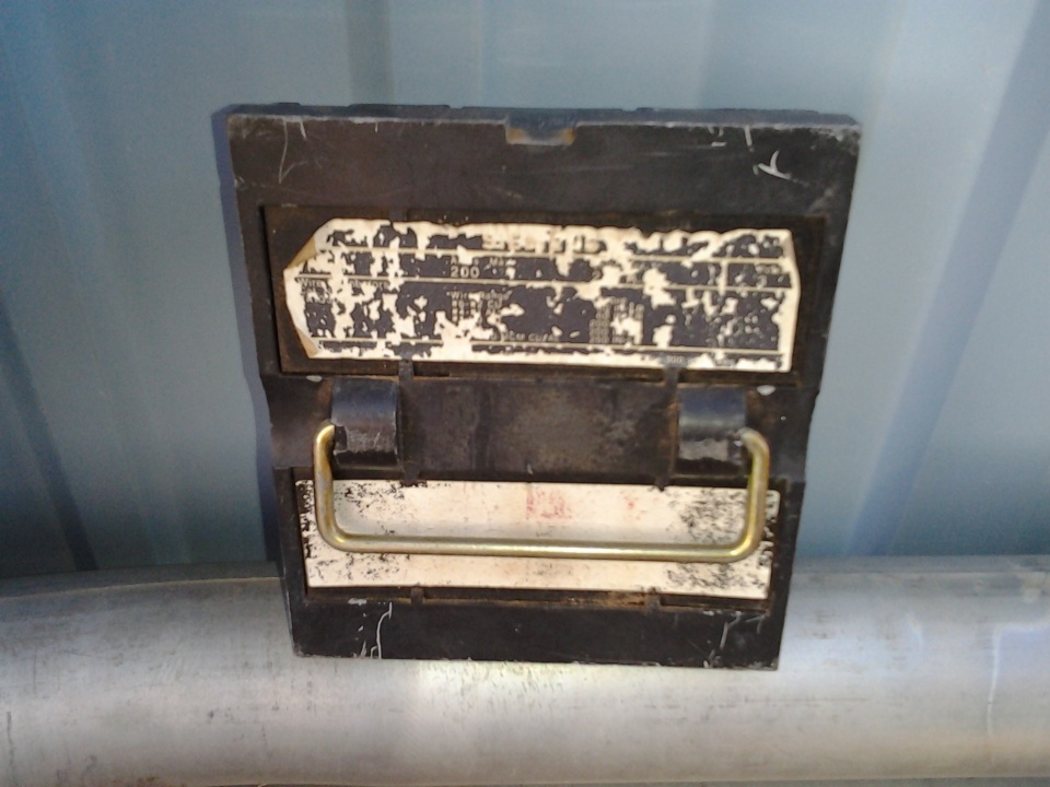

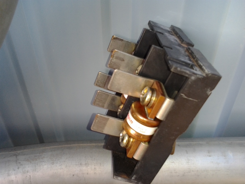

I went to fire up the electricity in one of our business rentals and found the fuse holder missing. If I find the culprit I'm gonna beat him senseless. I just need the holder not the entire unit.
Now the catch, I know the brand, the amps , but not positive on the model number.
Can someone maybe look at this and tell me what I got and tell me where to get one? Grainger does not have one I already asked them.
It is a Siemans model ?. 200 amp pull out. From my looking I think it is a model TFP324. Problem is I can't find just the part I need, and the entire unit is between 500-600 dollars, at least the ones I can find.
I took some pics of the holder from another unit if that helps. Unfortunately all my other pulls are being used and I am not able to rob Peter to pay Paul.

Thanks. I was hoping to get the part. I assume it would be much cheaper than the whole unit. What would be a fair price for that thing? Looks a little rough.
Check with some of your local electrical contractors. Alot of times they will salvage parts from service change outs or panel replacement jobs. Dave
