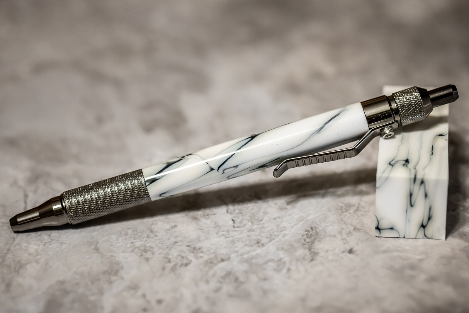

Finished another pen after acquiring some new tools and trying some new techniques recommended by you fine people! I turned this between two simple cone centers...a basic 60 degree dead center and a standard 60 degree live center. Put the bushings in the tubes, that between centers, and WOW. Most stable turning I've ever had! Things were so much quieter...no vibration, no noise...it was wonderful! Thank you all for your tips!
An Anvil EDC kit this time, with a White Marble poly blank. The blank was interesting...had some chipout at first, and it almost feels a little chalky, but once I got the hang of it turning with a negative rake EWT finisher with some lighter pressure, I got these wonderful continuous streams of poly.

I don't have a light tent or proper lighting yet, so harsh shadows and harsh highlights. One of the few light colored, brighter pens I've turned, and I like it so far. I really like this kit, too!

Very nice matching the marbling with the gun metal kit. A very attractive pen and nice work on the turning and finishing. All around a winner!

Very nice. I like the kit as well, but so far have gone the route of the DuraClick EDC simply because I like the little machined in rings detail on the nib. I was also surprised that the blank was not TruStone as it certainly looks like marble. - Dave

Very much like the "industrial" character of that kit, had not seen it before so thanks for sharing.
Your photography is excellent, nice crisp resolution & contrast - in my opinion you don't really need the light tent.

Where did you get that blank, WoodRiver?
Yes, found it at the local Woodcraft. They have some pretty nice blanks, I have to say. It is not TruStone, but it still looks pretty good. The key difference in look I think, is the way the veins stain the "stone"...which I don't think you would have if you used a TruStone blank (along with a much lighter wallet! I think this blank was around six bucks.)

You've done a good job on that pen, Jon.
I'm not a big acrylic fan, but I like your pen.
Alan
Nice pen. Fit looks great. Great photo!
Very nice combination and well-executed....
Agreed, I am fairly surprised at how well the blank turned out. It is no TruStone, but it looks pretty darn good nevertheless.
Aye, love the industrial/technical look of these kinds of pens.
Thank you about the photography. I've been doing photography, although mostly nature...landscapes, wildlife and birds, nature macro, etc. for almost 15 years. I haven't done much still life type stuff yet, though, so its another new journey! ;) The camera is doing a LOT of the work here...I picked up a Canon R5 when my Canon 5D III died a few weeks back, and....WOW. Cameras have come a LONG way since 2012! This photo was in fact shot at ISO 6400...blows my mind! A light tent is on the way...along with some diffuse lighting setups...looking forward to seeing what I can do once those arrive. Still, the camera is doing so much of the work here.
