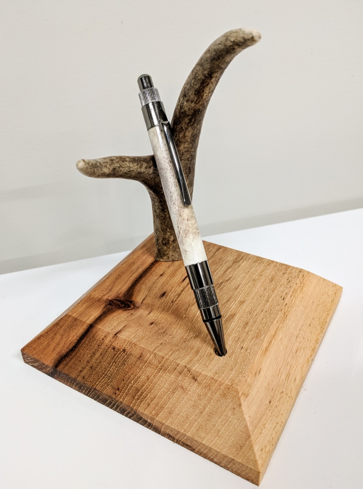

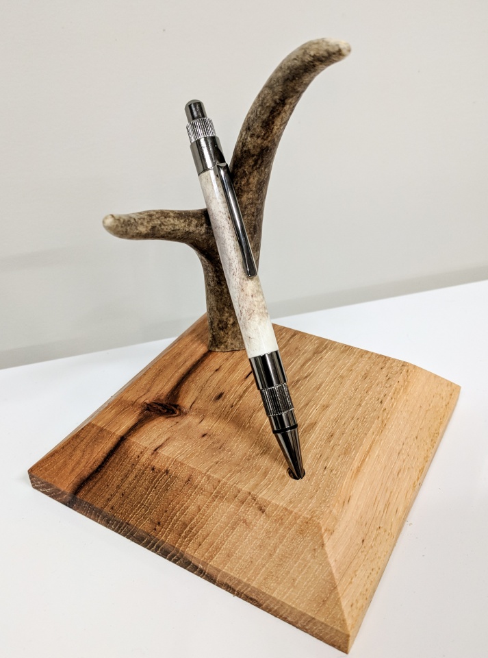

I've been pondering how to make a deer antler single pen stand for a while. Finally took some time to try something out. Trick was getting the antler to mount flush, here is how I did it:
1. Rough cut the antler
2. drilled a 3/8" hole in the antler using a cordless
3. Glued dowel in antler with excess length
4. Mounted in a collet Chuck and turned the antler square to the dowel
5. Trimmed the dowel down and glued in the wood block
The wood work was pretty simple, just a piece of scrap pecan hickory.
The pen is a Stratus, also with deer antler.
Made this for a coworker that supplies me with antler. It is for a bow hunter, so he didn't want a bolt action. He told me to make something that I thought he'd like -- hopefully this works for him, wouldn't mind keeping the antler coming.

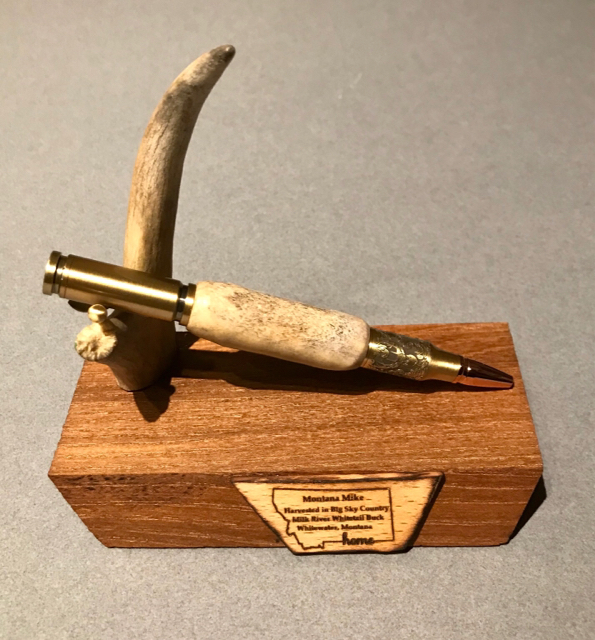

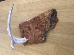

After seeing Sam's stand I thought I would make one using his idea(with his permission).
I had made a bolt action pen with antler for a friend's wife to give him at Christmas. When he told me how much he liked it I thought a stand be appropriate.
I used an antler that the dog had dragged up and a piece of Mesquite Burl I had laying around. Finished with 2 coats of Tung Oil, buffed with White Diamond.
Thanks Sam for the idea and permission to copy.
Jerry
That looks awesome Jerry! Well done, I'm sure your friend will love it. The mesquite burl you picked is fantastic, wish I had a bunch of that "laying around"! :)

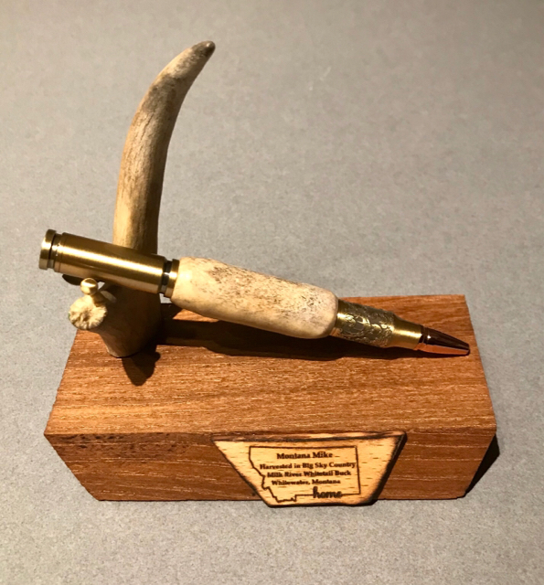

I had to mage an individualized encasement fir the lathe with vacuum, outside the shop, flew through numerous N95 masks, and eventually with a laser label I was happy but I do not plan to work with antler again due to the smell making me nauseated. The customer wanted it rough looking like it was never on the lathe, no finishing. I desperately wanted to coat it in CA to prevent some eventual cracking! IMG_4478.jpg
