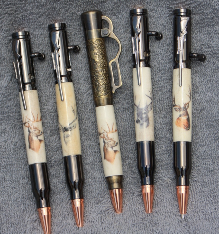

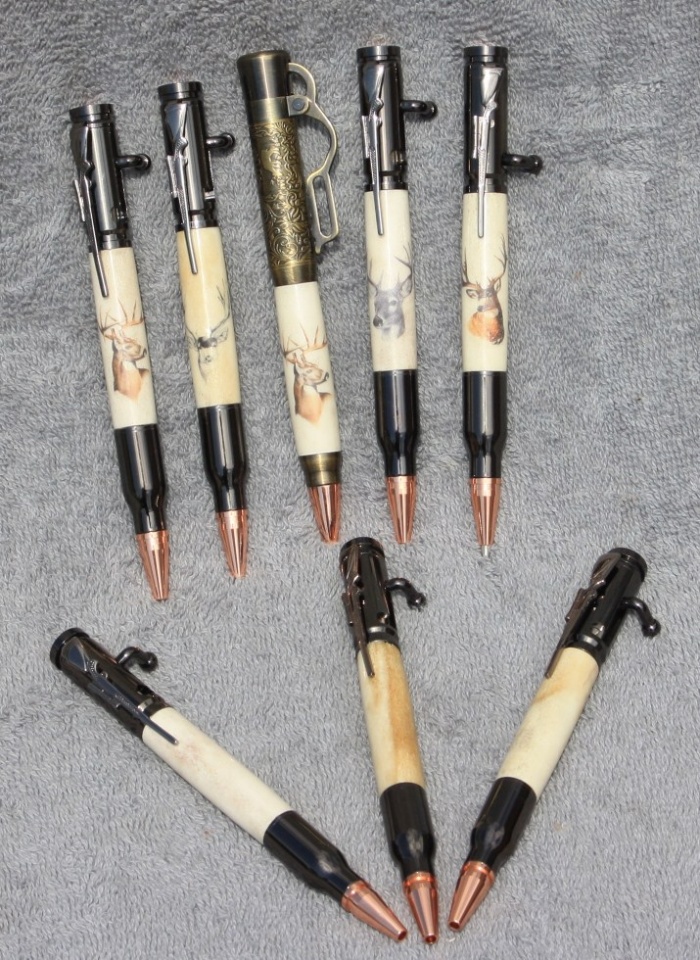

A group of Antler pens I did for a show this past weekend. I'm trying some new decals. Let me know which ones you like or don't like. Always interested in comments or ways I can improve. All Deer Antler and CA finish. Thanks,
Rodney

Now all you need are "lions, tigers, and bears" Oh My.
Oh and those are some fine looking pens too.
Curt
Really nice group of pens. :biggrin: Are those bullet nibs fluted?? Where did you get those?
Rod
Brian,
I make my own decals. I use a Inkjet printer and water slide decals. I finish the Antler with CA, polish with Micromesh apply the decal then put more CA over the decal and polish again.
Rodney
Brian,
Rodney
