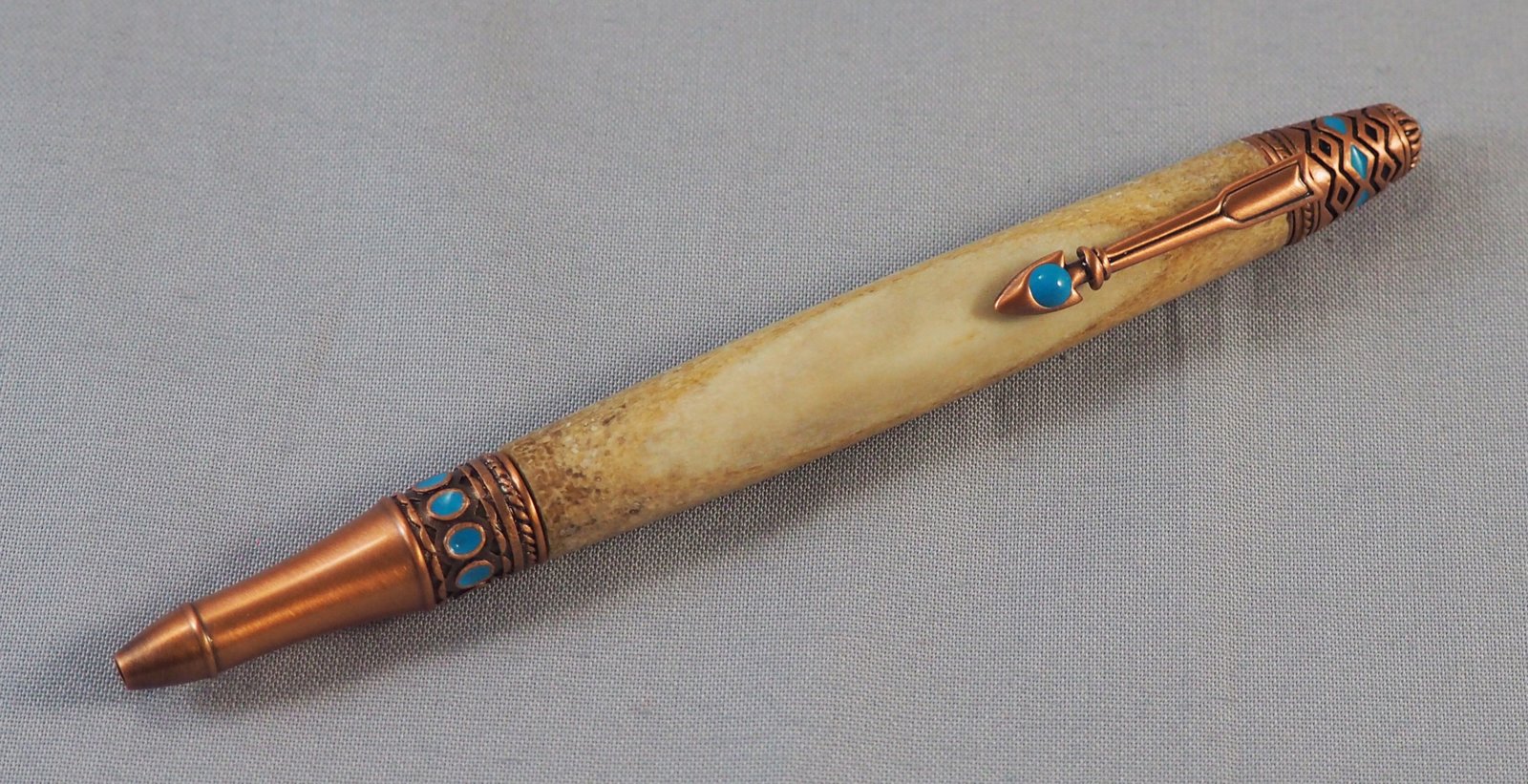

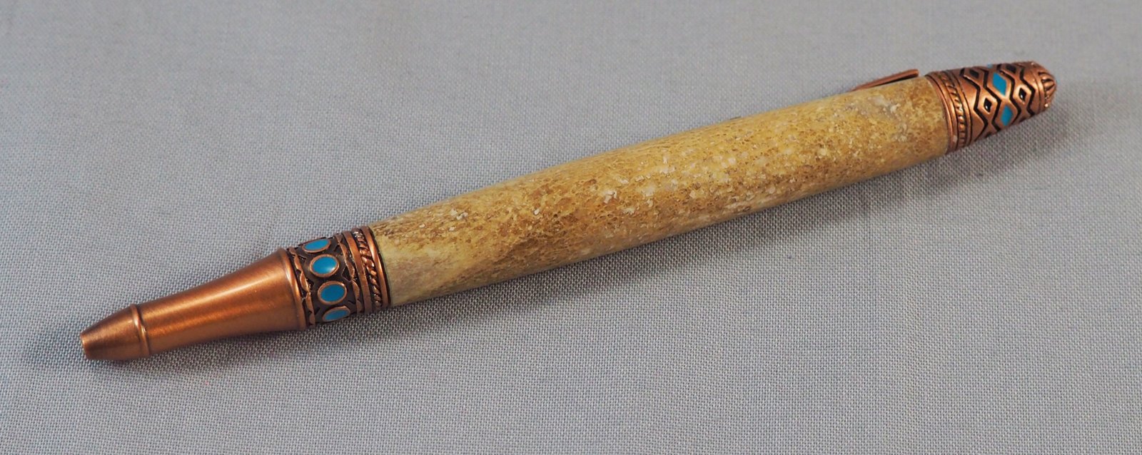

I have not turned any antler for awhile and decided to do a few today. I wanted to try to do an antler on the Southwest Mesa Pen Kit. The longer tube required the use of a thicker piece of antler so that I would not drill through the side. This in turn meant that there would be more pith showing. I did a slurry sanding to fill the voids with glue and antler dust. One side of the barrel looks really nice while the other side not so much. Despite the voids, I like the antler on the Southwest Mesa.

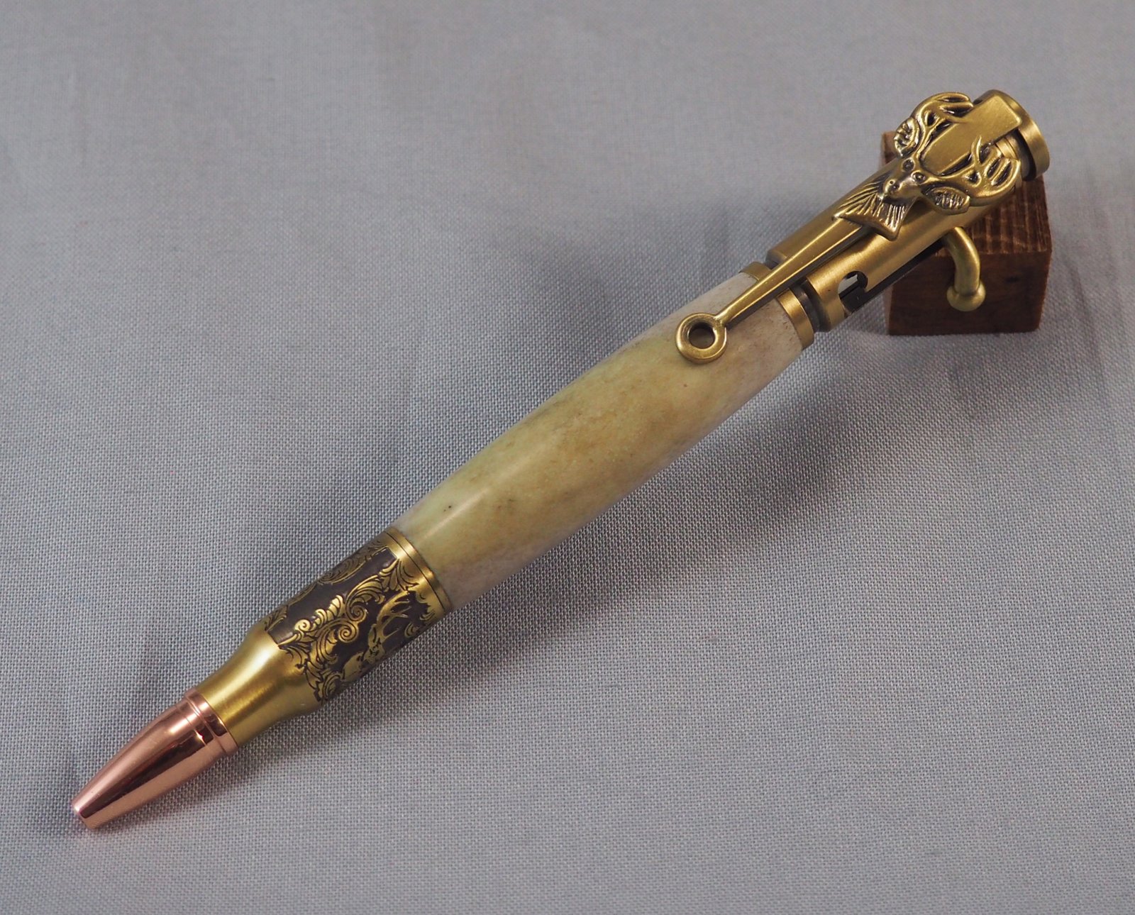

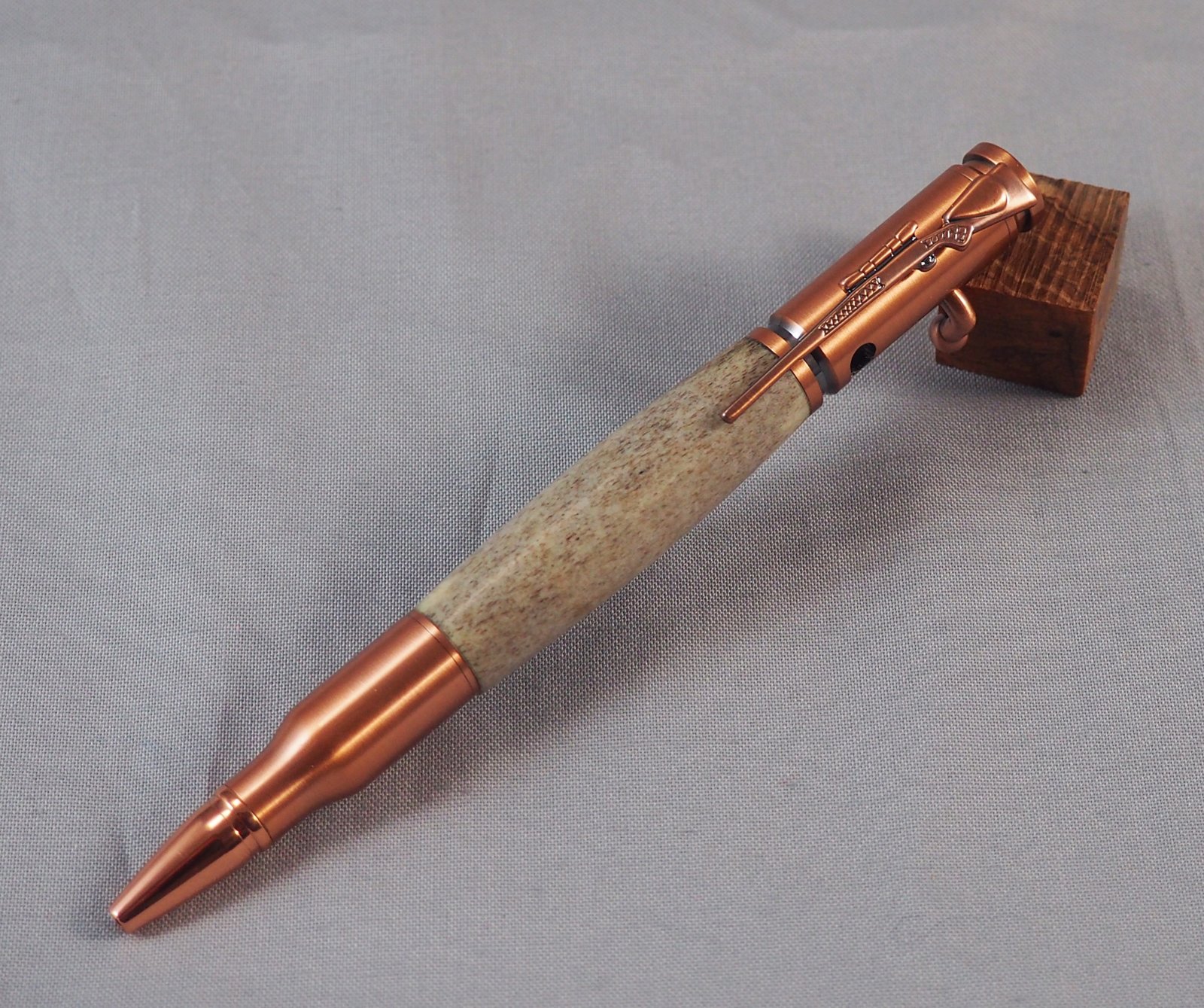

I also did a deer hunter and a copper colored bolt action.

They look good Cody. Thats the nice thing about antler though, no matter how they turn, they all still have that nice natural look. No denying that it's real.

Excellent job on these Cody! Good call on the glue/dust slurry.
I am usually not a fan of most of the themed pens but, the Southwest Mesa stands out. The hardware compliments the blank without overwhelming it.
The deer hunter: The hardware is screaming "Look at Me" and the blank gets lost in the clutter.
I am not a fan of the Deer Hunter kit either, the face of the deer looks wonky to me. I like the Southwest Mesa pen it has a nice feel to it as well. I think you have to be careful in pairing blanks to that kit however, a number of blanks will clash with it.
