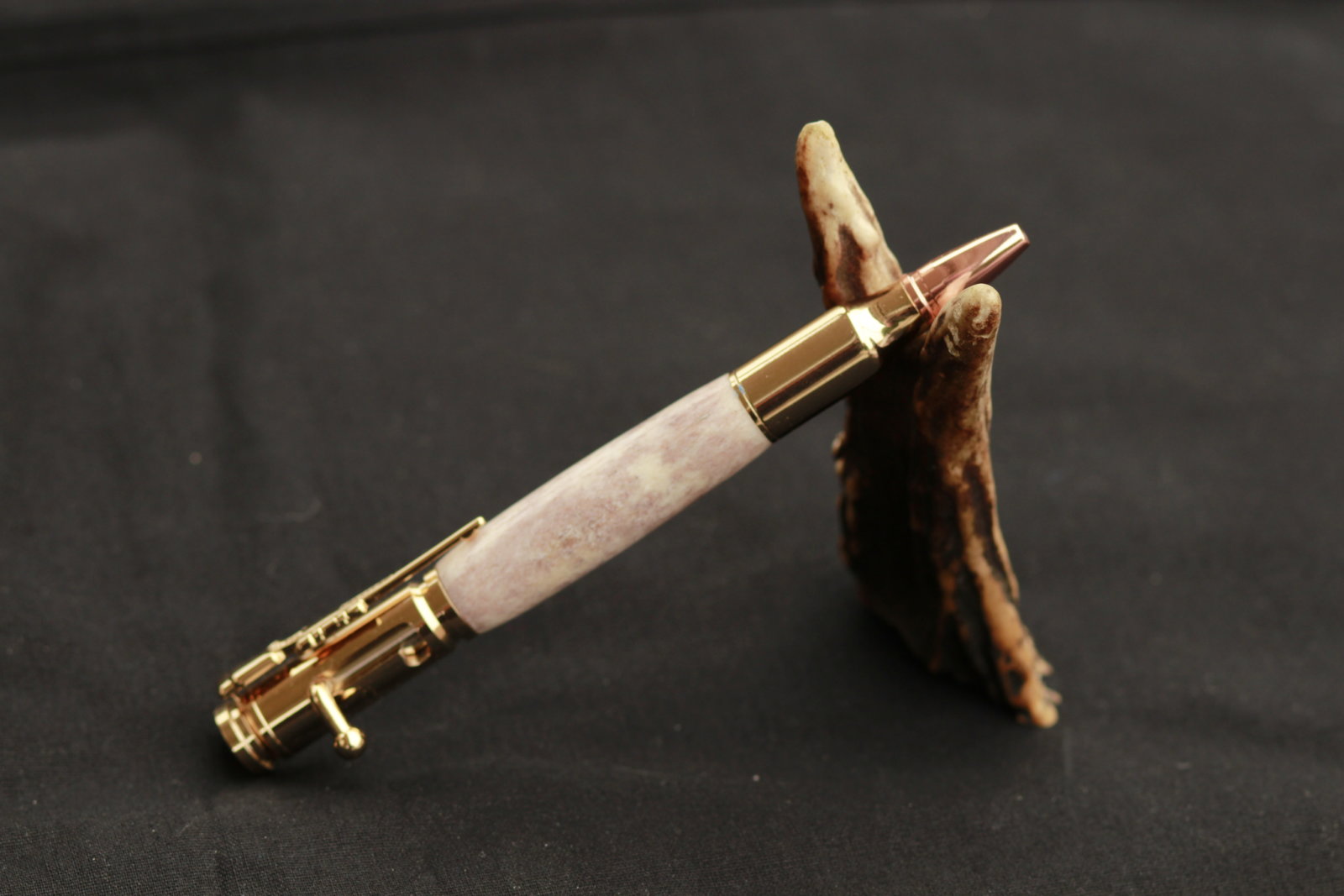

My first try at antler yesterday. Used my square carbide for roughing and 1/2" skew for finish work.
Let me know your thoughts, always open to comments and critiques.

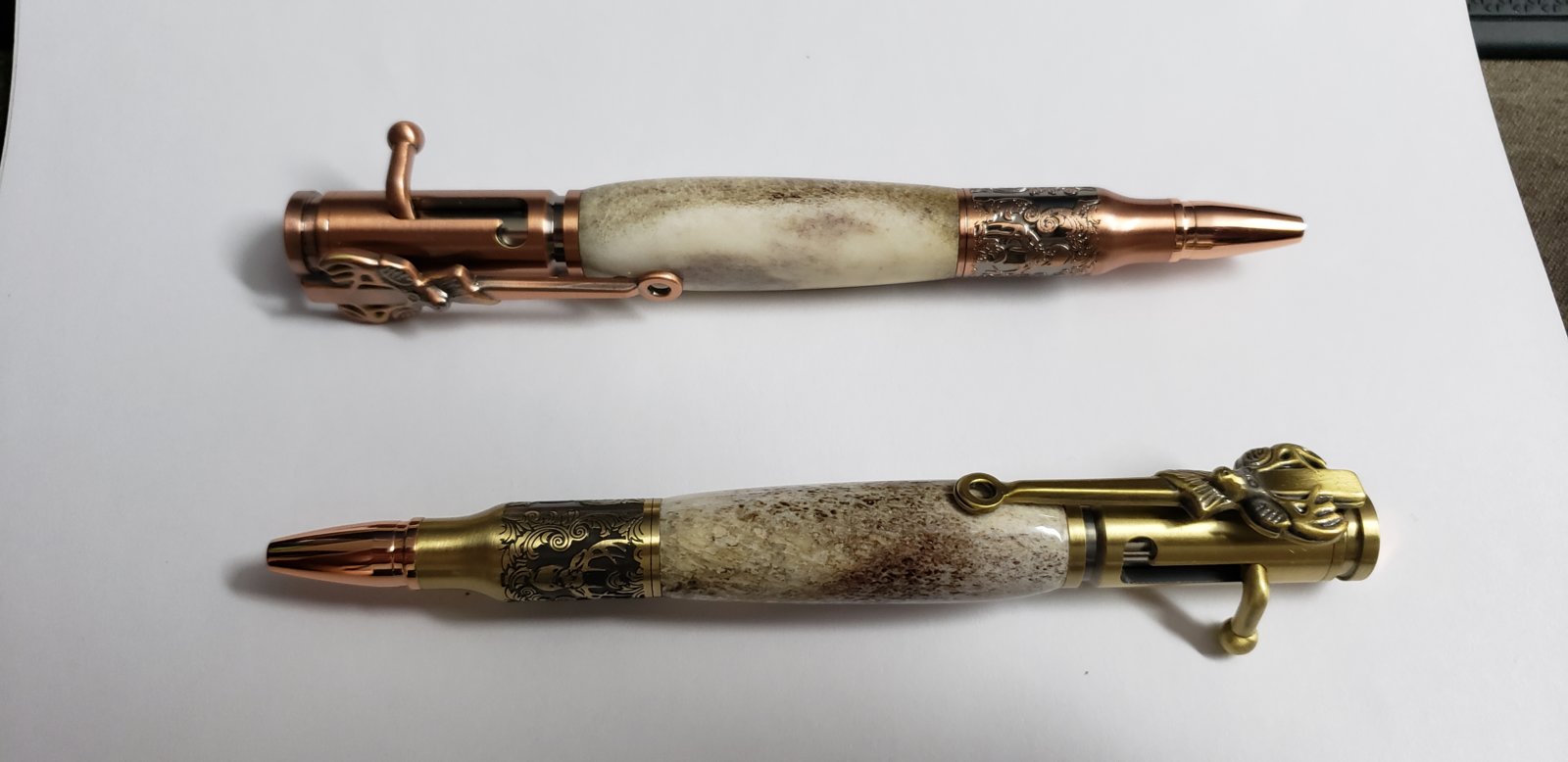

Looks good. Only suggestion is to turn the lever and clip around so it looks like this.

Is there a way to turn it around after they are assembled? I was looking at the instructions and it looks like I have to take it apart to do that.
Unscrew the nib and push the lever toward the front. You should be able to reach the screw with a long small phillips screw driver. You do not need to unscrew the screw, just loosen it until you can twist the lever around the opposite direction.
I did a bolt action once and noticed that the bolt interfered with the clip. Recently, discovered there are two notches for the clip! This was a Woodcraft kit.
