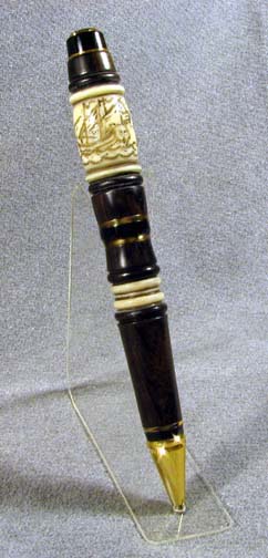

I have tried tea and found it a little weak for the look I wanted (scrimshaw) so I ended up using black liquid water color. I actually painted it in the low spots and wiped it off before it dried. The areas I wanted very white I just buffed. I'll try to load a picture of one of the pens (an ugly pen)I did using this method. I guess you could use anything, depending on the look you want and whether you'll put a finish coat on it or not.
