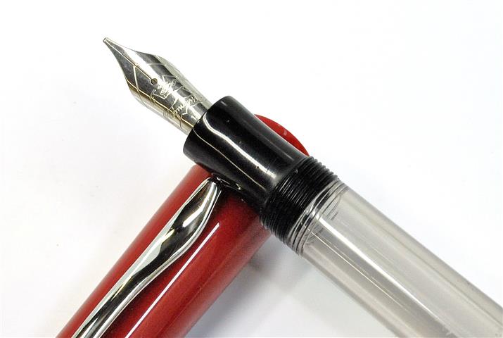

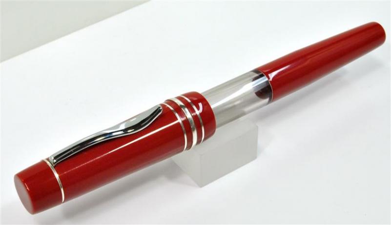

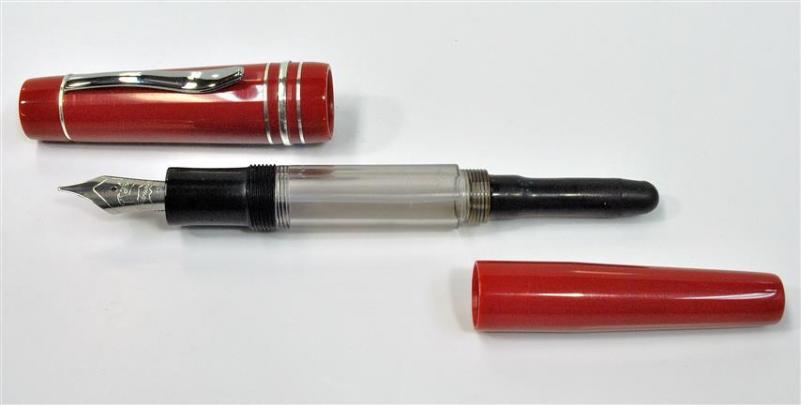

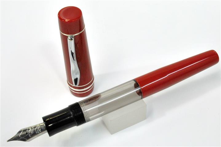

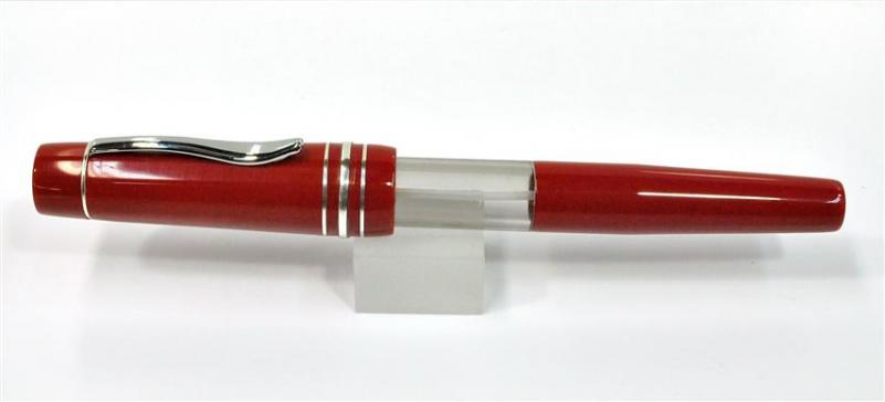

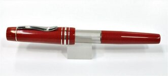

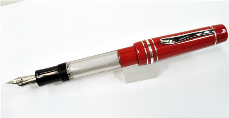

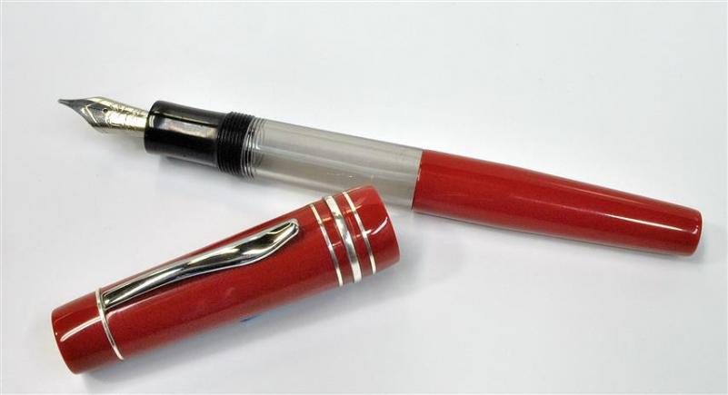

I made a black pen just like this about a month ago. Another customer, from Australia, decided she wanted one in red with a gray ink window. The bands are sterling silver; the nib is a Bock 1.1 smooth italic; and it's a bulb filler.
Length capped 6" (152 mm)
length uncapped 5 5/8"(142 mm)
Length posted 6 1/2" (163 mm)
Cap diameter 17.9 mm
Barrel diameter 13.5 mm
Section diameter at nib 12.3; at the ink window 13.7
Weight 25 gm
Ink capacity 2.6 ml

the customer is always right most of the time. But that is not my favorite that you have done. I do like the threading that goes up into the grey portion, thats neat looking. I am still aspiring to get to the level of fit and finish you have on pens such as those. Your workmanship is one of my favorites on the IAP.
Yet another nice pen Robert. I'll have to slow down, and try the window feature sometime. I like the short sections on your pens. Well done.
Sweet! I love the clear section in the middle, and that's a beautiful shade of red for the body.
I wonder what color of ink would look best in it... :rolleyes:
Really beautiful and well made. Not only do I like the three bands, I like that you made them different widths to add a bit more depth of design. Well done.
