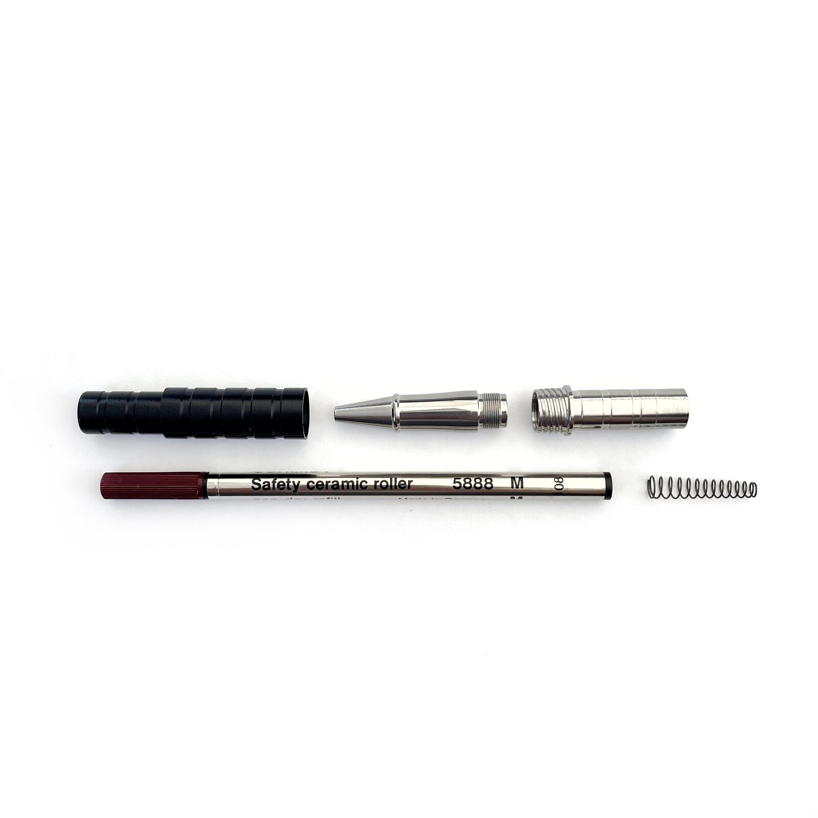

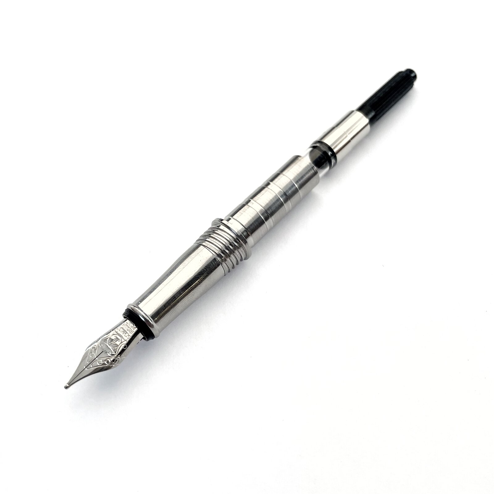

I thought it might be worth a post... We're now producing the Apollo kits for Bullseye Turning. These kits provide the threaded bits for making closed end rollerball and fountain pens that look like fully custom pens. With a little creativity the sky is the limit with these and it eliminates the need for costly dies and taps. Previously they were being made overseas but we took on the task of making them here in the US and made a few improvements while we were at it. The new ones will have ACME triple start threading on the cap to body threads and predrilled air holes in the plastic cap insert. Stainless steel have been shipped and we're working on brass now.
You'll need the mandrels they sell and a collet chuck for best results. These are kind of the gateway to full custom pen making or as some call it, kitless. :) Big thanks to Kate for trusting us to make her product and very excited to have yet another US made option out there!
You can find the "Neos Apollo" here: https://bullseyeturningsupply.com/collections/pen-components/products/apollo-neos-pen-kit

Guessing you can tell I made a few myself... lol But yes, there are new mandrels. The triple start ones are a bit tight (we opted not to tumble them but if you find they are TOO tight we may have to change that) You should have gotten an email from Kate with a coupon code for a discount on the mandrels. If you didn't, just reach out to her and I'm sure she'll take care of you. We're making them exclusively for Bullseye so that'll be who to reach out to for any purchasing info.

But yes, I drilled out the cap on every one I made because if you drill to spec it basically acts like a piston and you get air behind it. The 4 turns to put the cap on has been reduced to basically a half turn. We did change nibs to Schmidt and the rollerball is now the 5888 Ceramic roller from Schmidt as well. We've got a direct account there so that was part of not having to really up charge much for being US made and honestly I think Schmidt makes a great nib. It's not one of the big 2 that everyone knows, but they put out a very consistent product that writes well.
