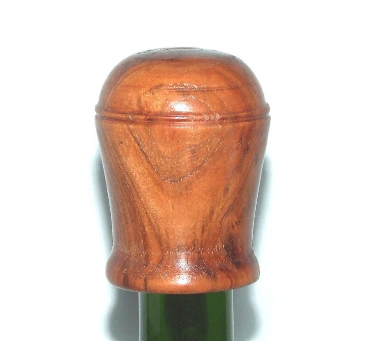

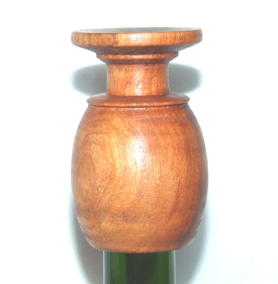

You mean like this:
These always seemed to sell well... guess I need to do a few more.
