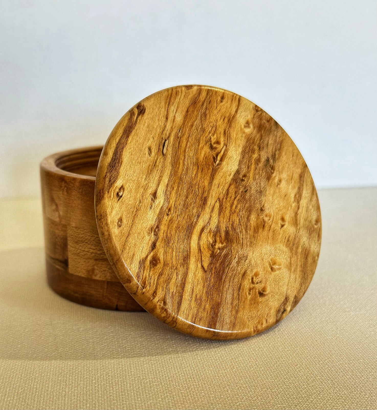

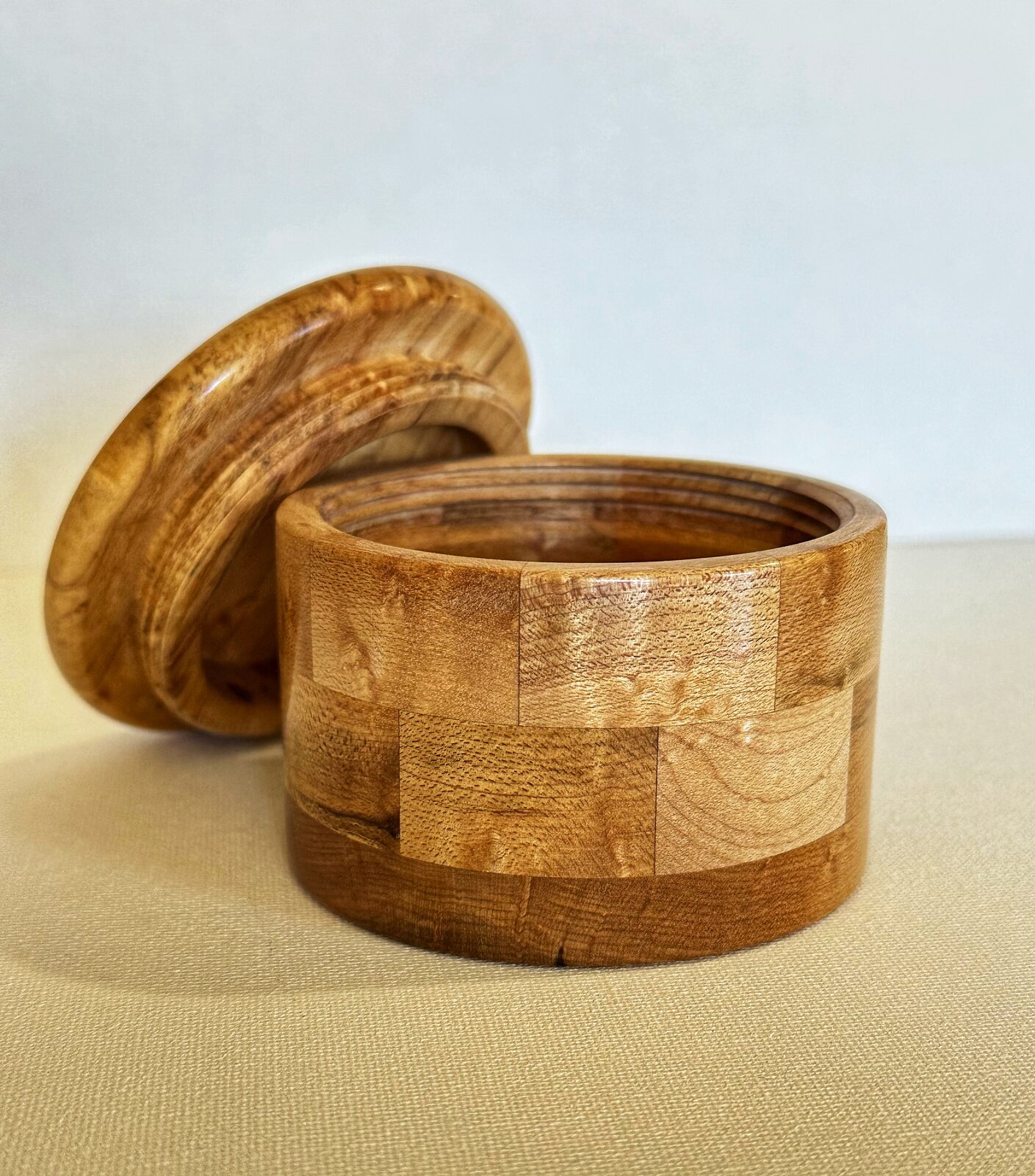

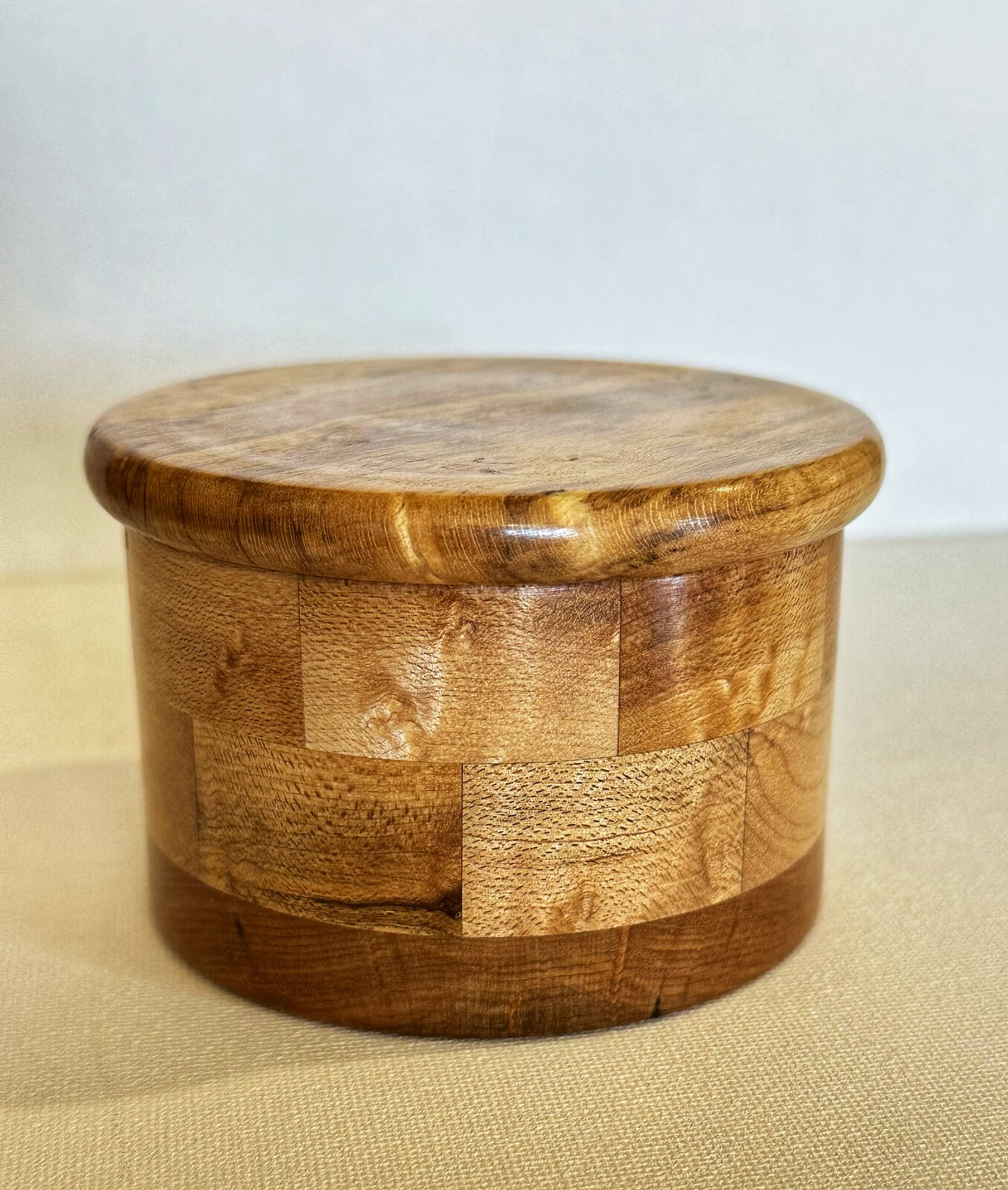

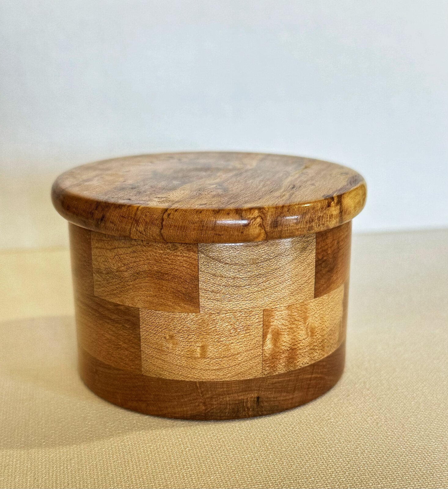

Everyone's probably tired of seeing these, but I think only another woodworker can appreciate the prep work to make something like this. Not saying it's difficult , just takes a lot of engineering to cut the wedges perfectly and then setting up and cutting the threads and when you're done it all fits. I really enjoy making these. This one I let the lid overhang and I'm liking it better than the flush ones. All birdseye maple.

Beautiful!
I haven't done any turning other than pens and can't even imagine how you turn the threads.
Not tired of seeing them at all. They're beautiful. I agree with you that the lid being a little proud of the body diameter is a nice aesthetic. If you had just posted another box with the lid flush with the body, I would have admired it as well, but now that you've made the new lid design, It's cool to have this new option. Adds some variety.
The Birdseye Maple is also really a nice choice for these boxes.
I know you spent considerable time making the jigs to make these so precisely. From start to finish, how much time would you estimate it takes to complete one of these boxes? (hands-on time, not finish drying time).
Thanks for sharing.
