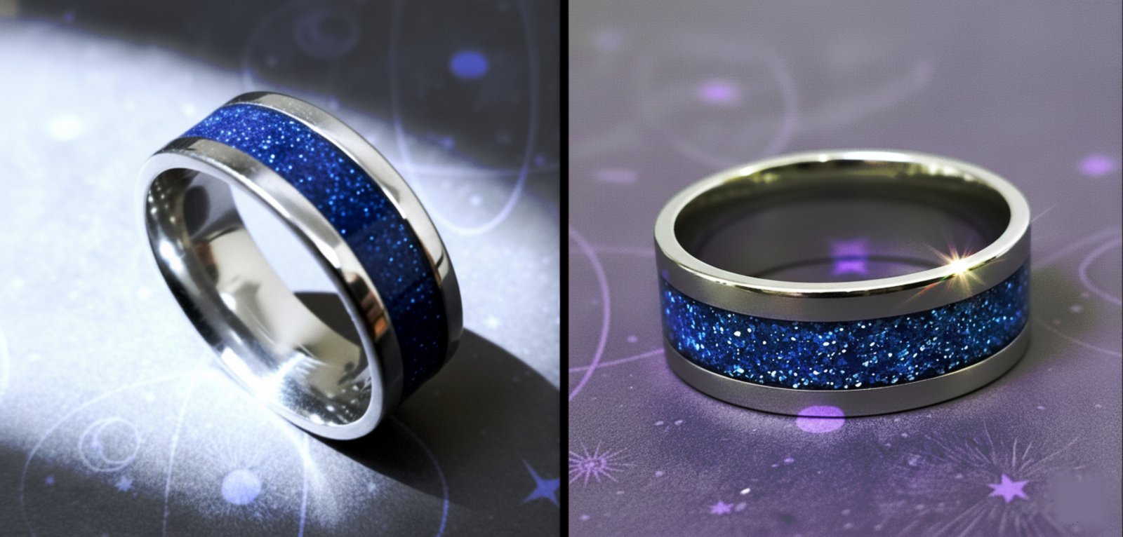

Hello there! I made another ring,it was just a test,as the inlay material was dirty cheap...and it turned much better than expected!!
Hi, that looks really nice. What was the material and how did you "cast". Im not up on ring nomenclature. Thanks
I have written in few posts before,I have purchased large quantity of plain chirurgical steel rings in many sizes when a store went out of business. Ten of every size from 7 to 15. I got a carbide tip set (one handle and four differently shaped tips) that I use to cut the groove into the ring. If you look at the photos,you can notice one side is a little bit broader.
The inlay is made of blue glitters and CA. Its not as easy as just puttin CA on and glitters then, but Im not gonna write the whole process here as it would get really long:)
