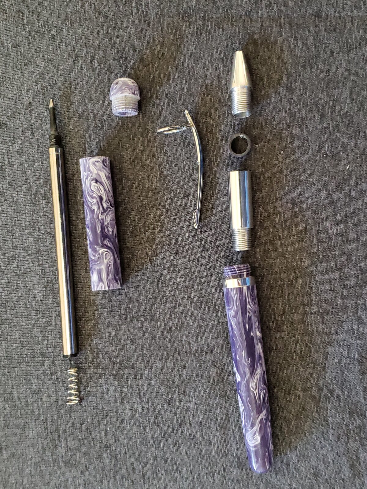

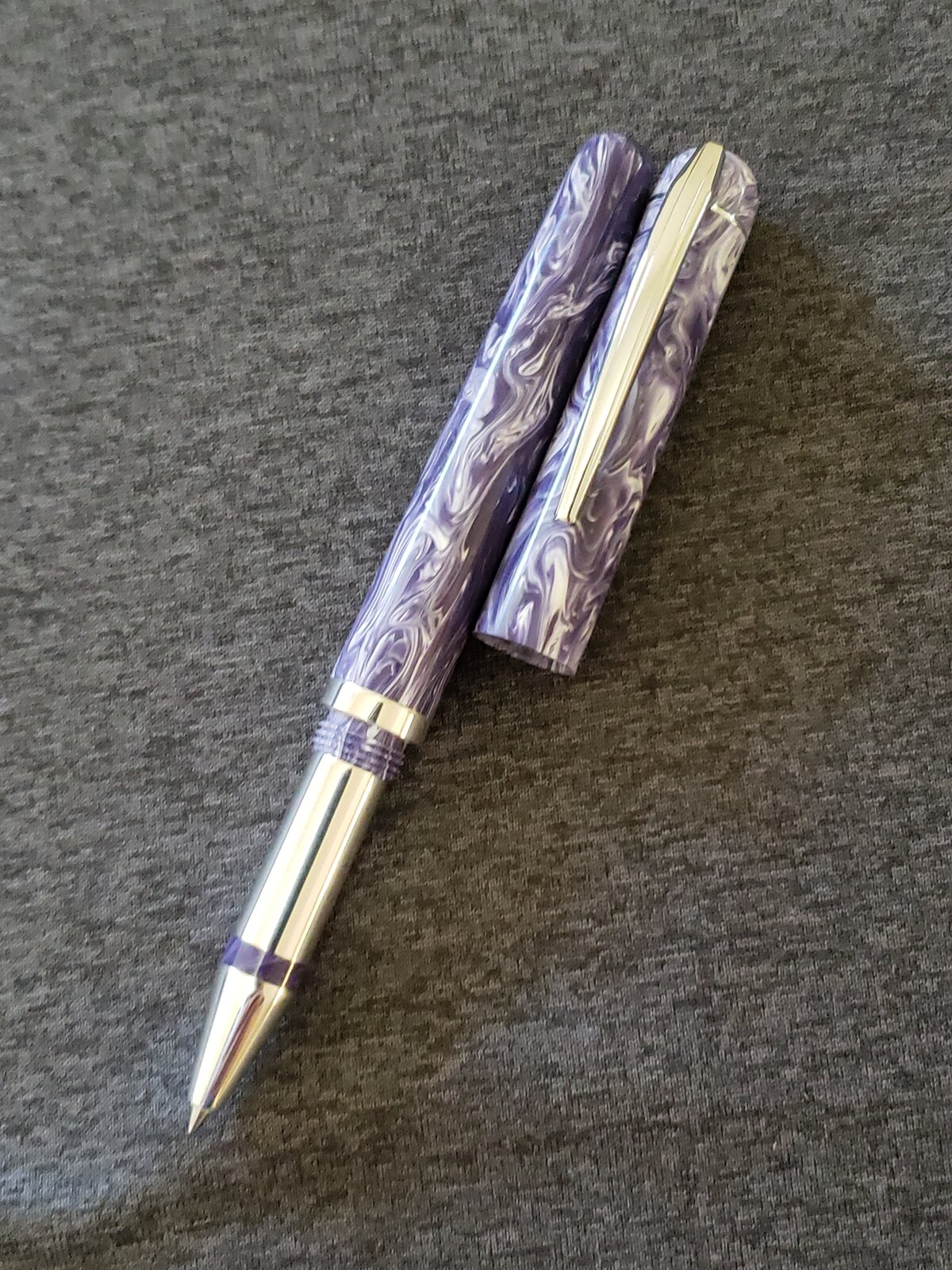

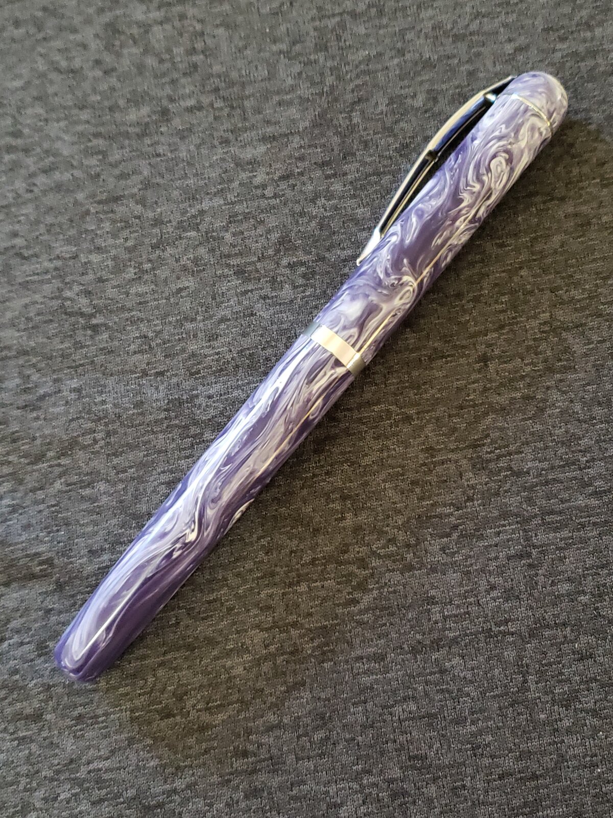

I wise pen maker once said, "Do several studies on what types and colors of pens sell. Then make purple pens." They weren't wrong.
I decided to put a little more of a taper into the body of this one. You can actually post the cap on the end of the body if one should so desire. It was turning into just another pen with a cap so I decided to put an additional band of color towards the tip. The metal parts are aluminum, the band on the clip is 12 mm. The threads for the cap are single start 11x1 mm. I'm going to take a 1 pen break from purple then the one after that will be purple again. I'm seeing with casting it's easy to over mix when blending the colors when casting the blank. I'm getting a bit bored with this style of pen and may need to try something different for the next one.

So what threads did you use for the nib to section and section to body ? (you stated the cap to body as M11 x 1 single start. )
And also the finial (that holds the clip on) to cap threads ?
The nib section to the body is 8x.75 mm. I like to have the nib extend into the body further that the threads for the cap for additional strength. The very tip is either the same size or 7x.75. I use metric taps and dies because the math is easier. On this one the threads to hold on the final are also 11 x1 because I forgot to step drill the top of the cap down for 10 x1 which works better for this clip. I had to sand down the threads just a touch and the clip screws up the threads and fits quite tight. Normally I would go slightly smaller and leave a shoulder for the clip to sit around.
