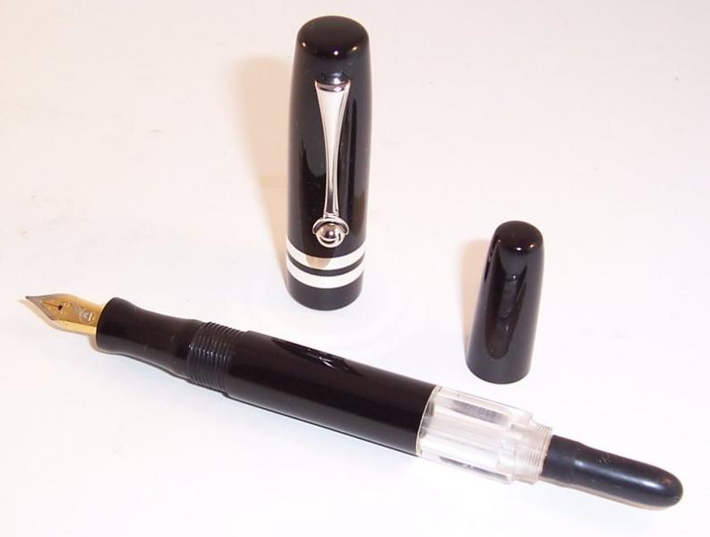

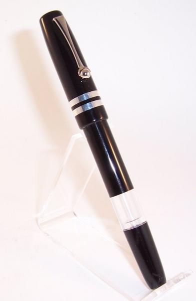

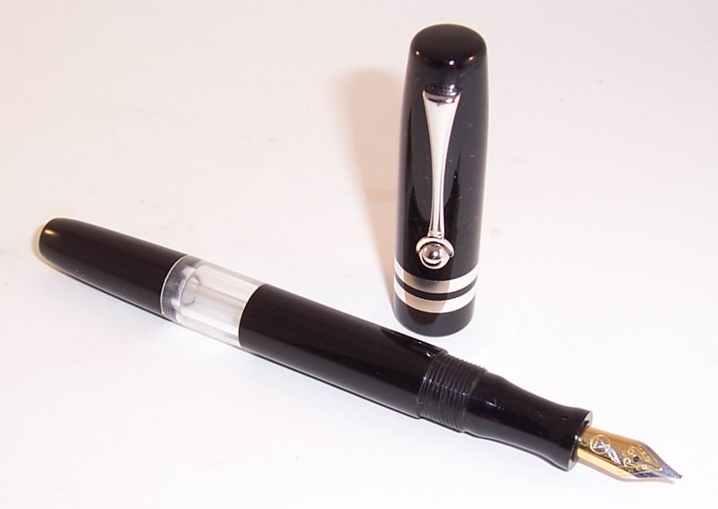

Another of my pens made with the good ole days in mind.
It is called a bulb filler because the pen body itself is the ink resovoir and is filled by dipping the pen in ink and pressing the bulb several times to suck the ink into the pen. The cap sports dual sterling silver accent bands and a ball clip. All parts fabricated by me except nib and clip.
I am just having more fun than is allowed in 23 states! Comments and or suggestions welcome.

I thought I might add that I put the ink window at the bottom for two reasons. 1. You can hold the pen up to see how much ink is left and 2. you can see how full the pen is getting when filling it.

It's a real beauty George. Does a button clicker operate the same way as a bulb filler?
No, a button filler relys on a button to depress a pressure bar which in turn compresses the rubber ink sac. Releasing the button allows the pressure bar to return to a relaxed state which in turn allows the sac to return to normal, sucking in ink as it does. The bulb filler uses a tiny "syphon tube" to suck ink into the pen. Several squeezes of the bulb will fill the pen with ink.

I never understood the way a bulb works till you said.:redface: Is that the little syphon tube you can just see inside the window of the first pic?
Is this how it works?; Hold the nib in the ink and squeeze the bulb, this then forces a 'bulbful' of air down the tube and the bubbles escape in the ink bottle. Release the bulb and it sucks a bulbful of ink back up the tube into the pen and just keep repeating till filled?
I don't know why, but I always imagined that you'd squeeze the bulb, then dip it in the ink, release. Then I thought you would have to turn the pen upwards and squeeze some more air out:redface:
Please go to the head of the class, you have it figured exactly! :smile: While your thinking cap is on think about how and what you would need to modify in order to supply ink to the nib for writing! Remember, filling is one thing, writing is another!
I have experimented with different lengths and diameters of bulbs and of course the longer the bulb, the larger gulps of air it can displace thus filling the pen quicker but I have selltled on an even shorter bulb than the one shown. I doubt anyone will be in such a hurry that two extra squeezes will be a problem.
