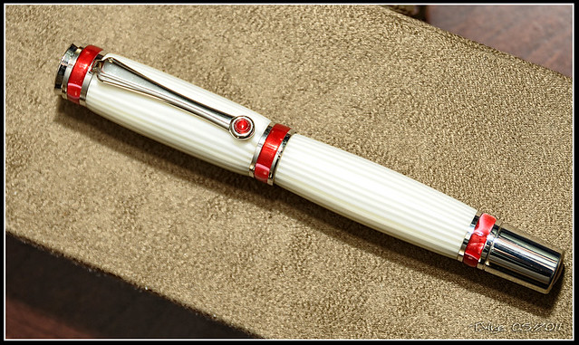

Dang! What a great pen. If envy is a sin, I'm need of confession. I gotta learn to do this. I have two majestic kits and now I'm going to have to start taking one apart and try something like this. Now, see what you've gotten me into?!!!
I've heard that material cracks easily, so well done.
If you need me to hang on to that pen so it doesn't get lost in the move, : ) I promise to send it back to you after you get settled in VA!
Thanks for sharing it.

Funny Martin, if my wife didn't already grab the thing up I would gladly send it to you for safe keeping! :biggrin:
Also, Casein tends to crack, but this is the Alt Casein from exotics and it's a basic resin so you turn it the same way. The only issue I've had with it on the larger kits like a Majestic is the white areas. If you buy an Alt Casein Rod you'll see the sweet looking lines, but there are obvious flat areas that are difficult to turn past with the larger kits. If you use a Majestic Jr you can turn past these areas and have a pen that has a uniform look to the lines in the Casein.
As far as taking apart the Majestic...DO IT!!! With your crazy skills I know you could do something amazing!

Pretty soon it will be my little shop in VA. I have one pen left in me before we pack everything up for the movers next week. It will be segmented and use HRB. I'll post the sketches with it when it's finished.
Thanks for the Kind words by the way. Just having fun and seeing what can be done.

Got out my Majestic kit today to start disassembling. How in the world..... this is going to be hard work - and expensive if I goof it up. I think it is definitely time for a jig - I also have a terrible time disassembling the Zen cap.
AND..... I had a great thought on how to do it! So I'll keep you posted.
Martin
Just take your time and try not to hit the Rhodium parts. A jig WOULD make things easier in the long run or we could just ask the company to send the kit in parts instead of together. Might have better luck with a jig:biggrin: Best wishes Martin

Beautiful pen. I just love the comment "It's easy once you get the kit apart".
Well...it is, ha ha ha :biggrin:
Truly a pain in the butt to remove everything, but well worth the effort after it's done.
Best wishes
MUCH easier than that! Simply go to http://www.exoticblanks.com/ and click on the "New Arrivals" link on the top left of the page. From here you will see a material called "Alt Casein Rod." That's the material! Pretty easy material to turn and looks great at just under $7 as you can see.

You don't really need any more praise for that one to get the point it is a great pen, but I can not not join in. That is a spectacular pen! Really one to get the juices flowing. Congratulations!
I have always liked the look of casein. In fact the last pen I made for a wedding pen was casein, but I think that alt. casein is actually prettier. looks like the lines are more pronounced.
Here's an image of the pen with the cap on. I should have posted it with the initial posting, but I didn't care for the image since it didn't show the end cap accents and made it look rather simple.
