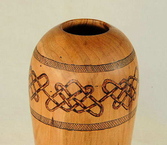

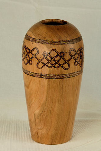

My second hollow form and my first attempt at pyrography. I found the pyrography to be really relaxing and totally absorbing. The vase is cherry and stands about 8" high.

Keith, looking good. Funny how several of us are doing about the same things at the same time.

And now I have even more I want to do. I'm not on the pendant band wagon but I do like vases, bowls, and other vessels. Nice work as always Keith.
