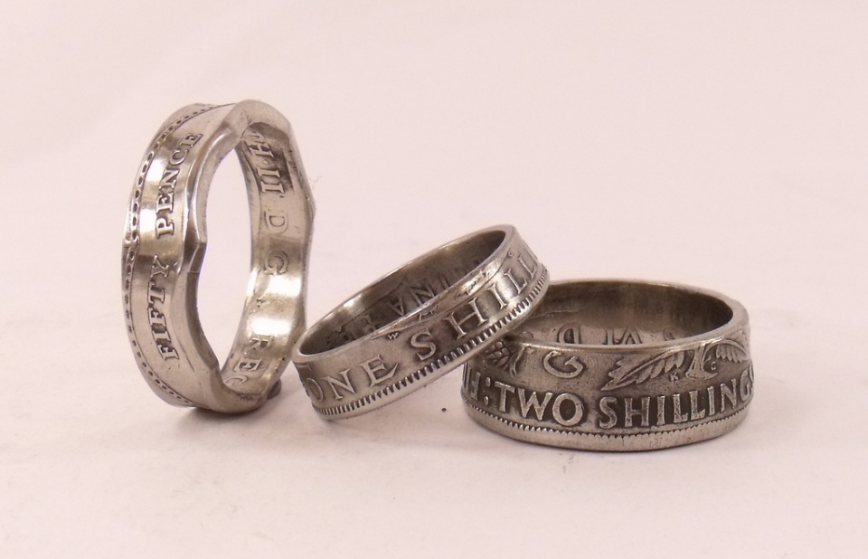

Hi all, between work and life, I don't get much play time anymore. :frown: So I figured I'd try a new 'quickie' hobby. Making rings from old coins.
Here are my very first attempts, all demonetised ( no longer in circulation ) British coins. A Fifty Pence, a One Shilling and a Two Shilling. I think the 50p may perhaps be illegal....the rules on British coin defacing are a bit ambiguous, so I'll stick to safer much older coins in future. :wink:
Fun to make and the tool cost investment doesn't break the bank. Google / You Tube 'Jasons Works' or 'Coins You Can Wear'.
The 50P has a high polish, but I left a bit of the patina from the annealing process on the outside of the Shillings as this makes the image stand out more.
Once I get better, I'll make my own tooling to make pen centre bands etc. The commercially available gadgets don't go small enough ( or I haven't found them )
Hope you like:biggrin:

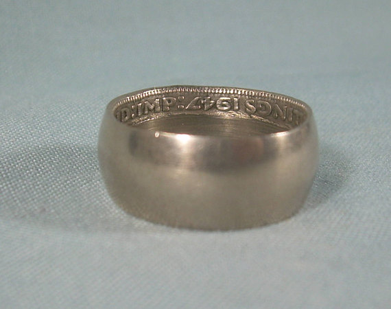

Nice one Skip, used to do this myself.
Always tried to use Pre-1948 Two Shillings as they had a higher silver content and were easier to work.
I used to rotate and hammer round and round until the wording was on the inside and then drill it out and polish the blank outside. As you can see from the Photo (example, not mine)
I had a small anvil made out of a piece of British Rail train track to hammer on.:biggrin:
