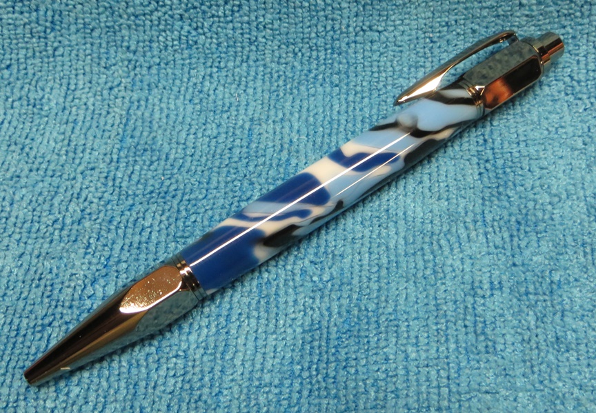

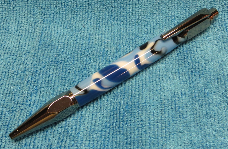

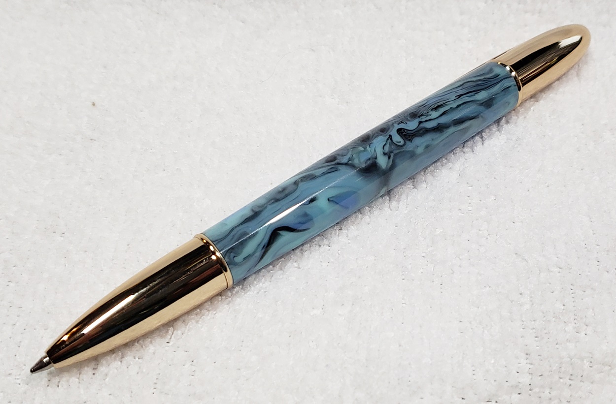

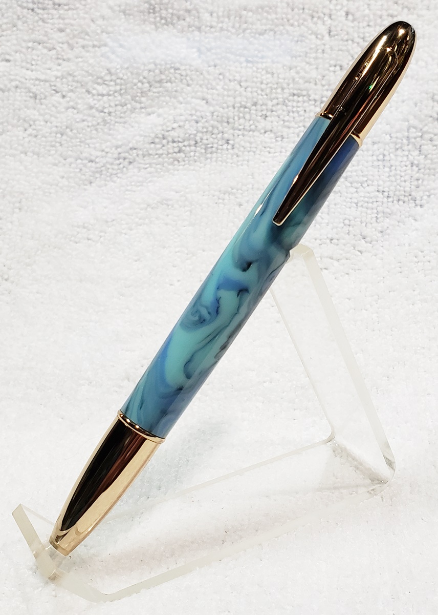

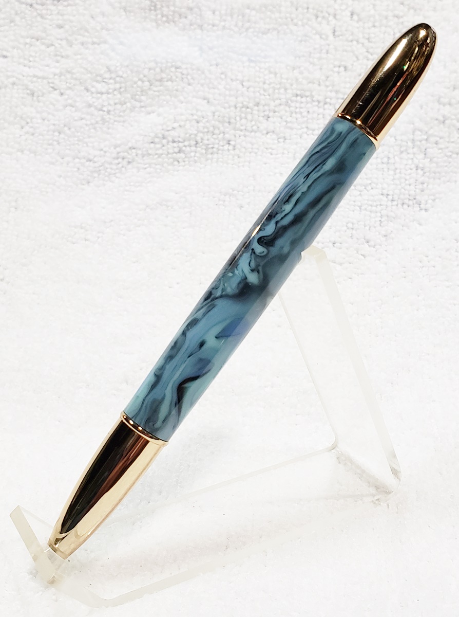

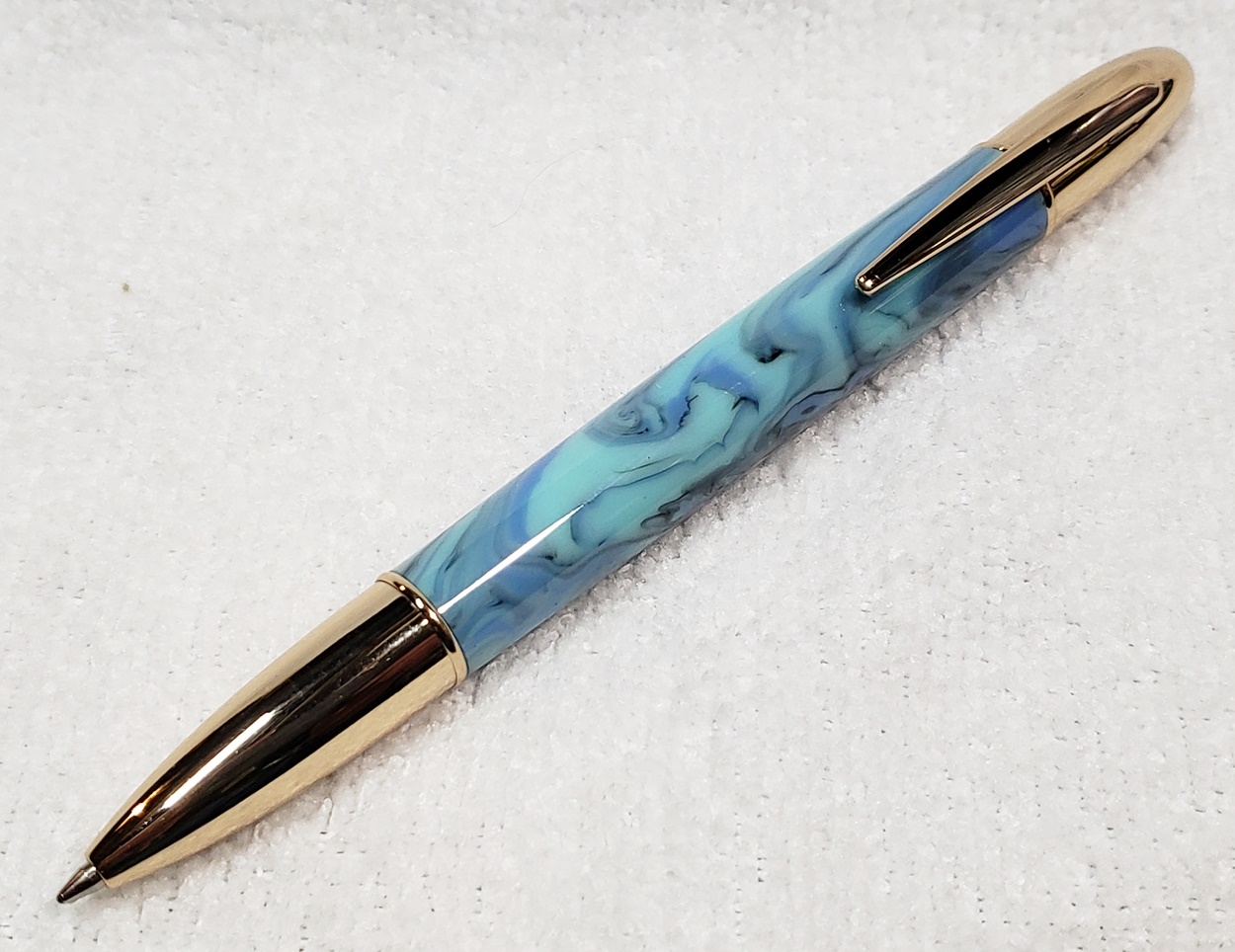

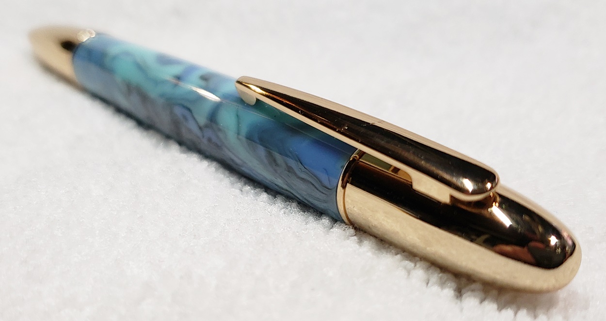

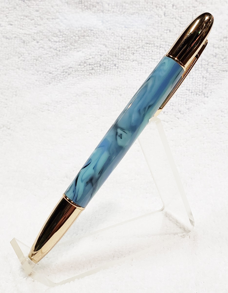

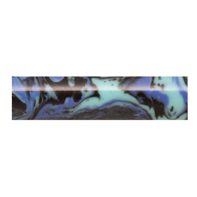

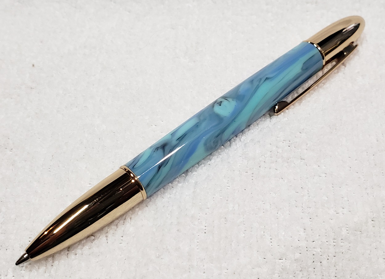

I've made several Falcon pens from PSI, and am a fan of the minimalist style. This one is obviously in gold. The blank is a CamoSwirl Navy Camouflage from PSI. Not sure I'm a fan of the colors. And it's not very "camouflagey". Plus, it's polyester resin, which is brittle like inlace acrylester. Turning it was not fun. It did polish up nicely, though.

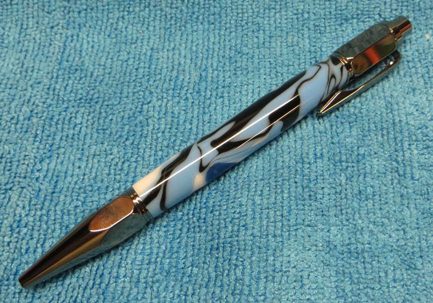

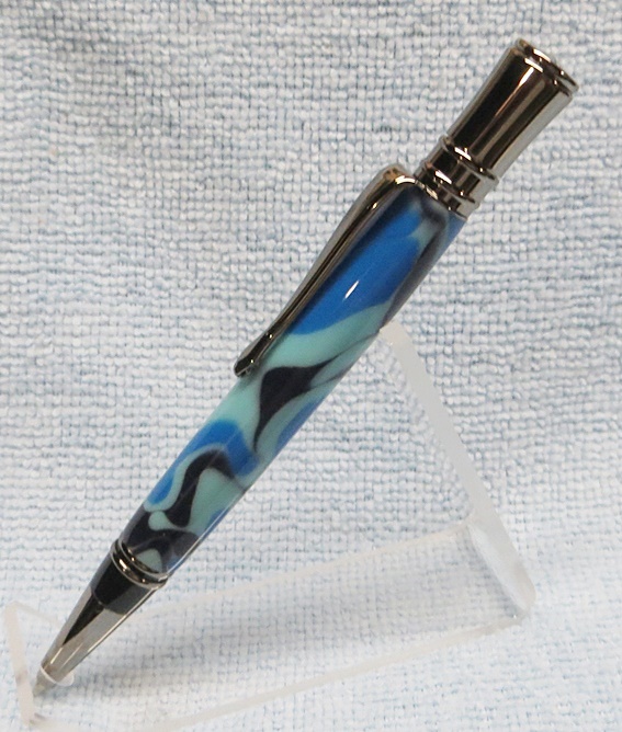

I appreciate the compliment and offer, but I'm going to give it to a friend who likes the ocean. When I said it's not very "camouflagey", I meant that it doesn't have the traditional (to me) camouflage patterns. When I think of Navy camouflage, I think of the Woodland camo pattern, but in blues, whites, and blacks. I've turned a couple over the years.

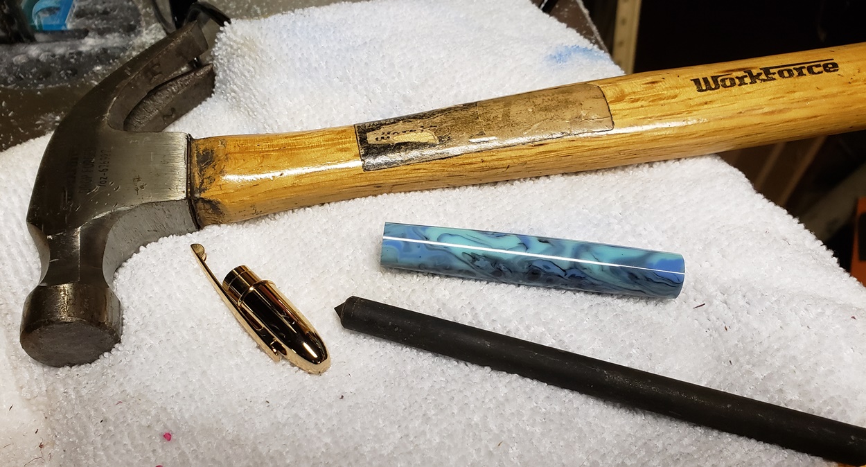

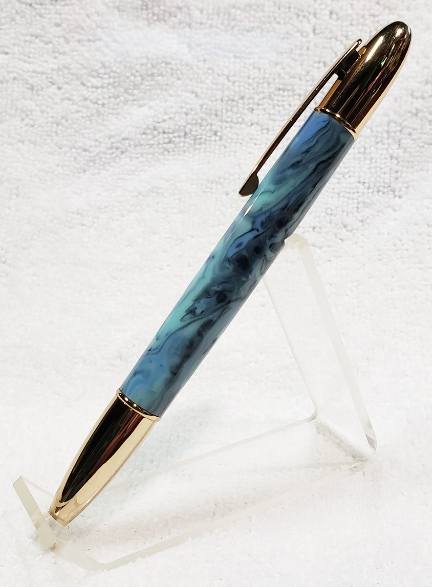

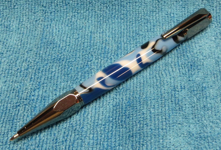

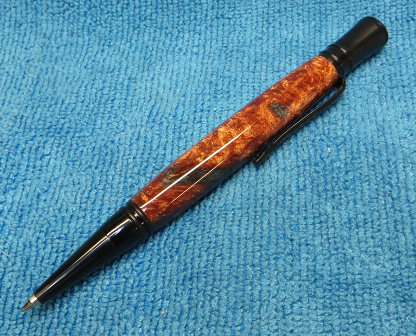

I would say this isn't a beginner's blank. I've been turning pens since 1999, acrylics for at least 19 years. Now I'll be the first to admit, in spite of my experience, I'm not really a talented turner. I can't even use a skew properly. At the risk of blowing my own horn, I will say I've had many more successes than failures. A lot of that, though, is from pure dumb luck rather than any talent on my part. Polyester resin and inlace acrylester are the most challenging blanks I've turned, and I truly hate them. I would recommend starting with acrylic acetate (AA) blanks. They're softer, easier to turn, and more forgiving. After that, I would try Rhino blanks. They're more "chippy" and harder than AA blanks, but not as difficult as PR and IA. There is a huge variety of Rhino blanks with some truly spectacular ones.

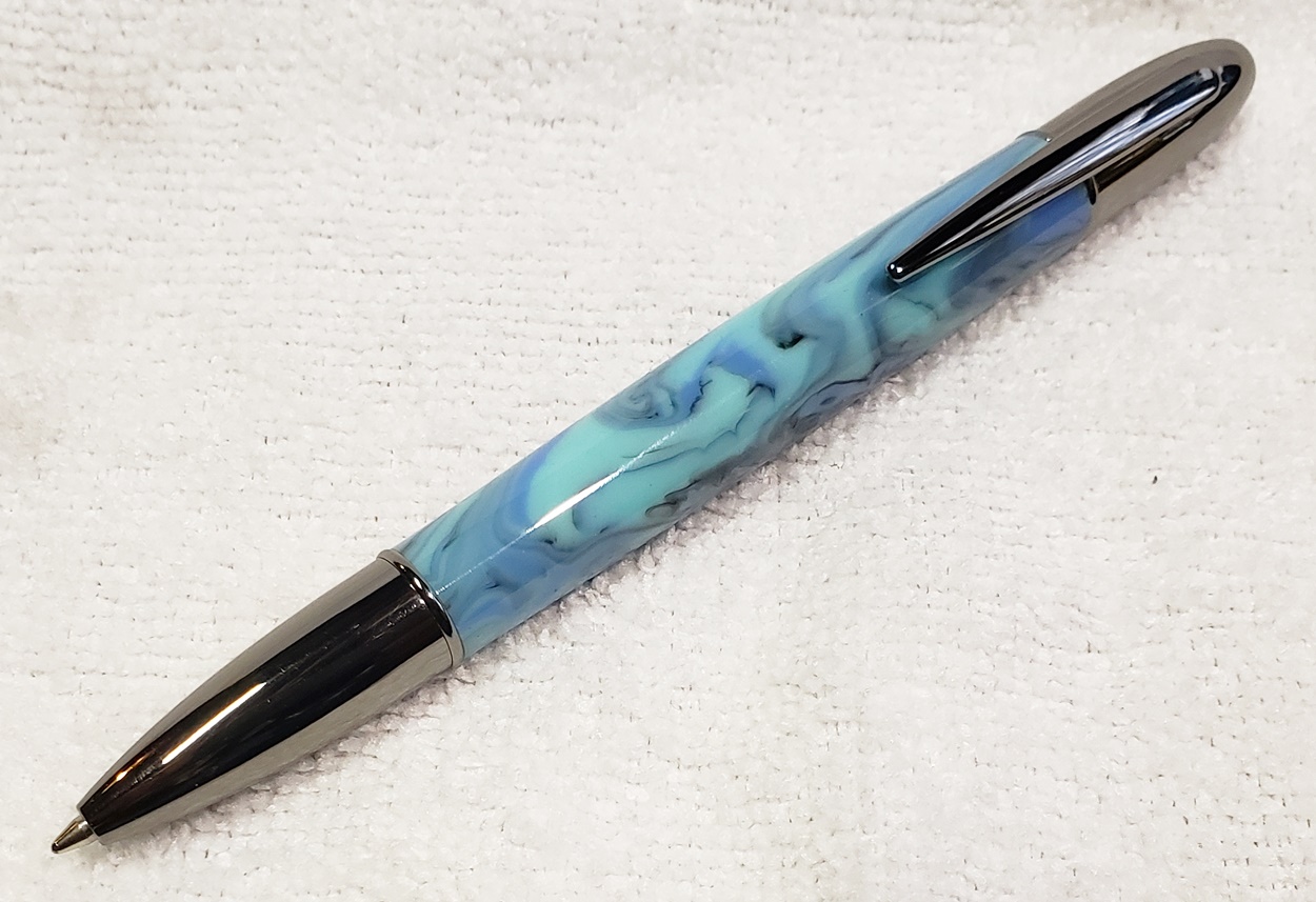

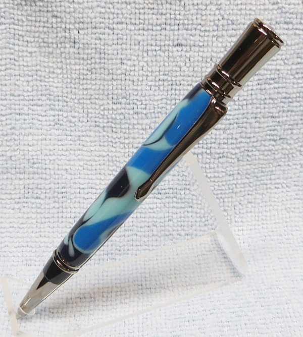

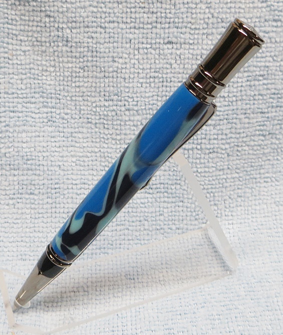

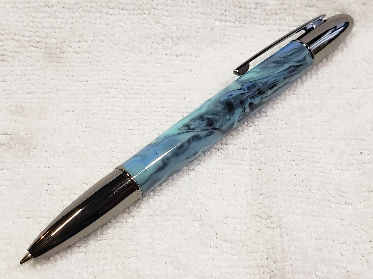

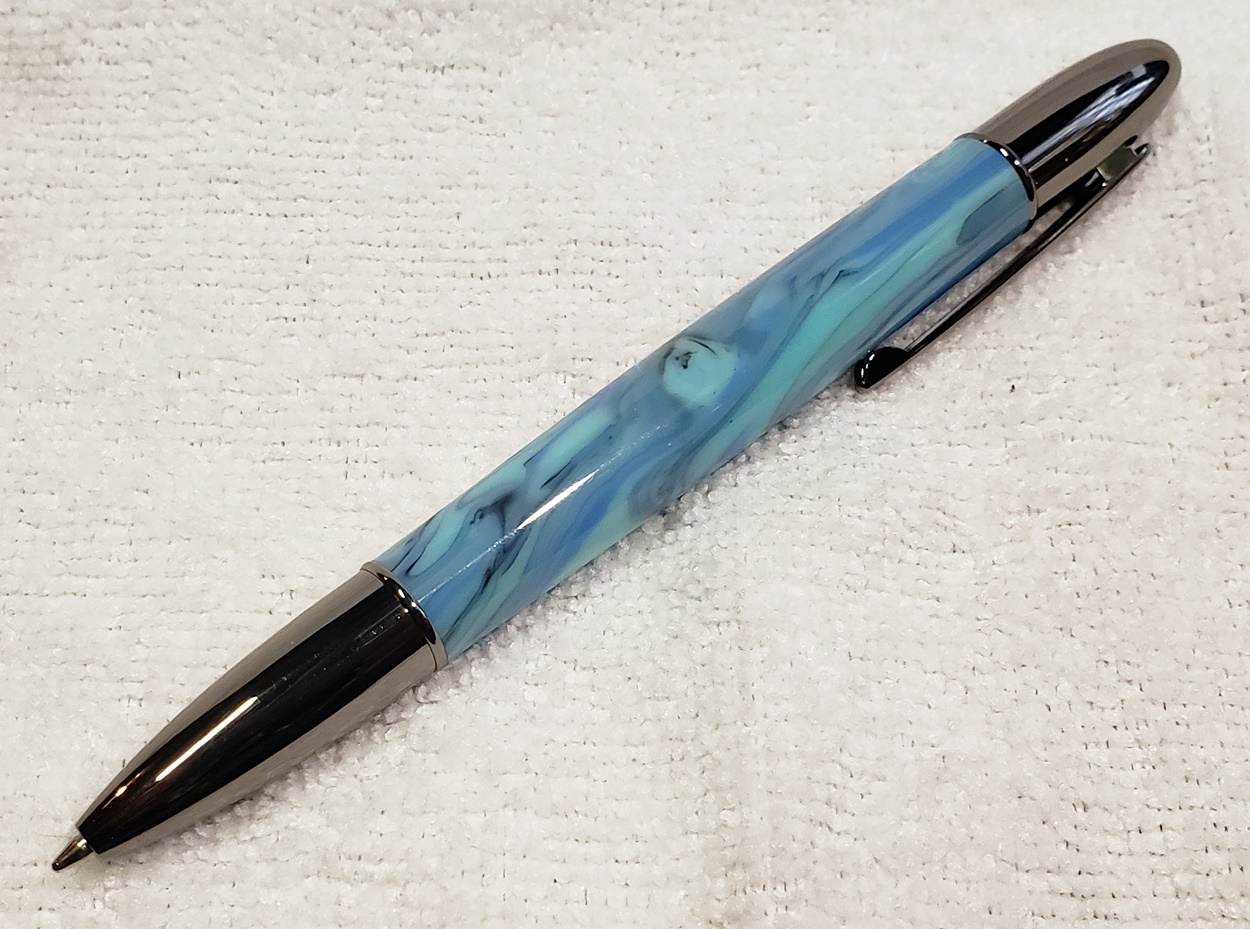

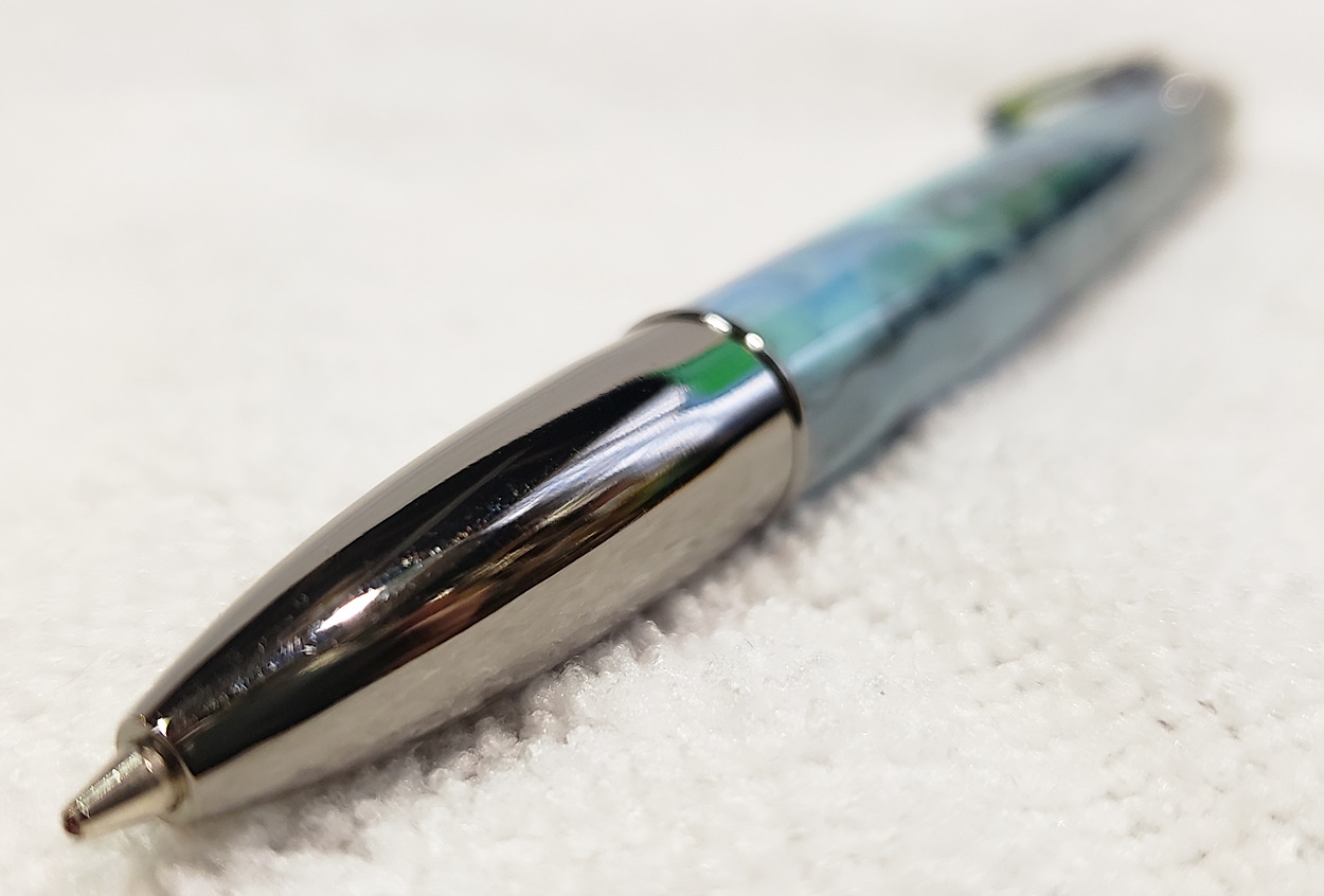

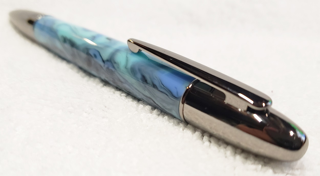

Since I'm going to give this to a Navy veteran, I decided to switch it to a gun metal kit. I like it a lot better.

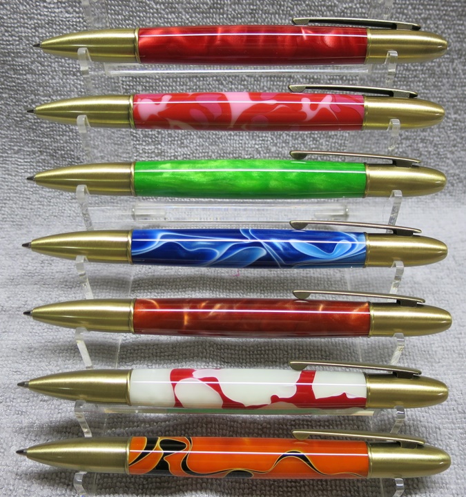

I just looked up the Falcon kit on PSI's web site. Looks like it may be discontinued soon. The only one I could find was in antique brass and it was on sale for $3.97 down from $10.95. If you like them maybe you should act quickly.
Yeah I saw that. I do like the pen, but I've made quite a few. I made 7 of them for some of the girls at work back in 2016.
