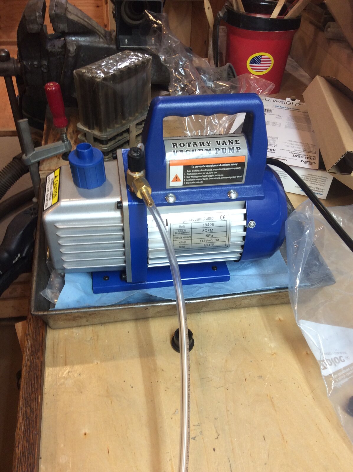

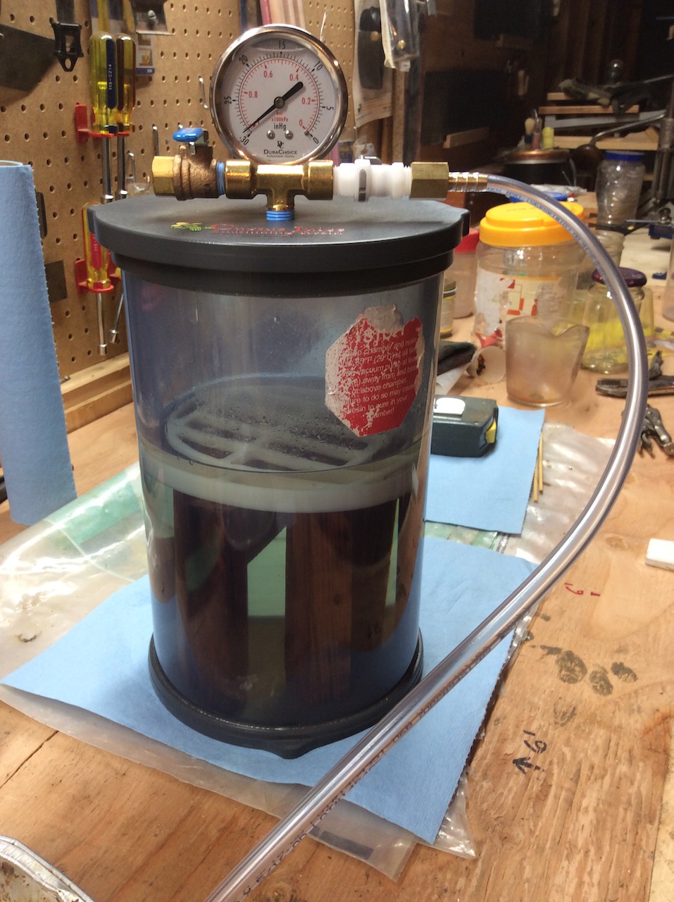

MRDucks2 unsure what you mean by "valve out" your chamber. Understand shutting off the pump but lost me on valve out. Do you mean disconnecting the line from the chamber to the pump? Here are pictures of my chamber and pump. Read that you should always evacuate air from the chamber before turning off the pump otherwise will cause future issues with the pump.
1080Wayne dried weight going into chamber anywhere from 190 - 250g, depending on number of blanks being stabilized. Toaster oven only can hold 9 blanks at a time. Have yet to wrap them in tin foil to get a possible second layer.
I realized after asking the question your set-up may be different than mine. I have valves installed so that I can completely isolate the vacuum chamber, if I want, and work on the pump or tubing without using vacuum. Also helps in troubleshooting leaks.
The chamber should easily hold vacuum without the pump running, if you can shut valves on each side or "valve it out" for we industrial maintenance folks. The same folks who put twice as many valve on stuff at home than normal people. 😊
I also have a smaller chamber between my main one and the pump to drop out any cactus juice should there be an incident.
Okay, that makes sense. The more the better eh! Took that approach building my last house, why use 2 nails when 6 could fit. My plumber was far from impressed when removing studs to get in his pipes!!! Thanks for the valve idea, something to ponder for the future.
