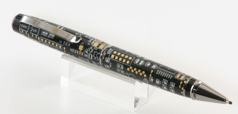

Brings Darth Vader to my mind! Black Titanium plating.

I like it Mack. That plating looks good with the black circuit board. Getting rid of that chunk of black plastic in the middle makes quite a difference as well.
That is a beauty of a pen. Cigar type pens, I really like them. What extra steps are needed to eliminate the lower parts of the the upper barrel?

The circuit board blank is predrilled. So the lower (nib) portion stays the same length when cutting, of course. Then I cut the clip end to ~55 mm in length.
Great pen again, Mack ! Look out, though !! :biggrin: I bought some of those blanks and I'm gonna make some .... using your method ! Where'd you get the black titanium cigar ?
Beartooth Woods!
Well I've told you where to get the blank, what lengths to cut the tubes, now where to obtain the kit! The only thing I can do got you now is turn and finish it for you!
Yes, Mack .... you have been very helpful in telling me (us) everything I need to know, and thanks for offering to make the pen for me :biggrin: .... but the turning and finishing is something I have to do myself !!! :smile::smile::smile:
I sooooooo like the cool look of your circuit board pens. I think you are brilliant to come up with the idea of leaving out the center band !! :smile:
You know, when I started pen making 5 years ago I made a few cigars and they turned out really well. I liked them very much, but they took a lot of care in shaping because the bushings are all different sizes. Now, with the method you have told me about, the shaping becomes easier, and the appearance of the resulting pen is even better.
Thanks for your valued help, Mack. I mean that most sincerely.
