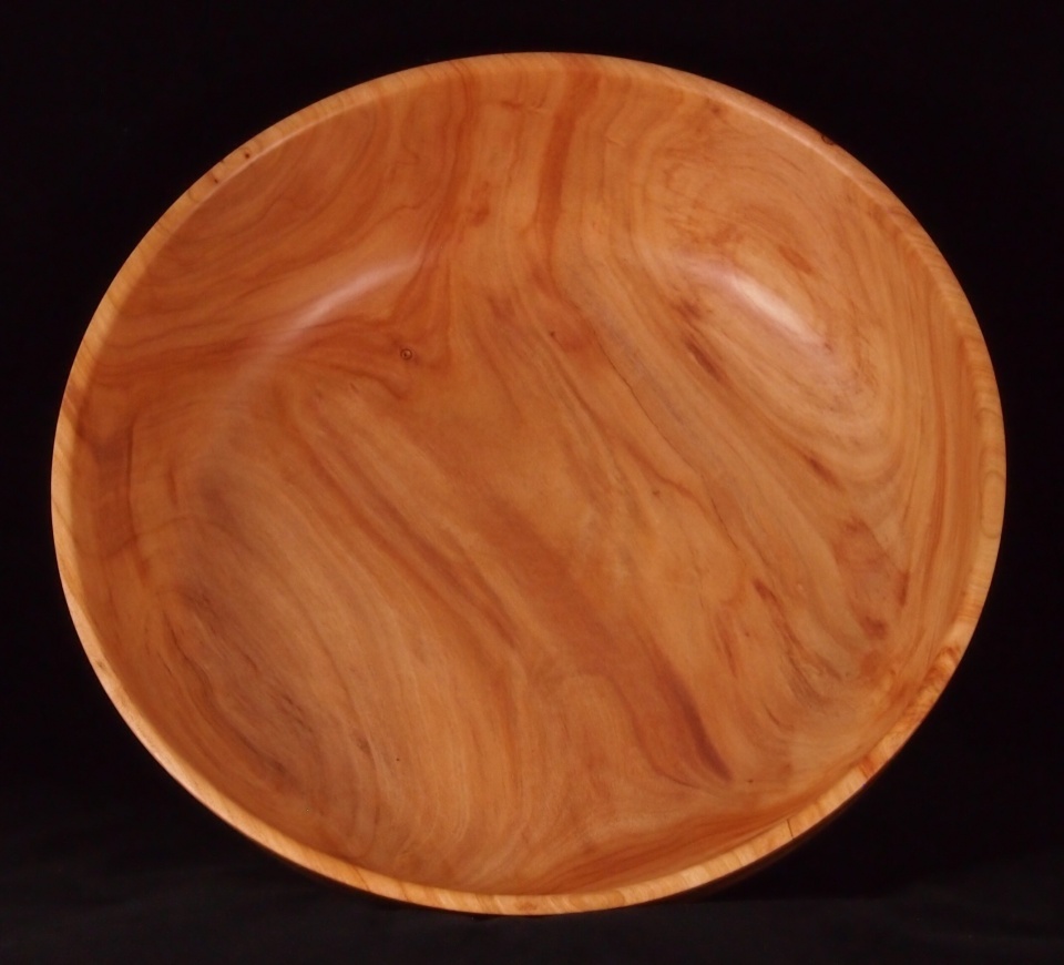

Woke up early, its a wet and nasty day, big piece of cherry in the floor of the shop, what should i do? I know, make a big ole bowl. This bowl is 12 1/2" in diameter and 4 1/4" tall. My biggest ever.

Nice bowl, Cody. I really like the top view. The interior is very nicely done - always the toughest part and the part that is seen the most. Curious - did you turn it green in one pass?
One other Q - was the shape of the exterior intentional? It's interesting, but the elegance of that cherry almost asks for a single, continuous curve.

A professional turner taught me to turn bowls green in one pass, if they are turned thin enough the stresses are relieved and the bowls will not crack. He sells his bowls and globes for some hefty prices, so I figure that he knows what he is doing. On bowls of this size, I shoot for a thickness of 1/4" or less. When done this way the bowls may warp after drying but that simply adds character in my opinion.
The exterior shape was intentional and yes a continous curve would have worked well. I just decided to go for a little different look. I have got another piece of this cherry mounted on the lathe and have already decided to go with a continous curve. My 4th and final bowl from this wood will be a natural edge if all goes as planned.

Well, that is my kind of a great way to start the day...!:wink:
The grain seen from the inside is just amazing and I asked myself if it was green or dry, as most large pieces of cherry crack and I couldn't see any cracks, off-course this may change if the wood is properly dry kiln..
I'm also OK with the shape, I use it quite often...!
Lets hope, the wood behaves...!:biggrin:
PS: Very good finish for green wood.

I like the exterior shape... I try to not be all that consistent with my shapes... mix them up to make the turning more interesting... my wife likes me to put rims around the outside of some bowls... on the green wood turnings, I almost always turn to finish on green wood... most concession I may make, if it's particularly green, I'll run it through the microwave a few times to dry it. I don't know who your professional turners was, but I read once a statement from Bill Grumbine on turning green wood... he said turn it and let it warp.... I think he also said on turning thin walls, "turn a bowl as thin as you can and get it out of your system, then turn practical bowls." You have a nice bowl that you can be proud of... good show!
Cody - thanks for the response. And I have to say I am deeply jealous that you have enough of that cherry to do that many nicely sized bowls. And your craft is doing the wood proud. Well done and keep the pics flowing!
