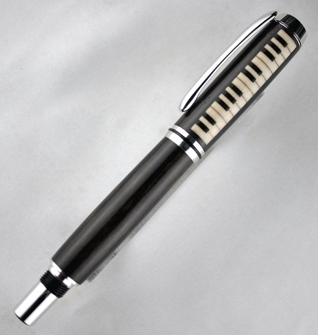

Thanks to Ken Nelsen of Kallenshaan Woods for letting me be one of the first to try out his newest kit. This is a less complicated yet equally attractive design which is sure to be a huge seller into so many markets.
A little CA, a light hand on the skew, lacquer and TSW and voila!
Thanks for looking!

Lou, looks like you hit a high note with this one! Are they actually ebony and ivory, or are they more friendly materials?

Lou, I'm aware that Ken is in final prototype for this keyboard kit. I can't wait until it is for sale. How about some details on your finishing techniques?

I received my kit in the mail from Ken to evaluate also... the woods are holly and blackwood...
Unfortunately mine did not fair quite as well in the shipping and Ken and I discussed the cap being trimmed to the holly on both sides instead of having the black edges that Lou's kit has...
From what I can see this is going to be a whole lot easier to work with than the Stars and Stripes kit.. you only have to insert the keyboard as it is all one piece...

Thanks to all of you who have viewed and to those of you who have taken the time to comment. Great thought on the dedication. Maybe I'll just call it the "Ray". Eagle - I never know which of your questions to respond to, but I can tell you that you can get it in any color as long as it's black and white. [:D] Thanks for the kind words R.T., Tip, Frank Billy, Michael, Shane and Pastor Bill...that's always sweet music to my ears! [8D] Gary - only when I'm working! Jim, as Tom mentioned, the woods are African blackwood and American holly. Larry, my finishing is very simple. I first applied thin CA to the holly to reduce the probability or the blackwood oils and dust migrating to the holly. I worked the heck out of my skew (I don't normally) and was able to start a very light sanding at Micro-Mesh 1500. Two very light coats of sealer (I just cut my lacquer 50-50). After drying overnight, I light sanded with Micro-Mesh 1500 through 12000, then added 4 coats of lacquer over two days (MM12000 after the even numbered coats). One more day of curing. Top coat is TSW.
The kit is suppose to be available very soon from www.kallenshaanwoods.com . This one has "Star" written all over it!
