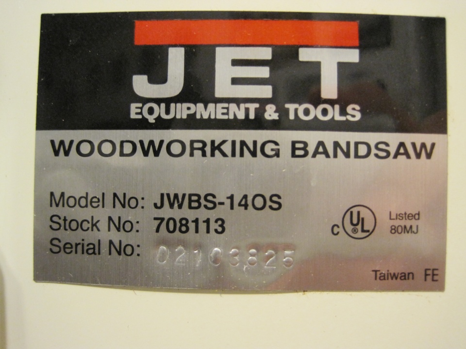

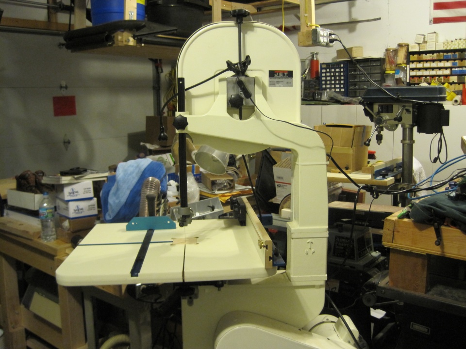

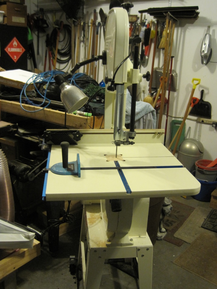

I am currently looking at a used jet 14OS. The owner sent me this info. I have not looked at it yet in person.
This is a link to the saw and gives all of the specifications.
JET JWBS-14OS, 14 in. Bandsaw with Open Stand-708113A - The Home Depot

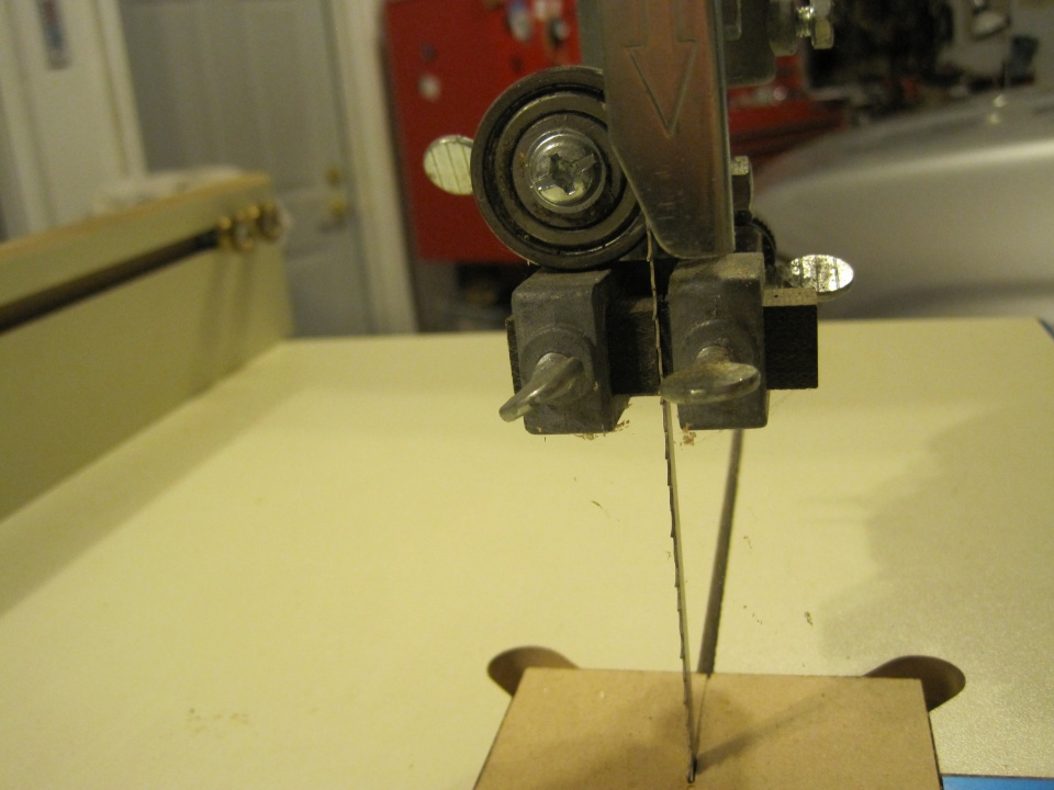

I have the Jet 6 inch riser block so the resaw is 12", and uses a 105" blade, from 1/8" to 3/4" width.

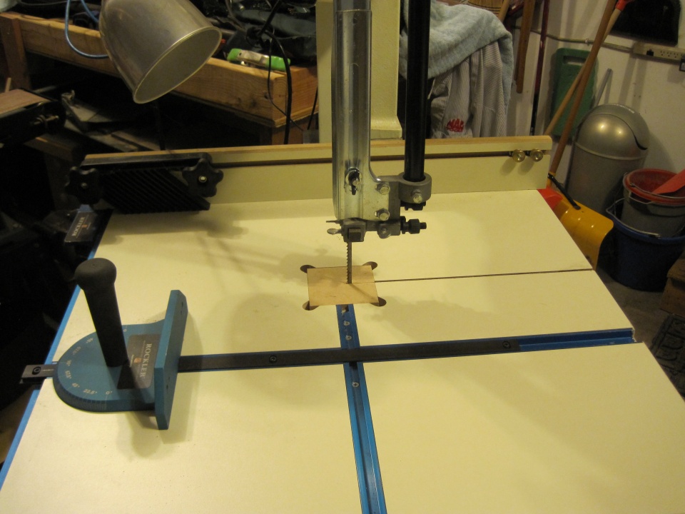

Included is a Rockler table and fence setup. Couldn't find it on the Rockler site, here's a video of it.
https://www.youtube.com/watch?v=DP2dA-2p_ls

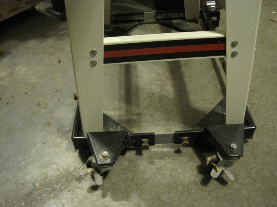

Also has a mobile base with locking casters.
He has not sent me any price yet but said he is moving and wants to sell most of his woodworking tools before moving.
Thoughts? Price? Suggestions? Alternatives at it sounds $400 to look for that will suit my needs?
This meet has a 3\4 HP motor.

Just my personal opinion, but I don't think that a 3/4 HP motor is going to be much of an upgrade over your Craftsman.
I have the Rikon 10-325, 14" saw with 13" resaw capability. It has a 1.5 HP motor and works great. For the type of things you're trying to do, I wouldn't want anything smaller.
This is just my opinion & it's worth exactly what you paid for it.
I agree, you won't be able to use that much of that 12" capacity with the 3/4hp. The number of teeth on the blades will really make a difference. Cutting thick stock, you should use something around 3 teeth per inch.
+1 on the 1hp...
I have a Jet 14cs which has the 1hp motor....night and day from the 3/4hp I had, well worth the money.
I have the 14" 1Hp closed stand version of that saw. I agree with all the posts so far.
Mine is what I consider underpowered for cutting larger bowl blanks, I do a lot of walnut....and have had some issues cutting some bigger ones...like almost to the point where it is dangerous. ( I have a scar to prove it. but these blanks are 8" thick or so ) However, I have learned that the blade makes all the difference in the world....I can't recall the name of the blade, but I get them from Highland Hardware and they are made for roughing bowl blanks. If that one is like mine it should be 105" and about 39.00. It does make it considerably easier, but still is very labor intensive. Another words, you are not going to spin it, while the blade cuts it effortlessly. I really don't know how much difference a 1/4 of hp would make...but sounds like some according to bobeilo. It cuts like a dream for all the flat work I do, but for bowls I have been looking for a used 18' 3hp with no luck yet.
Just my .02
Mike
