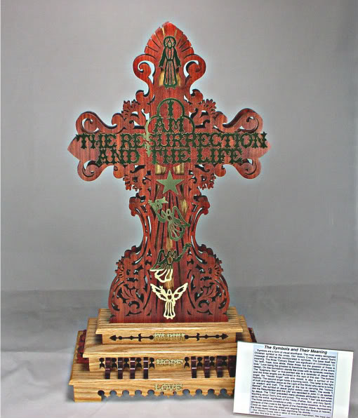

Welcome to the site Jim. I will give my opinion on this glue because I have used it in the past but will never use again. It is a polyurethane adhesive that dries clear and remain flexible and downright rubbery. Not an adhesive for gluing woods together or anything of that nature. If you read all the hype about it and its tensile strength you would say it a is a great product with tremendous adhering power. My opinion it is a craft makers glue for beading and small craft projects because it does dry quickly and as I said dries clear. I bought into the hype years ago when I was looking for a clear adhesive other than epoxy to adhere the brass cuttings I scrolled out to this cross. I thought it worked well at first glance. But not being able to sell the cross at my craft show I stored it away in a cardboard box as I do all the time and next year went to pull it out to have another try at selling it. Long and behold all the pieces started to fall off with little force. Not good when selling an expensive item. I have since cleaned the parts up and adhered them with good old clear epoxy and have had no problems. So to me the category this falls in is the garbage. But others may have different takes and I wish them good luck.

Beautiful piece! I've used it quite a bit on different projects and had no issues, but I know everyone has different experiences. I had thought about using it to glue tubes into blanks, but I guess I'll stick to epoxy or CA.

Highly do not recommend for tubes. Stick with epoxy. Can I asked what you used it on lately?
