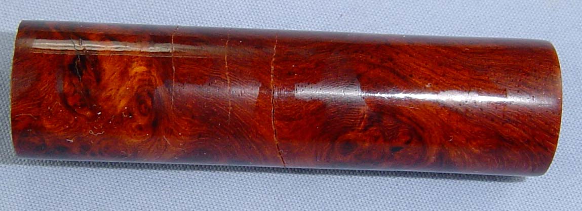

The last two amboyna burl pens I have done are cracking.
The emperor and the Jr statesman I posted last week.
Both cut from the same block, both cracking the same way.
Straight across the barrel. Looks like I took a razor blade and sliced two or three circles around the blank. Odd its not following any grain or feature.
The block of wood was waxed when I bought it. I cut a piece for the emperor, turned and assembled. About a week later cut piece for jr statesman turned and assembled.
One thought I had was that the wood was not dry and it cracking because I didn’t take the wax off and let it dry.
But I did an afzelia burl the same way. Wood was waxed, cut, turned and assembled, no cracks to date, that was a few weeks ago.
Any thoughts and or comments….the wood is too pretty to stop using it.

Pete, what finish did you use? Where is the crack? Could the problem be a crack in the finish, rather than the wood, caused by excess stress near the end of one of the pressure-fittings? Have you exposed the pen to rapid temperature changes (e.g., walking outside with it in your jacket pocket on a cold day)? Just a SWAG, but maybe it's the different rates of expansion between the different materials (brass tube, delrin, and plated brass) that's causing it. Again, just a SWAG.

Well the cracks are on the top and the bottom about in the middle of each section. Definately the wood and not finish.
The finish of One is shellac, the other CA.
THe cracks are weird, there in groups of 2 or 3 about 1/8 " apart on both pens. The answer is in how there cracking i think, but i dont know what it means. They dont look like a normal strees crack.
Oh well, ill just get somemore and try again.
Im thinking i should test/carry/or put aside all my pens for a week or so before i sell or deliver them. So i can see what suppries may come up.
anyway.....spring is here...no coat today...AND i dont need to turn on ALL the heaters in the garage anymore.....[:D][:D][:D]

Hmmm..... now you want a picture after i disasembled it, see next post....its not pretty......[:(]
this was the bottom of pen
the one on the right goes just about all around, the other 2 mabey half way
the top had about 3 cuts much straighter.

I agree with Dario; very interesting and it looks like the barrel was flexed. From what I can see, it looks like they all start from around the same general line along the length of the pen.
How long after assembly did the cracks develop?

The cracks started about 2 days after, on top and bottom of pens.
i got the jr statemsn doing the same thing.
so what we have is two pens same wood both doing the three crack dance on the top and bottom at about the same place.
I wish i had kept track of where i cut the blanks from. Im going to guess all the cracks are comming from the same section of wood.
Mabey it was just a week section and couldnt handle the strees of becomming a pen.
The jr doesnt look like its goiong to be as bad. Im not going to disamble that one totally (after killing my emperor im gun shy).

Can you do an "autopsy" on this barrel [}:)]? LOL
Please peel off the wood from the tube and investigate if you have good adhesion especially where the cracks are. Maybe using gorilla glue will prevent your cracking problem. I use GG and never had that problem (knock on wood).

lol....take a look at the little bowl with the peices that are left,
if you can glue them back together, ill do the autopsy then.[:D][:D]
