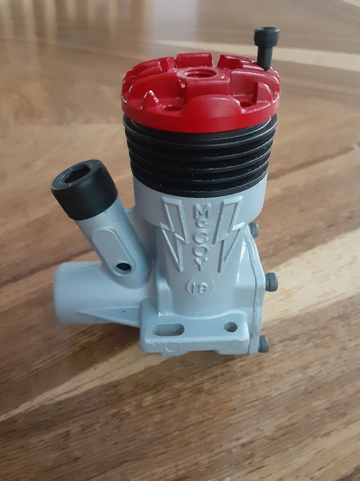

Yeah, I have been powdercoating for decades. I broke my first gun, and am on my second gun and now have a Jegs powdercoating oven, it could roast a turkey. I went through 2 toaster ovens.. I have also been successful with ceramic (Ceratoke) coatings. Attached pic of a model airplane engine Cerakoted with three different colors.

WOW, a McCoy redhead, but not the famous '60, but the 19 will do!
