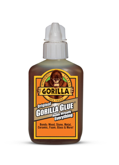

I just completed a 30 pen order for a company with both engraving on some and decals on others so I needed a reliable assembly line kind of process. On the first several I used epoxy and GG. (I gave up using CA on blanks a few years ago) The only ones that blew up were the ones with epoxy. I did the rest with GG making sure to wet the inside of the blank. Mostly wood but some acrylics. Not one single blow-up! Naturally, with this hobby there are as many different ways to get the same end result as there are people doing it so YMMV but as of now I am officially a GGG (Gorilla Glue Guy). I stick them in the toaster oven at about 120 degrees and can turn them within 4 hours of gluing them. I plug the tubes with plumbers putty. While they are in the oven I guess the heat causes the air trapped in the tube to expand which pushes the plugs partially out of the tubes and keeps the glue from setting on the inner rim of the tubes.

I stopped using anything but GG for tubes about a year into my pen turning career. I love the stuff. I usually leave tubed pieces for 24 hours after gluing. The key to GGs effectiveness is that it expands to fill any irregularities. So if you coat your tube thoroughly there are no spaces between the blank and the tube. I sand my tubes with 100 grit to roughen them and put them in water (needed for activation of the GG0 before gluing. Never a failure!

Gorilla Glue is a brand of polyurethane adhesives. They are water activated, hence why you wet the inside of the blank before inserting the tube. As the glue dries/cures you will see a white foam start to creep out of the space between the tube and the blank which lets you know it's curing. The benefit is that it expands as it cures which ensures contact and a bond between the tube and blank along the entire surface. I still roughen the tube with sandpaper. When the blank is spinning and you apply the tool you are basically shearing the wood from the tube, hence more failures. My thinking is that epoxy and CA have poorer shear strength than GG, but that's just my unscientific opinion/theory.

@ramaroodle Are you talking regular GG? I can't do the fumes of CA so I'm trying to find alternatives. I picked up a small order of Eddie Stone's pastes and have totally eliminated CA from my finishing for now.

Yes. Regular GG.

GG original is the only thing I use for tubes inside the blanks - I love the foam, it tells me it worked. I love the open time (no rush to work, never a tube half inserted before cure) for me it's the least messy because the open time is so long it wipes off easily. I never plug tubes because the pen mill easily cleans inside the tube AND it lasts forever, I have successfully used GG over 6 years old (it was very dark and very thick - but still ripped apart wood fibers before failing at the joint) Don't let it freeze though - bring it inside over the winter months

One comment relating to the idea that GG will expand. That does happen, but it definitely has limits. As all can see, the push out expansion you can see is very much bubbles and air, and can easily be scraped away. So if someone should wrongly count on GG to save a flawed drilling job where there are significant gaps to fill, this could likely fail. The idea is, yes, count on a small amount of expansion with this glue. But avoid thinking that bubbles and air type of expansion down inside the blank being glued are a good thing, and will save the day! 🤔
