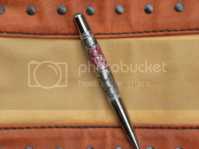

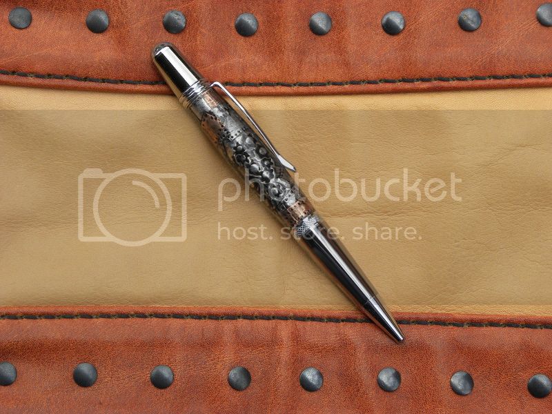

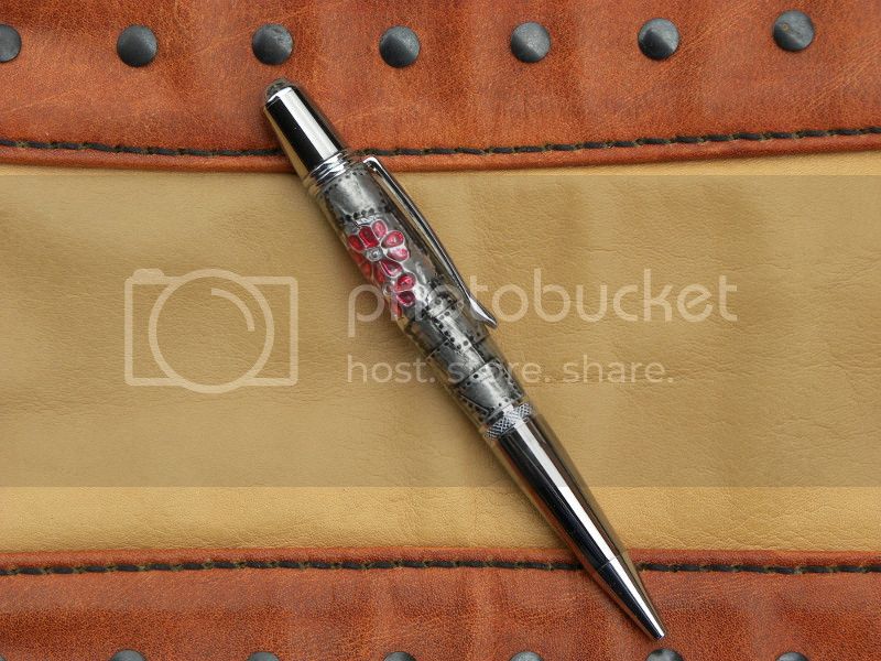

i had a brain storm (yes it did hurt
i got a set of tamper proof screwdriver bits, one lot looked like Gears so i had a play punching them into the aluminum
i then decided that they look a lot like flowers, but not flowery enough, so i turned the shed upside down looking for my leather punches and this is what i came up with
thanks for looking C&C most welcome
MIK
I was playing with a torx screwdriver the other day and they can be rolled at various angles to make different rivet like lines. Harder to control than ponce tools though. The gear flowers from the screwdrivers were as you described. The leather tooled work looks good.

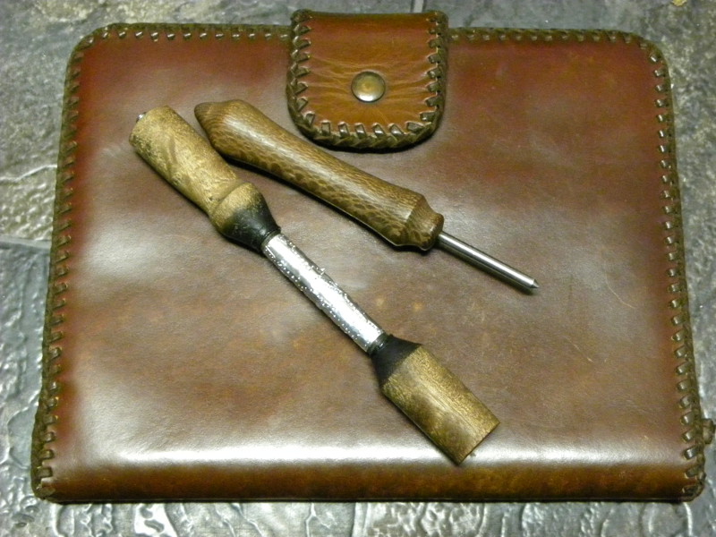

MIK when you put the foil on the tubes how do you keep from pressing (flattening) the rivets. I have been trying a few but seem to press on the tube when applying the foil and I seem to flatten the rivets out. Also I had a hard time finding the copper foil in Canada so had to go to the US to get some.
Lin.
Holidays finished, back at work... bugger
So, is the aluminum wrapped around a brass tube? Is it encased in clear resin?:confused:
hi ya Phillip, yes i cut and wrap the pieces around the tube, the last step is to cast them in clear polyester resin
Sweet. Very nice Mik...
thanks for the feedback Mike
Lin.
hi ya Lin
i put all the pieces on the tubes first. then using the tools i made shown in the picture below i press every single rivet individually by hand, it takes me about an hour to make 1 tube, that doesn't include the casting, that comes next
the copper foil i use is available in the garden section of our hardware stores, its what you put around your pots to stop the snails from getting to your plants, snails wont crawl over copper, it gives them an electric shock
i hope this helps, anymore questions just ask
all the best
MIK
