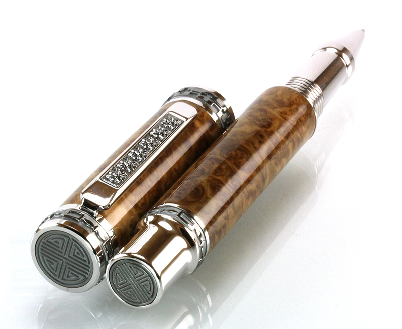

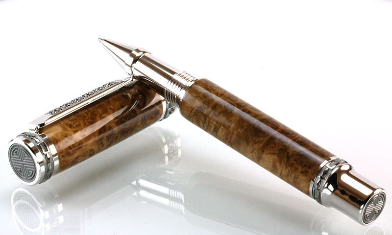

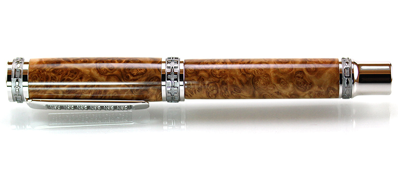

I really like burls. It is hard to say which is my favorite but this corrugated burl is in the top three or so. This is a full sized Emperor from the group purchase (thanks Dale). First time doing a full sized pen like this. The emeropr is one nice pen kit! Any comments are fine. Thanks, Mike

Absolutely beautiful pen and workmanship. And the photos are some of the best I've seen. Wish I could take photos like that. What do you use for a background?
Keith "mrburls"
Thanks. My background is just a semi-gloss white poster board with a piece of glass on top. I use a photo box I made by just cutting places for lights on the sides and top. I using tracing paper as the light diffuser.
Superb blank and terrific overall. I love them both. Do you have any info on the blank?
Thank you. If you are asking where I got the blank from, I don't remember. It came stabilized and was full of eyes as you can see.

Mike you did an awesome job! Beautiful pen and pieces of burl! Job well done! Your welcome!
Beautiful pen. Thanks for sharing. Would you please share your CA technique? I am still attempting to get a consistent finish with CA. I sometimes get a good one and the next one not so good. Keep up the good work.

I can't say all my CA applications are consistent. About 25% of the time I start over because in the sanding and buffing process I took too much CA off and exposed the wood. If I am doing a pen kit that has plenty of meat on the tube (meat between brass tube and outside diameter required for the kit) I turn the barrel below the bushing size and then build it back up with CA. I build the CA above bushing size (or OD required). This gives plenty of room to get the CA sanded down and polished to the required OD. Going several coats beyond the required OD with CA gives plenty of room to fix CA imperfections (pits, bumps, ridges,…)as I work it back down to the needed OD. You will get a ton of different input if you ask people if they use thin or medium CA or both. I just start with thin and then one or two rounds of medium and finish with thin. As a personal preference, thin CA is just easier for me to control how it lays down. I sand up to 600 and then use EEE and then the three step Dr. Kirks polish. My way is one of about 20 other ways…or more!
