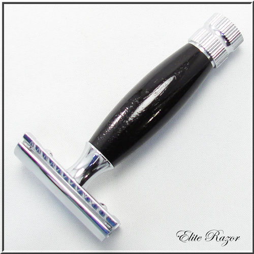

I have used Waterlox with a great deal of success. Below is a razor handle in IBO I did a while ago and the finish turned out great.
