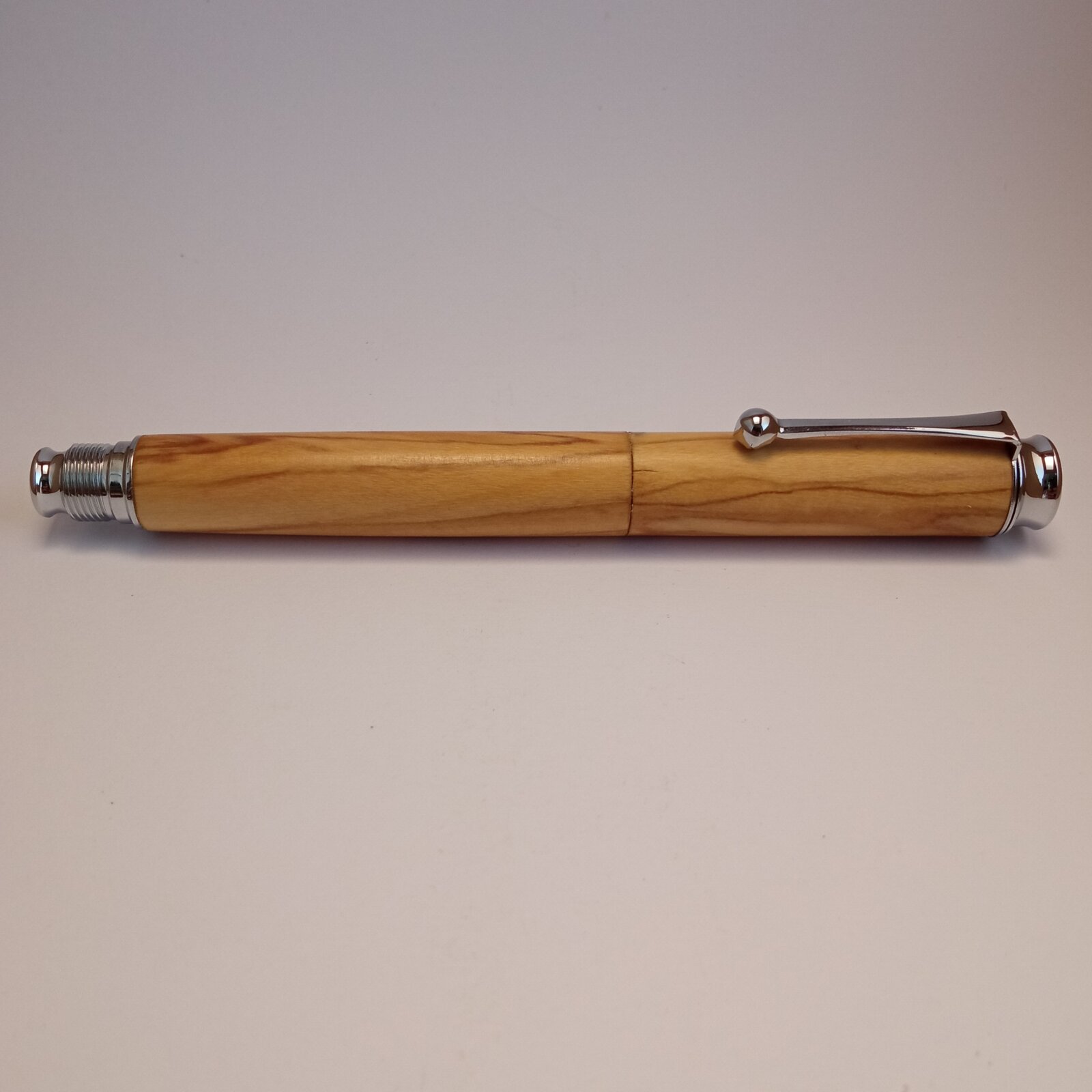

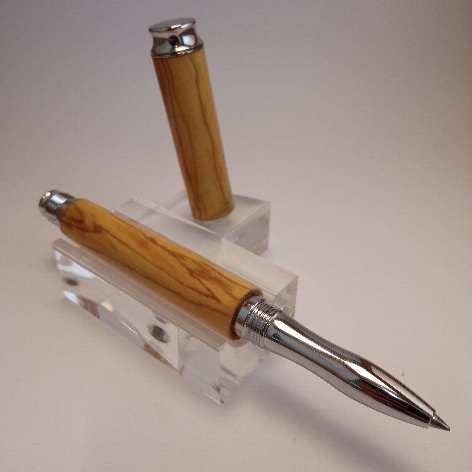

This is my first attempt to make a pen that looks bespoke -ish. I know it sounds childish and immature but i have something greater in mind. Besides showing this i would like to ask your opinion about a good quality pen mandrel. I know that many of you are advocates of turning between centres but i also need a mandrel for other projects. So any feedback is much appreciated, i have to pay serious money to order pretty much anything from uk or the us since i cannot find decent toys eeh tools in greece. Cheers
