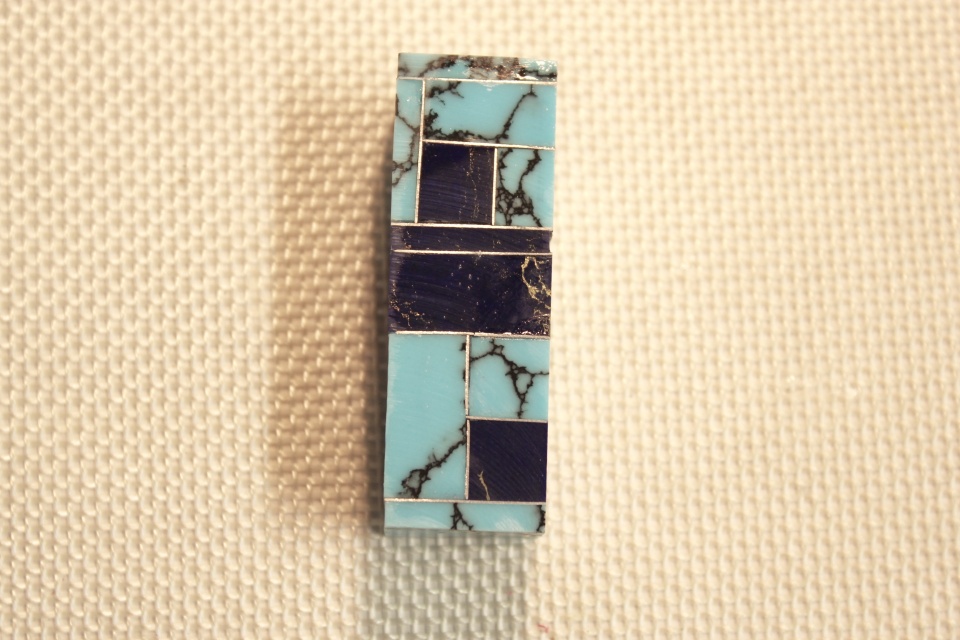

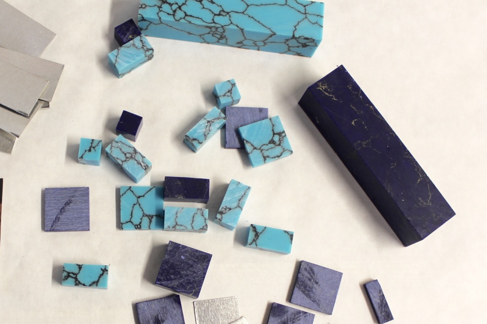

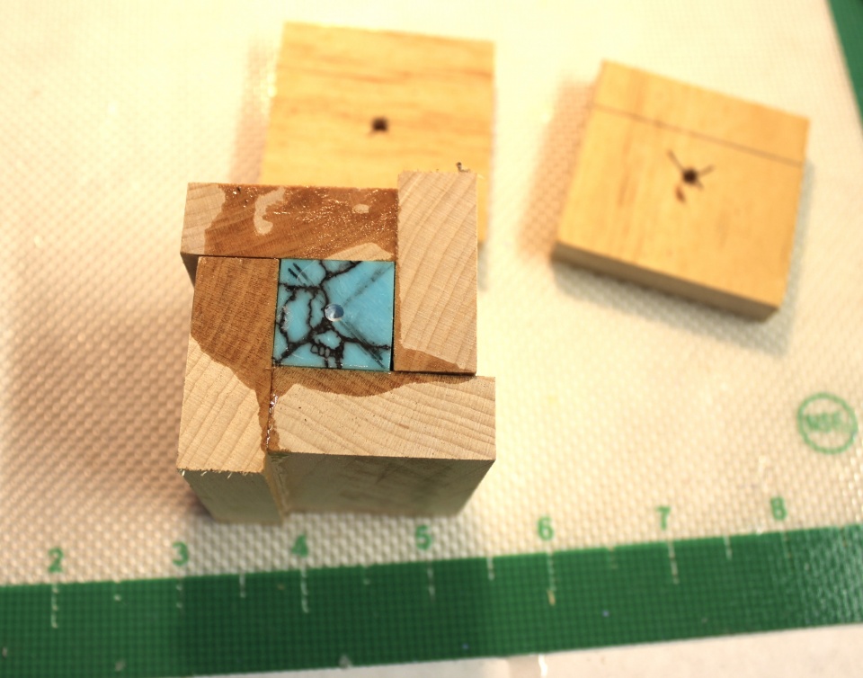

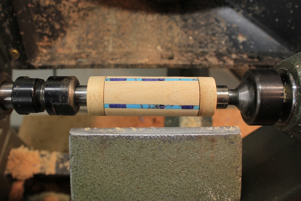

Still in process, and will simply be an adequate first attempt, but AFTER I constructed the blank I got very worried on how to drill. The aluminum that is at a 90 degree angle to the drill bit did not worry me (slow, cutting oil, let the drill cool, etc), but the aluminum that was parallel to the drill bit I was very worried about. Hence this revisited technique displayed by Roy.
My blank is tubed with epoxy, so I'll have a final go at it tomorrow.
