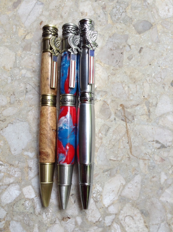

I got lucky and got an order in for the patriots and I really like them. Here are the three that came in the starter set. Buckeye burl, red-white-blue p.r., & aluminum.
Comments good or bad welcomed.
Thanks for looking.
Three Nice Patriots, Mike.
Love the Buck Eye Burl, and the Red White and Blue is a Given,
The Aluminium is Head and Sholders above the rest.
I wasn't aware that Aluminium was an option on the patriot, or did you source it yourself?
Great Fit and Finish.
Congratulations,
Brian.
The aluminum came from some bar I have. It started as a piece 1 1/2" x 1 1/2" x 9' that I have had for years. It cut well on the bandsaws and drilled fairly well. It does get hot quickly. I have a crappy older set of craftsman chisels that I had to sharpen every few minutes, but they made it through ok. The kit it is on is chrome and I thought the aluminum would work and tried it. Aluminum turns fairly well, but it does generate a lot if heat and real sharp shavings. This was all done on a cheap harbor freight mini lathe. :) I didn't feel like digging out the old bigger craftsman.
