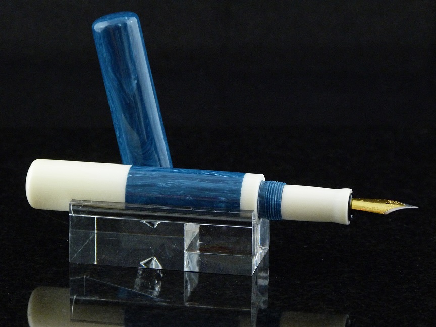

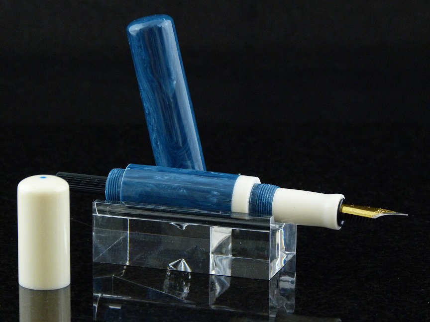

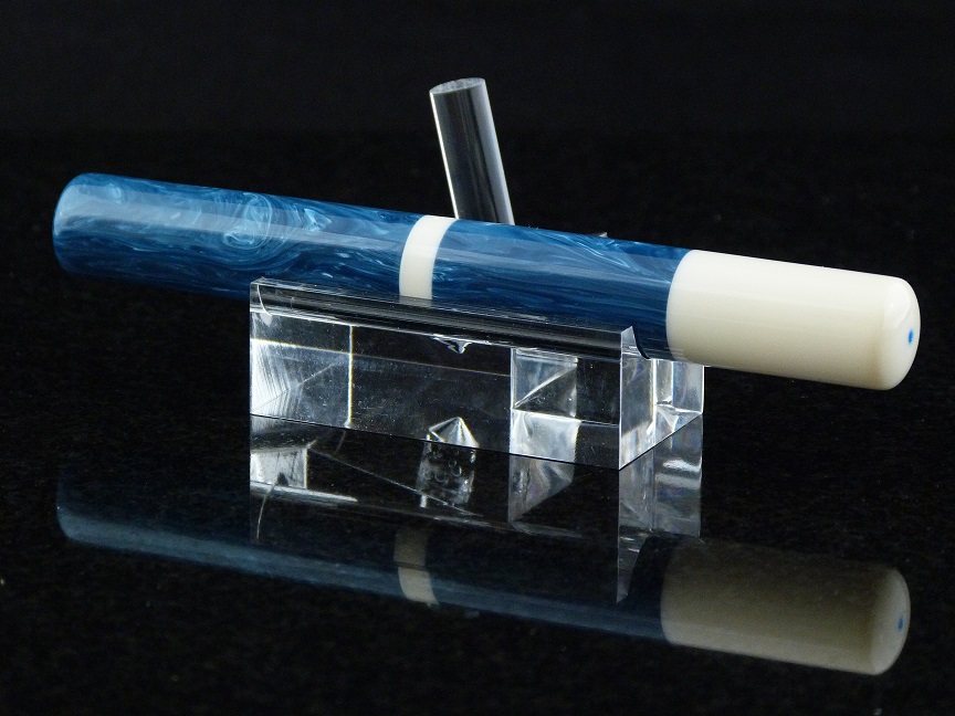

Just finished up another componentless pen. This one isturned from amedeo blue acrylic resin and alternate ivory blanks from Exotics.Nib is a #5 from Meister Nibs. Body/section thread 9 x.75, cap and "fill cap", ifthat's what it's called, is 12 x .75. I did not utilize the theory of "measure twice,cut (drill) once", and ended up drilling through the end of the body. My savewas to thread and create the fill cap, although it did prevent me from turning the body downto a more typical diameter. I think it turned out ok though. This one will bemy daily pen on my desk at work. Not at the point where I feel comfortable tryingto sell a componentless pen yet. But from what I read, most of you who sell kitpens and componentless pens side by side, say customers prefer the kit pensmore. Anyways, Comments welcome. Having alot of enjoyment working my way through the custom pen scene.
