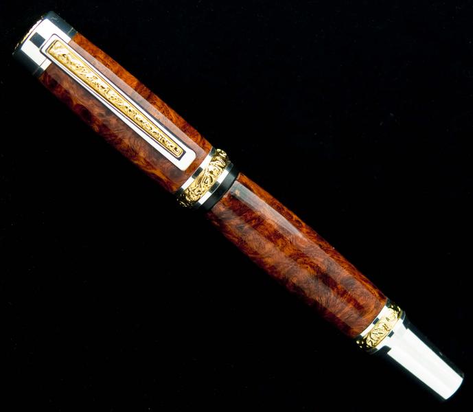

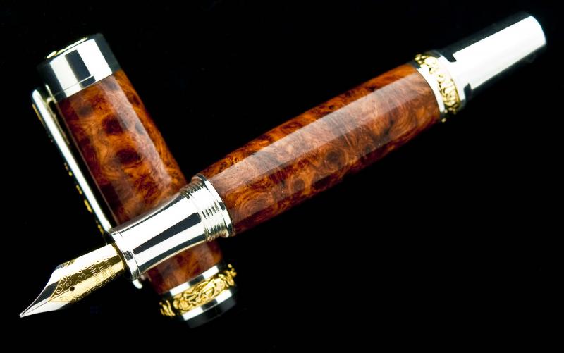

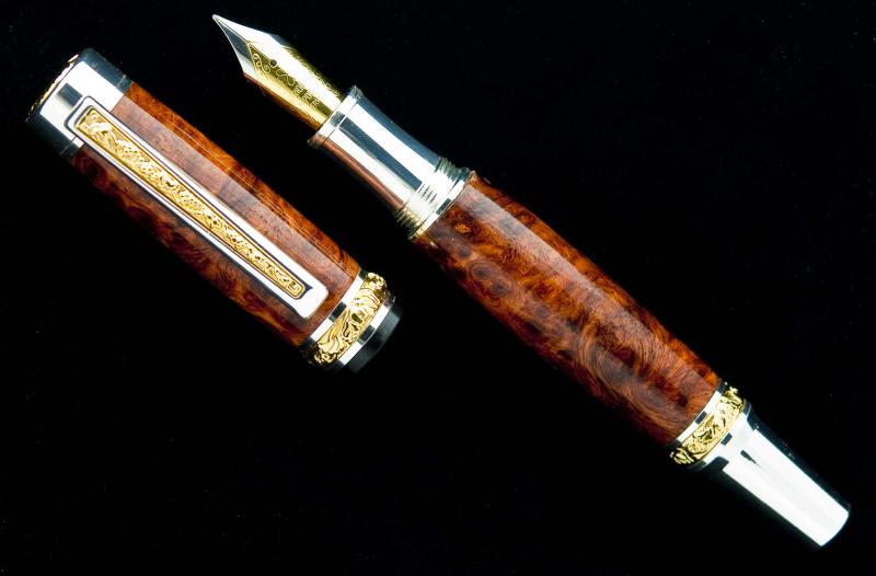

Made it early this A.M. It's Amboyna Burl on a Sterling Silver and Gold Accented Cambridge Fountain Pen. Sanded to 600 grit. Applied 1 coat of thin CA followed by 8 coats of medium CA. Sanded lightly with wet 600 grit followed by MM (wet) from 1200 to 12000 grit. Finished the surface with HUT Plastic Polish. The Amboyna looked nice and tried to bring that out in the pictures:rolleyes:. Comments welcome and thank you for looking! HAPPY HOLIDAYS!!
