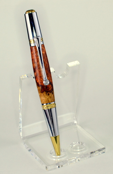

I just completed turning my first Amboyna Burl blank, well half blank as it is going to go on a Majestic Squire. I used Dr. Woodshop's 3 way (Walnut Oil, Shellac, Carnuba Wax) and put three layers on it. It really looks good now but I was wondering if anyone had experiamented with this finish and if there were any recommendations before I went ahead with pressing the parts in place??? I of course have to wait to post a picture.

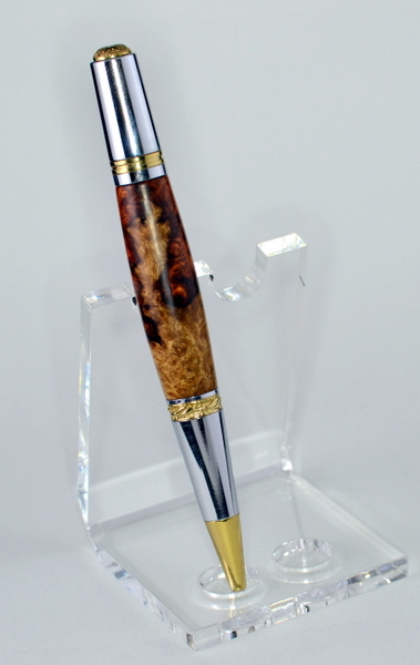

Amboyna Burl Majestic Squire
Well, I finished this pen using Doctor's Woodshop 3 Way, I got a little damp on the walk in from work, the pen was in my shirt pocket under my jacket, but when I ran my hand across it I could definately feel that the grain had risen. I disassembled the pen and went with the BLO/CA finish...it was worth a try to keep it feeling like natural wood, but I'm not sold on that finish as a viable alternative.
