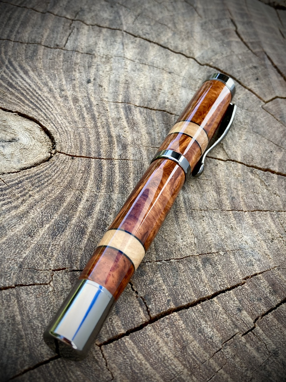

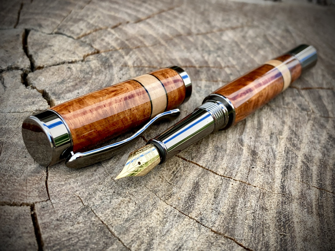

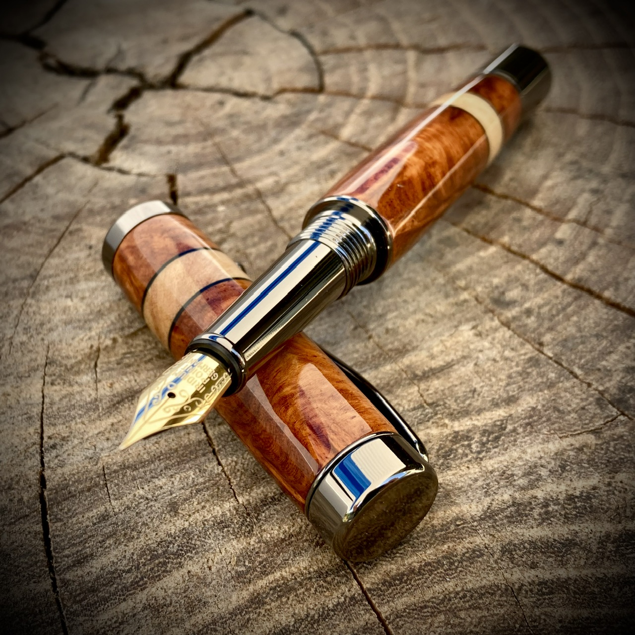

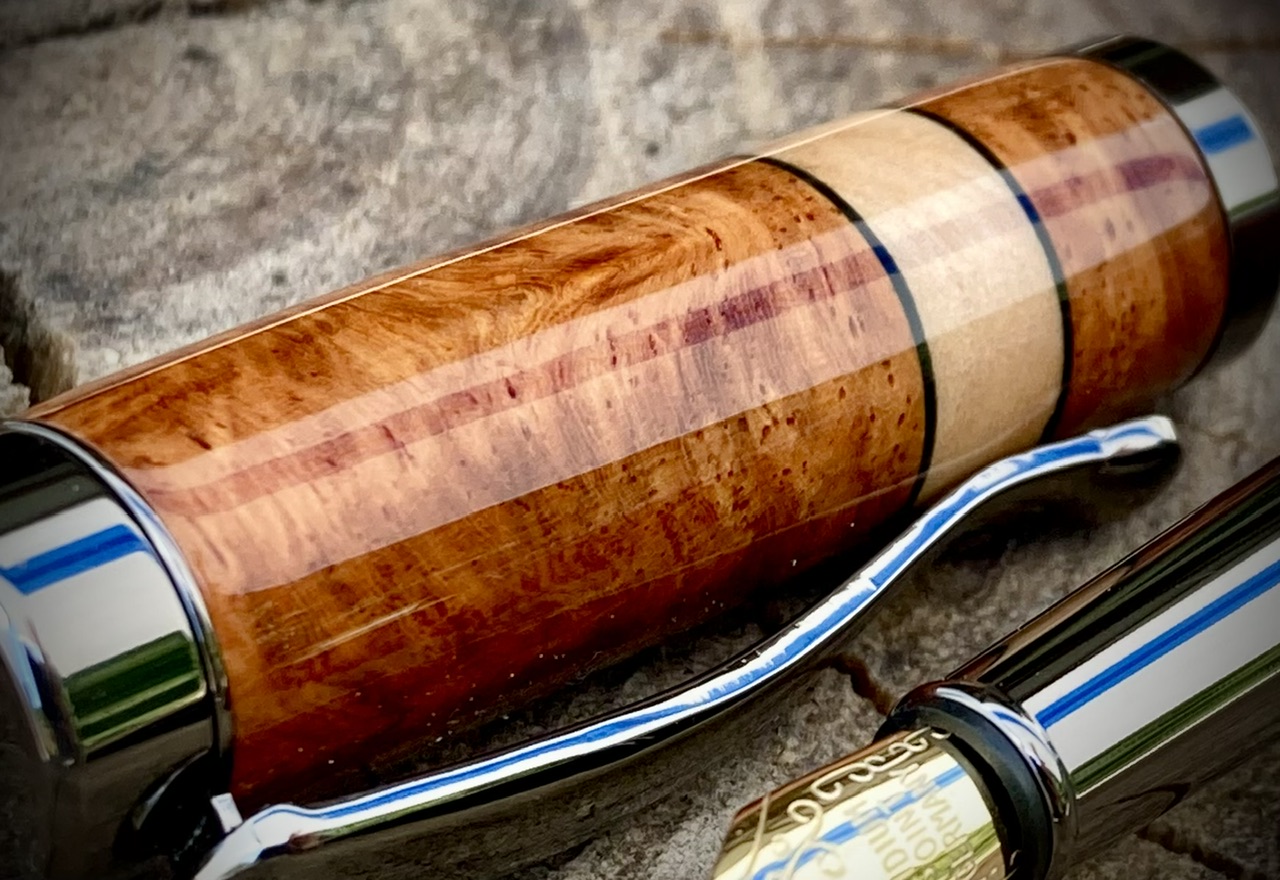

Berea had a 50% off sale and so I stockpiled Atrax kits for $5 and $6. I really like the Atrax design and they are quite nice for a "low-end" kit. I batched out 15 for an upcoming show and then made this one as a gift for a friend.
The woods are Amboyna and Olive wood. I used black celluloid guitar picks for the spacers. The recipient has a band, so there's the hook. I'm not in love with these two woods together. It's hard for anything to hold interest next to Amboyna.
If I did it again (and I might), I'd just put Amboyna in between the spacers and just have black lines on a solid blank.
Thanks for looking. Critiques welcomed.

Todd, that's lovely.
As a long time guitar player, I wouldn't have thought of using picks as spacers. I had a couple hundred in a bag. Not sure where they are now.

Beautiful!! Well done! Finish is GluBoost, I assume?
I agree, Amboyna goes well with just about everything. Amazing wood.
Personally I think of the Atrax as at least a midrange kit. At $5-6 its certainly low-end pricing, but the kit is very nice, IMO.

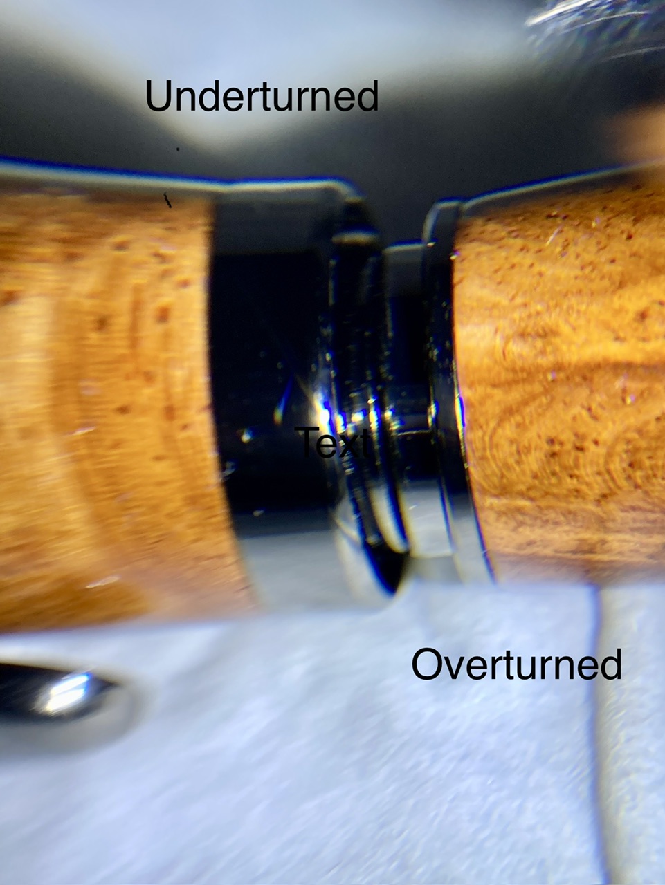

Only critique I can offer, based on what I see, is the critique I make of myself on just about every pen: It looks like there is some slight non-concentricity or other misalignment with some of the fittings. I understand the challenge of working that out, not easy. Its one of those things I'm constantly working on. Yours is slight, but might be the only area for improvement, based on what I can see! :)
What a finish. And on-point photography too
Thanks Jon. To my eye and touch it looked good, but I see what you see in the photos. I got out the loop to take a closer look. I'm definitely not perfect in my fit on this pen. Some overs and unders both. But I don't see any OOR to speak of. The fit seemed equal the whole way around.
That's gorgeous! I think the olive works great on that one also. A darker contrasting wood would also work, but not as much with the black spacers.
Yeah, this is what I saw. I don't actually get OOR really, I get non-concentricity (where its very slightly overturned one side, underturned on another, for the same blank). It is actually "round"...its just not concentric with the centerline of the fittings.
I sometimes get a bit of general over or underturning as well. I think now that I'm using GluBoost, overturning is something I'll be able to fix. So the main issue I have is the non-concentricity, and figuring out why the heck its happening.
