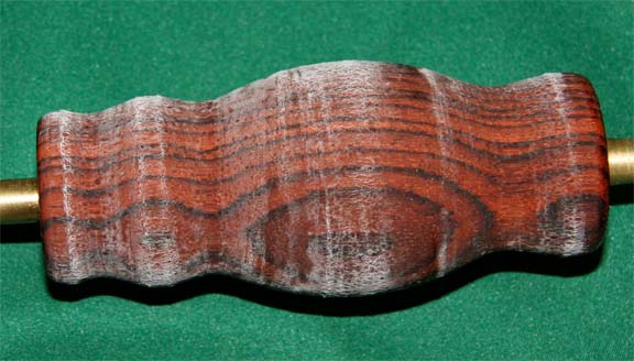

As to Temp and Humidity, Humidity does play a huge role where it is present. My experience in living along coastal Japan and now in North West Mississippi (near Memphis, TN) high humidity around and above 80° produces less fogging for me than the equivalent humidity at 50° - 70°. I don't finish pens below 60°. One thing that I noticed about cooler temps was that in the curing with high humidity, it seems to draws more moisture out of the air, similar to cold glass on a table sweating. I haven't seen that at 80° and above. The colder temps with humidity makes a mess of cloudiness. After learning this, I turned on a heater and heated the room up for a while before finishing.
Back to Nebens original question: "fact-based or experience-based guidelines"
. . . That (fact based) would be good to have. All we have is experienced users and in my years here, I have noticed a wide variance of results - due to dry regions vs higher humidity regions, with temp changes altering it some.

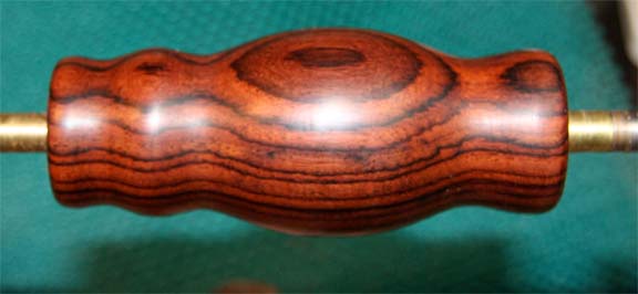

The two pictures below were done about 9 or 10 years ago (Toyota City/Nagoya area) and I did them in winter with about 55° - 60° in my shed, I let it cure overnight and the next morning it was white. It dropped down into the lower 40's overnight. It did not turn cloudy on the inside. It did have a thick coat of CA on it. Oh, and the bottom one was not polished at that point, only sanded with about 2400 MM to get the "frost" off. Of course that was not REAL frost, but something that happened in the curing process in cold humid weather.
