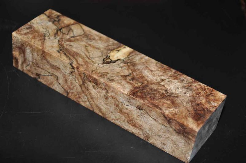

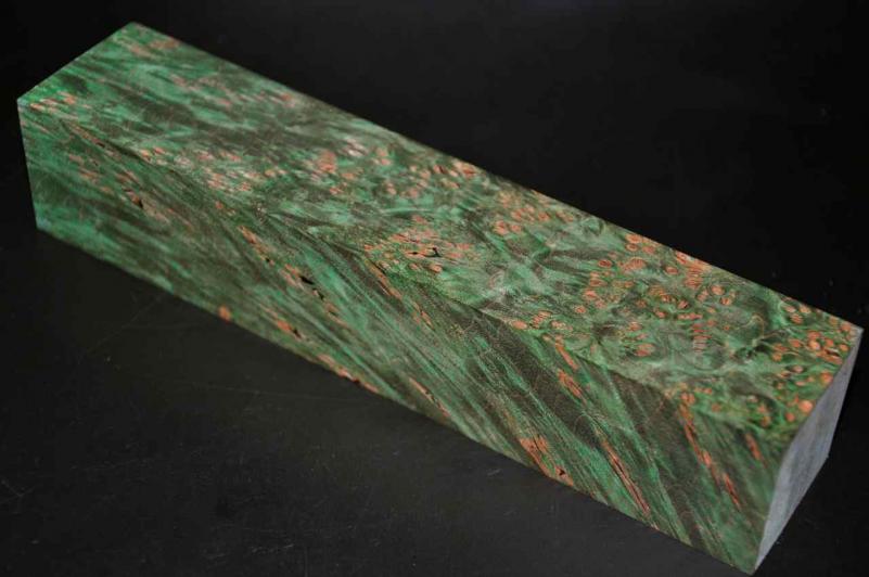

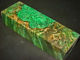

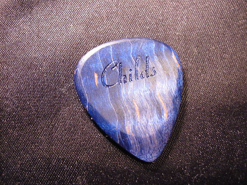

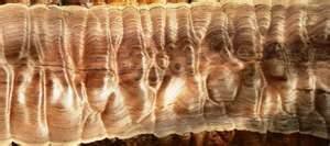

Thanks Rubicon, I think I've attached some images. Still getting familiar with this great site.
Er, Sorry I meant Robutacion
I believe those are all acrylic stabilized Maple.

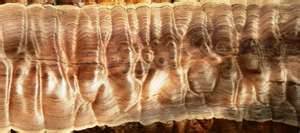

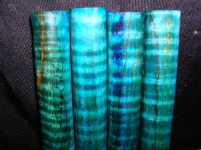

Here's Some More
OK, right now I know what you are talking about...!
Well, lets simplify things a little by giving you a short description of what you have shown us in those pics.
*- Wood when, properly stabilized (impregnated with hardening resin) becomes "plasticized" as the wood cells had its water/moisture replaced with a liquid plastic/acrylic, this is why you can produce shavings when cutting/turning it but, fine powder...!
*- Stabilizer solution can be used as is, (clear/light yelowish) or with proper dyes, they can be used repeated times (called double or triple dying) in the wood, using various methods to achieve it however, is the wood type and grain that will determine the final results. In your pics, you have the common BYB with single and double dyes and also some variation of curly and fiddleback grain woods that, on they own, produce half of the effect.
So, in resume, not all woods can be stabilized, not all woods are soft enough to allow resin and colours penetration, and not all woods produce the same result...!
*- Finally, we have the combination of wood that is stabilized (clear or with colour) and also cast with resin (1 of 2 types) to fill areas missing of that piece of wood, that can be done to mach any colour used on the stabilization resin, that is the case on one of your green samples (pic) or with a totally different colour, that is the case on one of your green samples (pic).
