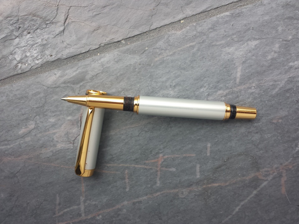

Here is a baron style I did a while back can anodize haven't done much dying but would give it a shot.
Randy
