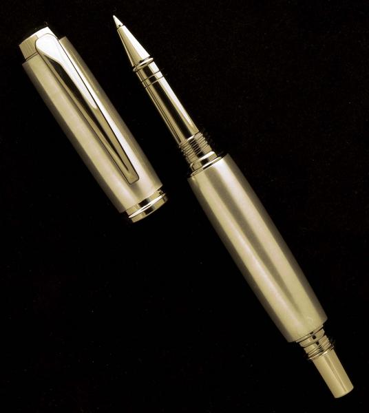

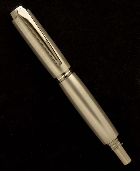

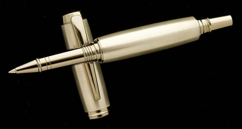

Started this last night and finished today. It's one of John Goodin's aluminum blanks on a Black Titanium Jr. Gentleman brought to a satin finish. Turned with carbide tools, sanded to 600 grit, MM (wet) from 1200 to 12000 grit, and then brought to a mirror finish with Brasso Polish. To get a satin finish, I air etched the pen on the lathe at slow speed with a Paasche Air Eraser using AE-X cutting compound at 50 lb/sq in. I had previously made an aluminum Navigator pen that I left as a "shiny thingy". :rolleyes:
Hope everyone has a great weekend. As always, thank you for taking the time to look. Doc:)

Must be my monitor but I can't tell what color that aluminum is. Looks like a tan. Not a big fan of the black background people are using these days. Washes out the pen too much in my opinion. I too think satin is the way to go. thanks for showing.
The aluminum was a mirror finish prior to air etching. Once it had been air etched, the surface has a frosted appearance that may be diffusing some of the light from the lamp of the light box. Don't know:confused:. I don't see it as tan on my monitor. Does anyone else see it as tan? Doc

Maybe, if I had not read the story before I clicked the photo I could see the slight tan. Could be a function of light color as a shiny metal would take the color of the light.
If you go too high of a temperature, it will be cold blue. Should you own a an 18% gray card with accurate color rendition, you can shoot one photo with that in the image, and then use those values in photoshop or gimp to adjust the color balance.
However, this is a stunning pen and good photography, so I wouldn't fret about it one littl bit!
