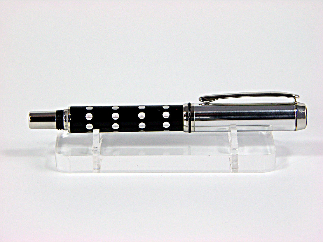

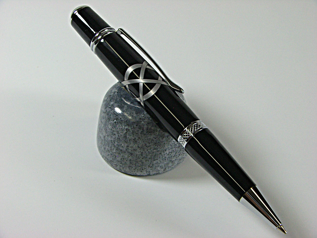

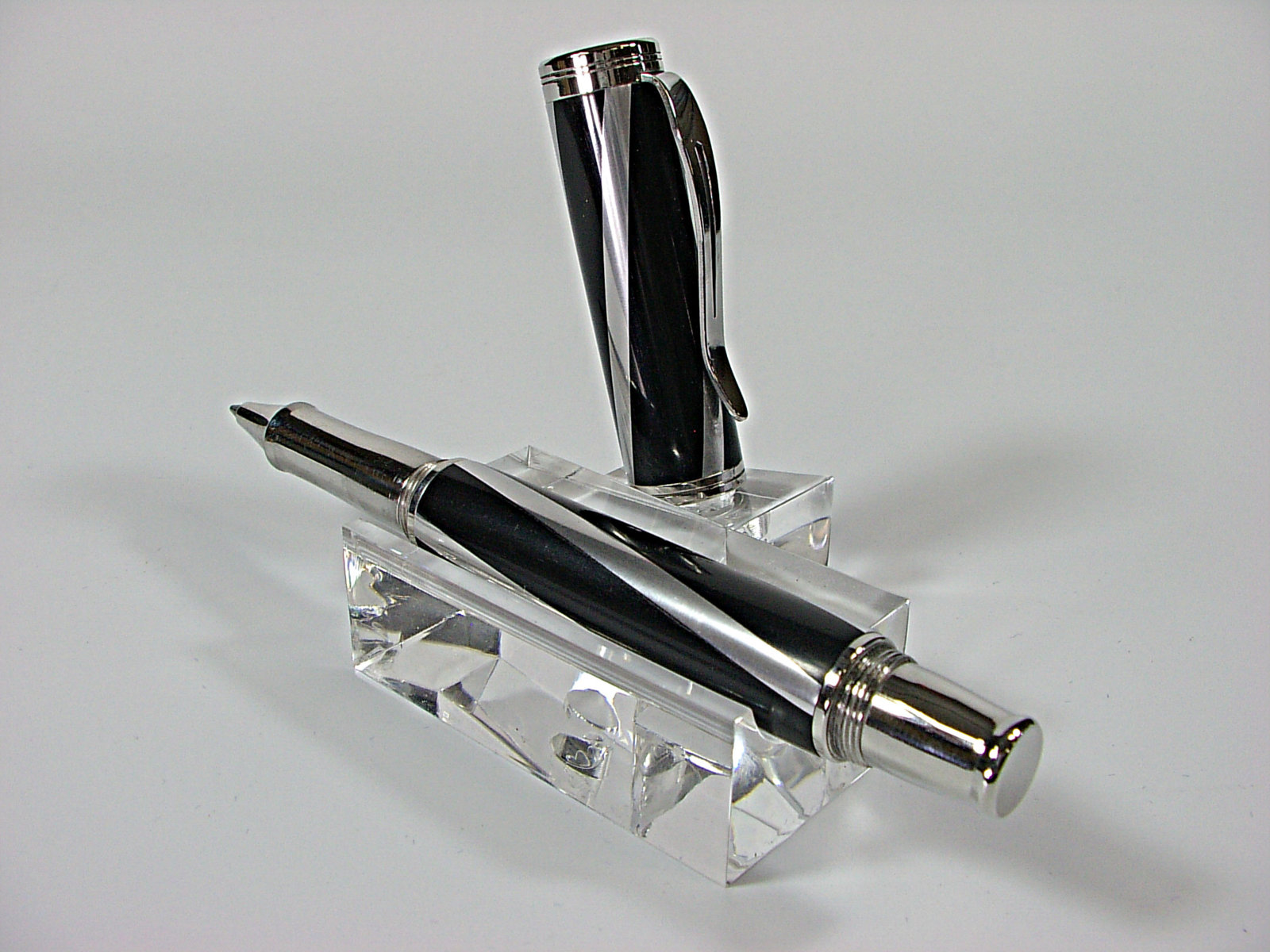

Well the answers you got are correct in that aluminum is a nonferrous material and is softer than the tools we throw at them weather it is HSS or carbide. I try to use 6061 grade aluminum when I am doing larger projects other than pens or if I am making a pen solid from an aluminum bar. But for thinner inserts and dots I use whatever i can get from hobby stores and even Home Depot and never had a problem. I use System3 T88 epoxy glue all the time to glue the inserts in. I use a round carbide cutter to take down to shape and then finish off like I always do with my skew. Has worked well for me over the years. In fact I have a series of black and aluminum pens I have been making over the years that has inlays and dots in them. In fact I am working on another right now to add to that series. Need to figure a couple things out yet on that one but getting close. Here are some of the ones I did and never had a blow out of any when spinning or finishing.
