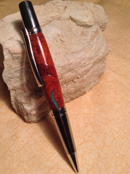

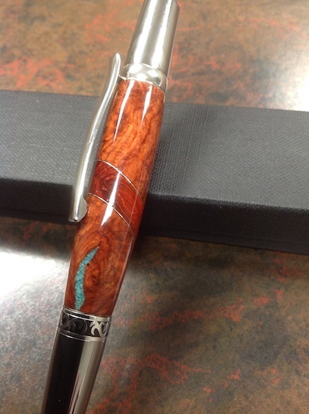

Welcome to IAP! I have done quite a few aluminum segmented pens (50+) and you do need to take it slow. Every joint must be given plenty of curing time and drilling too fast can cause the glue to loosen the joint. Be prepared to use very sharp tools when turning. Though the aluminum in relatively soft - it can still dull your tools (even carbide) faster than normal.
I must admit - the aluminum/copper accents do help set the pen off and my customers all are asking for that added "wow".
Good luck!
